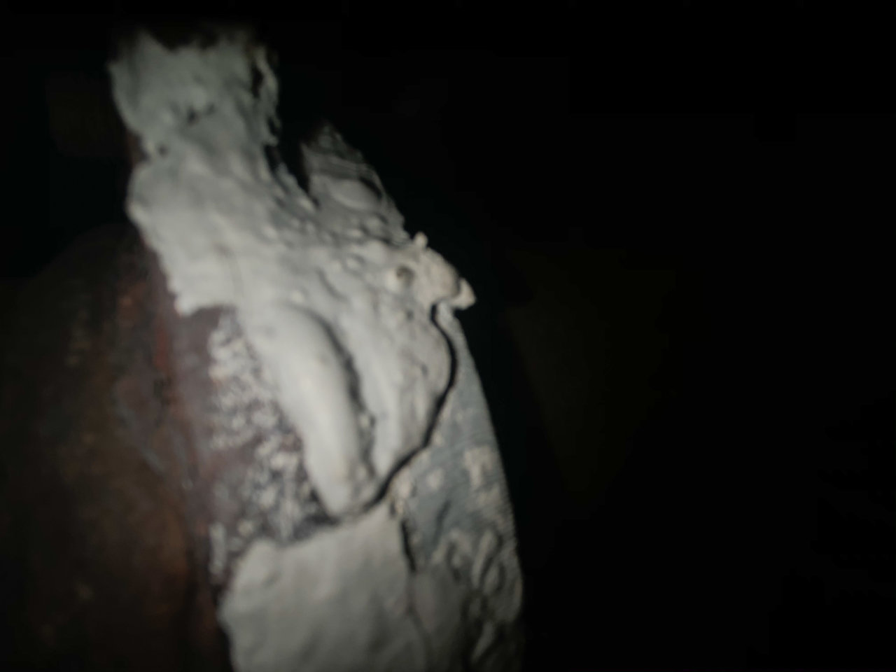

    Well it looks like the check engine light is gone but I did find a slight leak again. Fuck sakes, going to try and seal it up with Permatex Copper gasket maker.
    should I remove it or do you think I’ll be ok just where the leak is, its facing me anyways. was going to put a good coats.

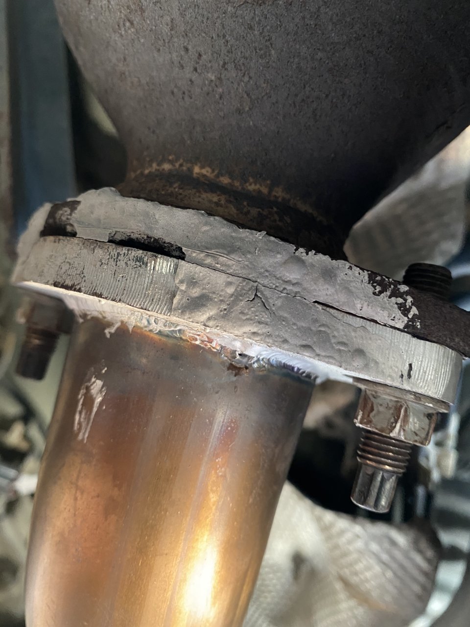

    Looks like a patch job from the shop and this was after I brought it a 2nd time with new OEM gaskets.

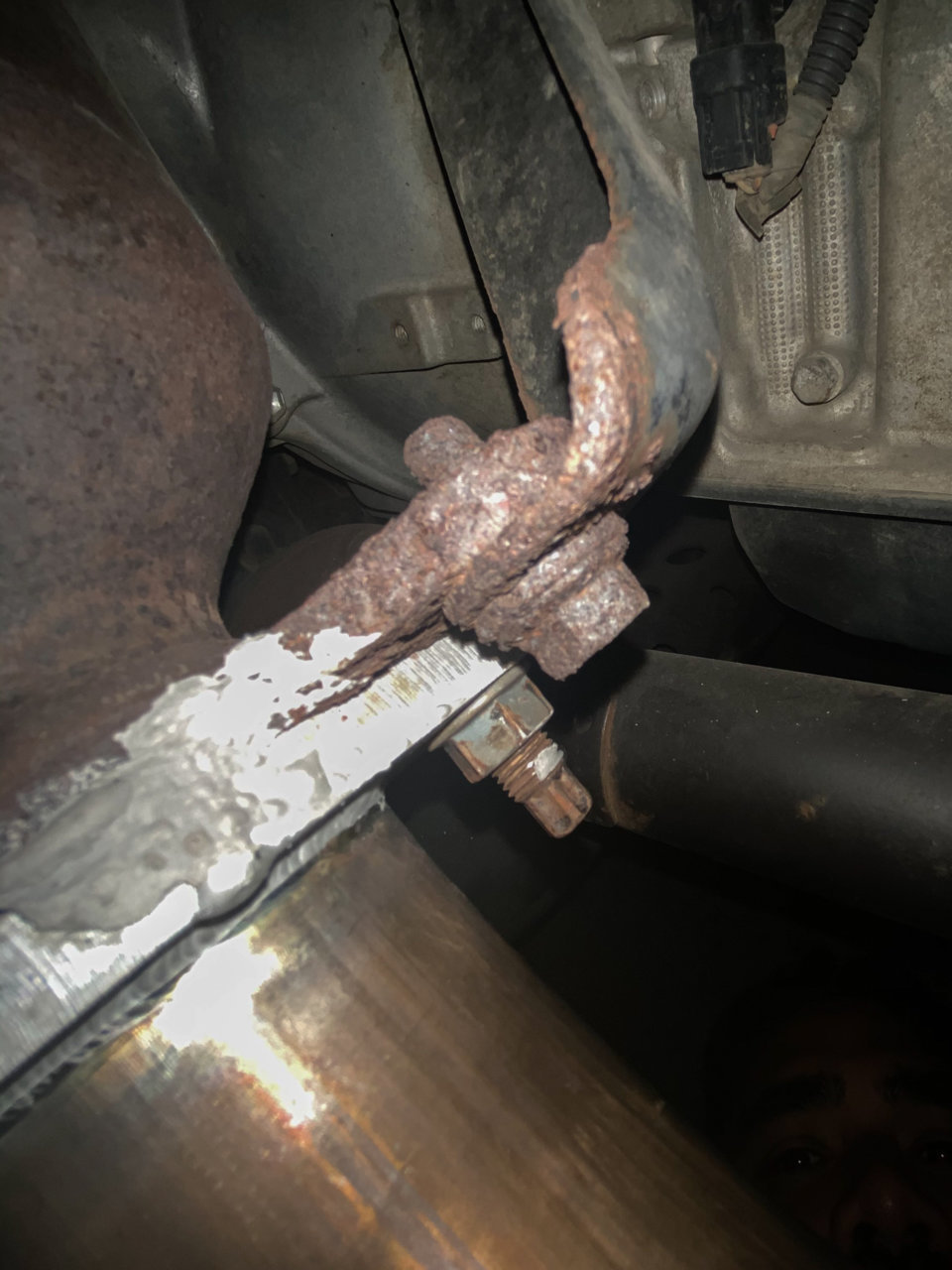

    Good news, just drove into work and so far so good! I’m impressed with the copper gasket/sealer.
    Tried to get a good pic of the other side of their work.

    Excellent news man!
    Yeah, I’m not so sure about the all the excess sealer they used.
    Someone was thinking “more is better”.
    I would have at least wiped the flange off clean at the seams.
    Oh well, at least you got it fixed.
