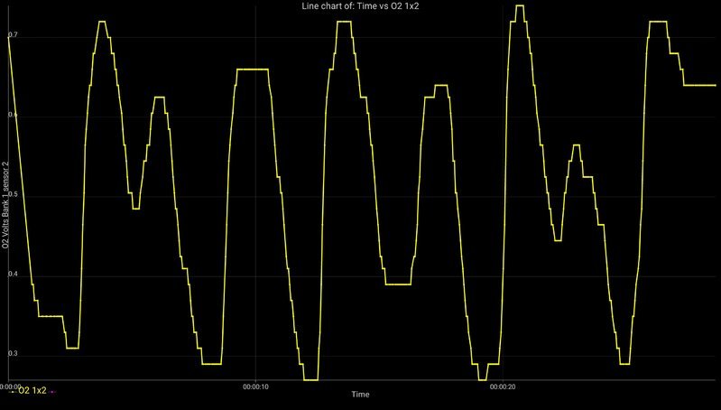

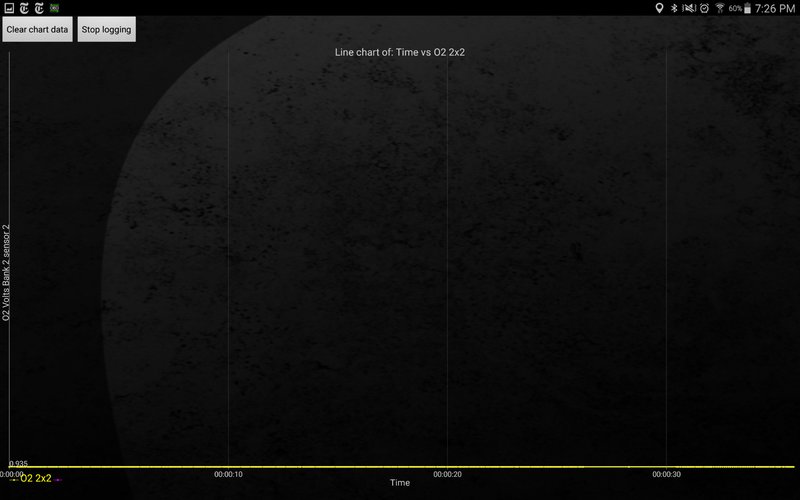

    Hello,
    I have a 2005 toyota tacoma 6 cylinder 4x4 that I just recently purchased off a private party. I am getting a P0158 code as well! I just replaced both downstream o2 sensors, ignition coils, and spark plugs (used all denso oem parts). I checked the resistance across the o2 sensors and they read around 16 ohms at 90 degrees Fahrenheit(means they're good). I logged both downstream o2 sensors and found out that sensor corresponding to bank one would have a voltage that varies. o2 sensor correspding to bank 2 holds at a constant voltage (around .9 volts)I will post pictures to show this. Does anyone know where else I should go from here as far as diagnosing goes?

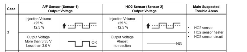

    This should help diagnose your P0158
    • 158.pdf
      File size:
      194 KB
      Views:
      117

    #194202
    16
    Hey everybody
    Just did the continuity check on the wires corresponding to e5-5 and e5-33. I plugged in the multi-meter probes into 1 of each of those aforementioned tester connections (specified on page 804 in the pdf I sent you and ) and connected to the corresponding wire that connects to the o2 sensor(bank2 sensor 2 post catalytic converter) and got a ring. So now I know the following:
    Good o2 sensor(bank2 sensor 2)
    Good wire from the ecu to the o2 sensor(there is no break in between)
    Brand new long block so good head gasket
    What would you do for further diagnosing?
    Regards,
    Tom Bernard
