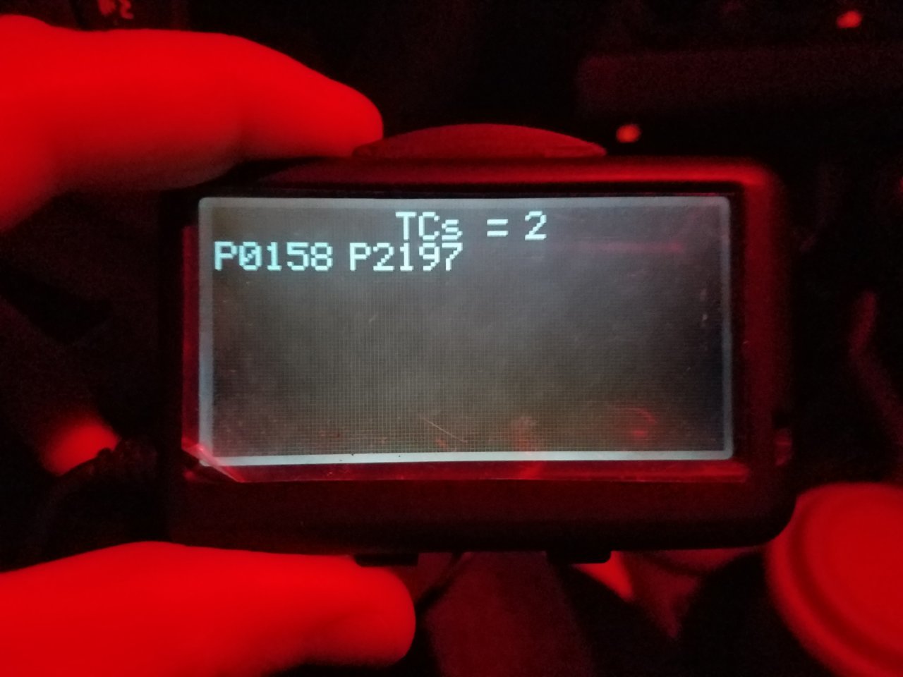

    The other day my CEL and traction light came on on my way to work. I used the scangauge and got the two codes above. A little googling returned a few worthy threads but nothing definitive. Some mention gas caps, others A/F sensors. This a thread to document my troubleshooting of the issue, maybe it'll help someone in the future.

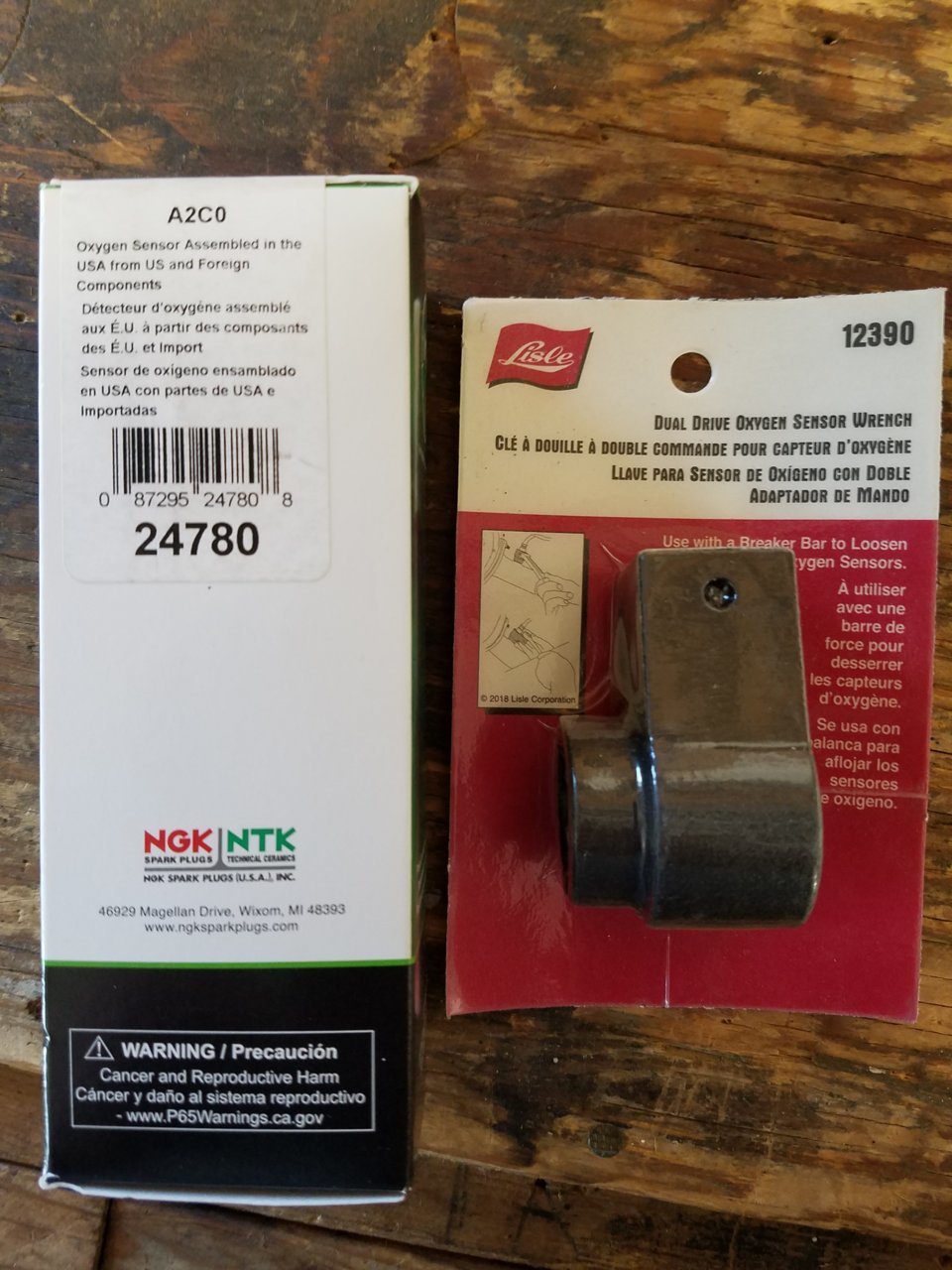

    So code P0158 was cleared by replacing the bank 2 downstream o2 sensor.
    I think I just cleared to P2197 code by replacing the upstream o2 sensor.
    Finished up and then drove it around for about 30 minutes and the CEL didn't come back on. Usually mine resets in like 15 minutes of driving so my fingers are crossed. Tomorrow I'm going to run to the smog place and see if it'll pass.
    Part numbers:
    Downstream - NTK 24780
    Upstream - NTK 24661
    I'll post up again when I have confirmation I passed smog.
