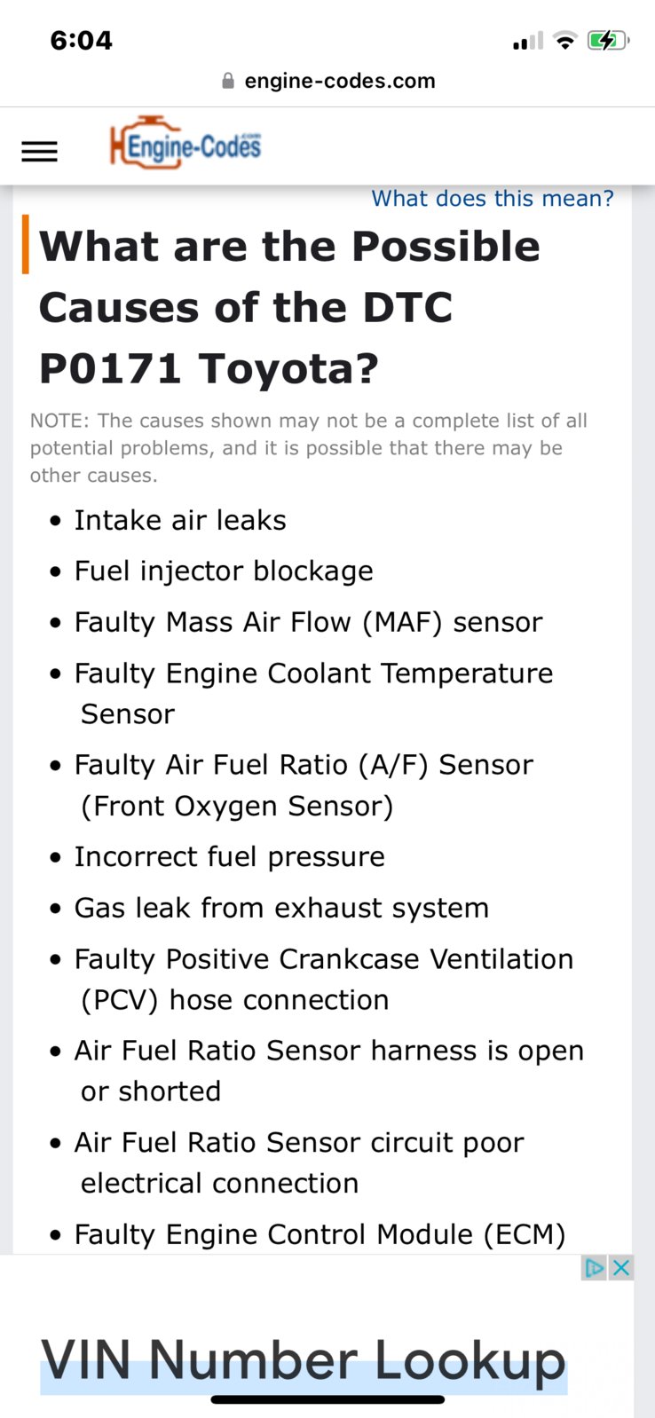

    YO
    Welcome!
    im not that ‘OEM only person’
    But
    After listening/reading here, I’m beginning to adjust my mindset
    tht P0171…..I threw same…..after installing eBay injectors…..I was 90% sure that all other possible causes were not the issue.
    Sent my old leaking OE injectors to Motorwest, installed….i was free and clear
    That’s me
    But

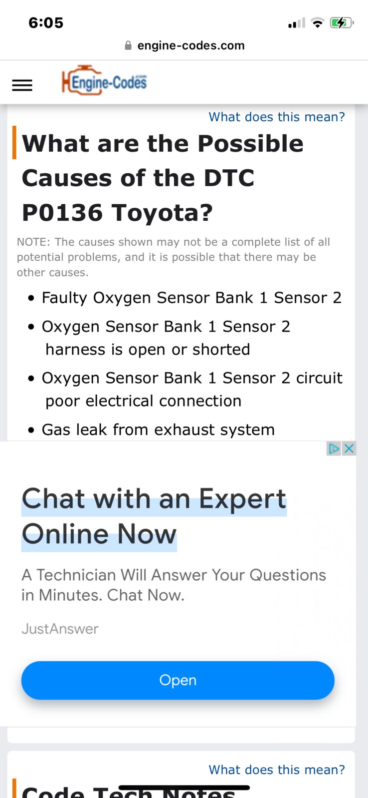

    That P0136 points in another direction
    What O2 sensor did u install?

    Me too as far as O2 sensor
    the only other cause on both codes is exhaust leak (fuel?)
    Another seasoned member advised me too look at header for cracks with heat shield removed

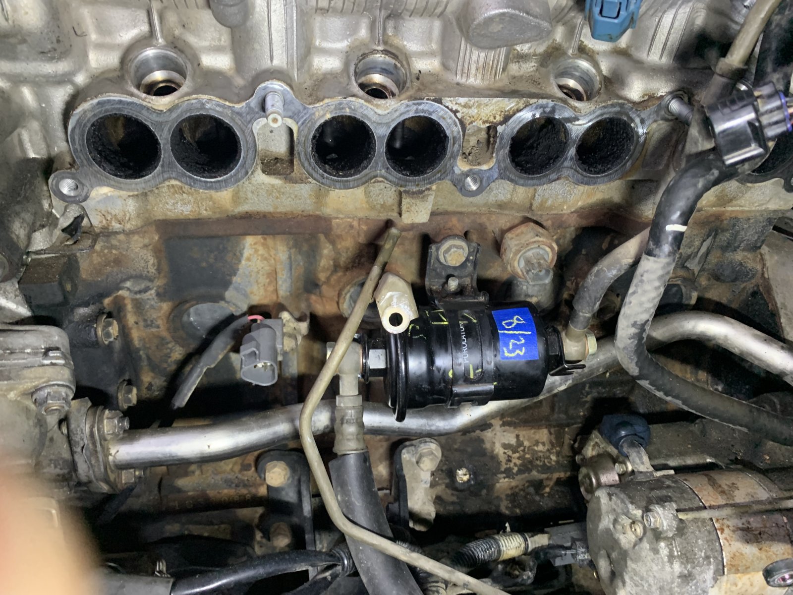

    Where is the fuel filter located?
    Thanks all, will keep posting.

    Ugh
    It’s a PITA
    Under intake manifold
    I RR’d FF b4 this pix taken
    My hands were swollen from various things gaining access
