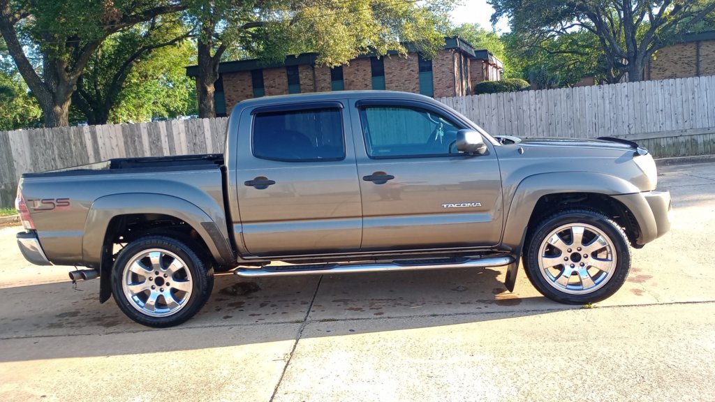

    I just got a 2nd Gen Tacoma from my dad. It's family owned. It's a 2010 PreRunner Automatic Transmission 4.0L V6. My pawpaw bought it brand new. He had never had a automatic truck before, so he was towing coon skin and fur for his fur company and was in the wrong gear, my father got it after he passed and noticed it doesn't want to get out of third gear automatically and it starts reving if u try to go faster but it doesn't, so u have to manually put it in 4th gear to get it to shift after third gear. Which is weird because this is a automatic. However, just sometimes when I'm driving it'll shift normally, but most of the time it doesn't. Check engine light is always on after getting new battery, maf sensor, there is no vacuum leaks, nor any damage to the fuel pump or system. But I was told by a mechanic, if the transmission is having problems it can trigger O2 Sensors and make the ECU run lean or rich, in this case Im not sure. Bc everyone else says the P0171 and P0174 is for fuel and airflow problems, but there's not lol, sorry for the essay but I just want opinions before I get this trans rebuilt lol
    But it's been driven like this since 2014 from what I'm aware of. She still drives she's beautiful Point A to Point B. My first vehicle, don't have to be perfect but that is literally only problem lol
    And here is what it looks like
    Oh and those are 20" Toyota OEM wheels lol. Which I couldn't believe at first

    wheels actually look nice...

    Thank you sir appreciate it yet. Got them polished 100miles ago.
    I can't believe it fits 265 50 r20 on a stock suspension but it was already factory lifted a few inches
