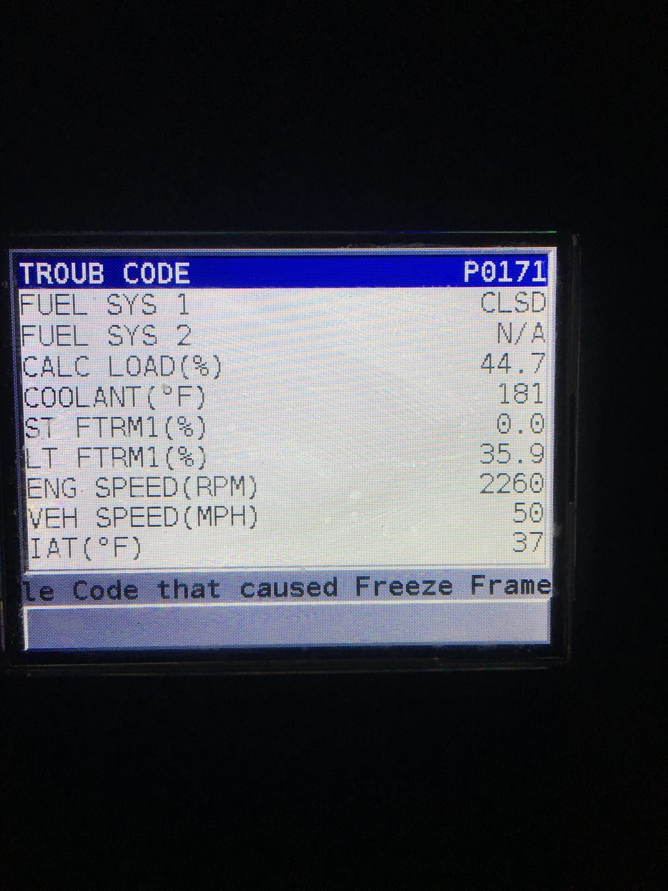

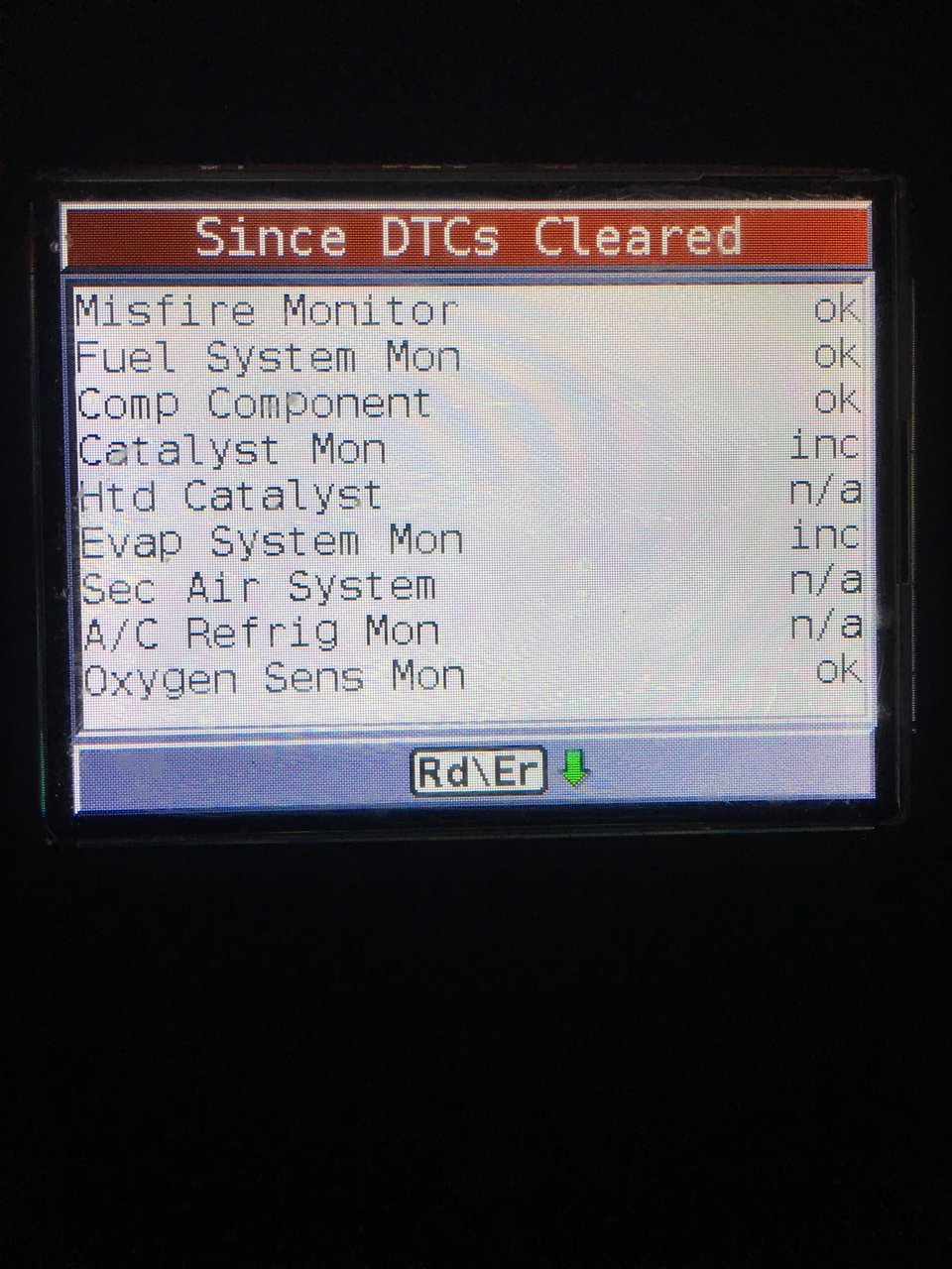

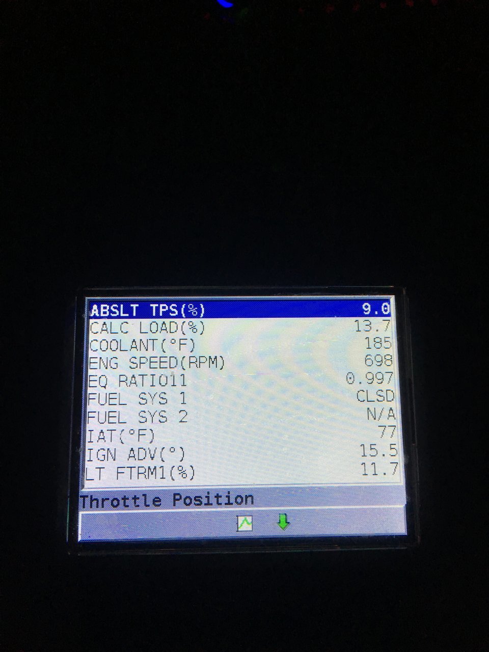

    Hi everyone. Hope I won’t get barked at for highjacking this thread. I’m haveing the same issue.
    02 Tacoma dc 4x4 3.4l k@n intake and flow master exhaust
    Here is some info from my ob2 tester. Let me know your thoughts on What it might be.
    Checked hoses for leaks-non
    Pulled both o2 sensors from pipe and cleaned them.
    Cleaned maf as well EF0C76DC-93EF-4D66-A6E7-4E9709618E7D.jpgA12CF9FF-0444-43C0-B488-8AE51FB554DF.jpg DD12B7C9-7C15-4672-AB3D-1B55BF4E32B7.jpg
  18. Dec 18, 2017 at 6:14 PM
    #18
    BartMaster1234
    Aug 21, 2016
    #195197
    45,851
    Tyler
    Pittsburgh, Pennsylvania
    Flux Capacitor
    Figured my long lasting P0171 code out. It was easier than I thought, my MAF sensor was oily from my K&N filter.
    Shot it with MAF cleaner and never got the code again.
