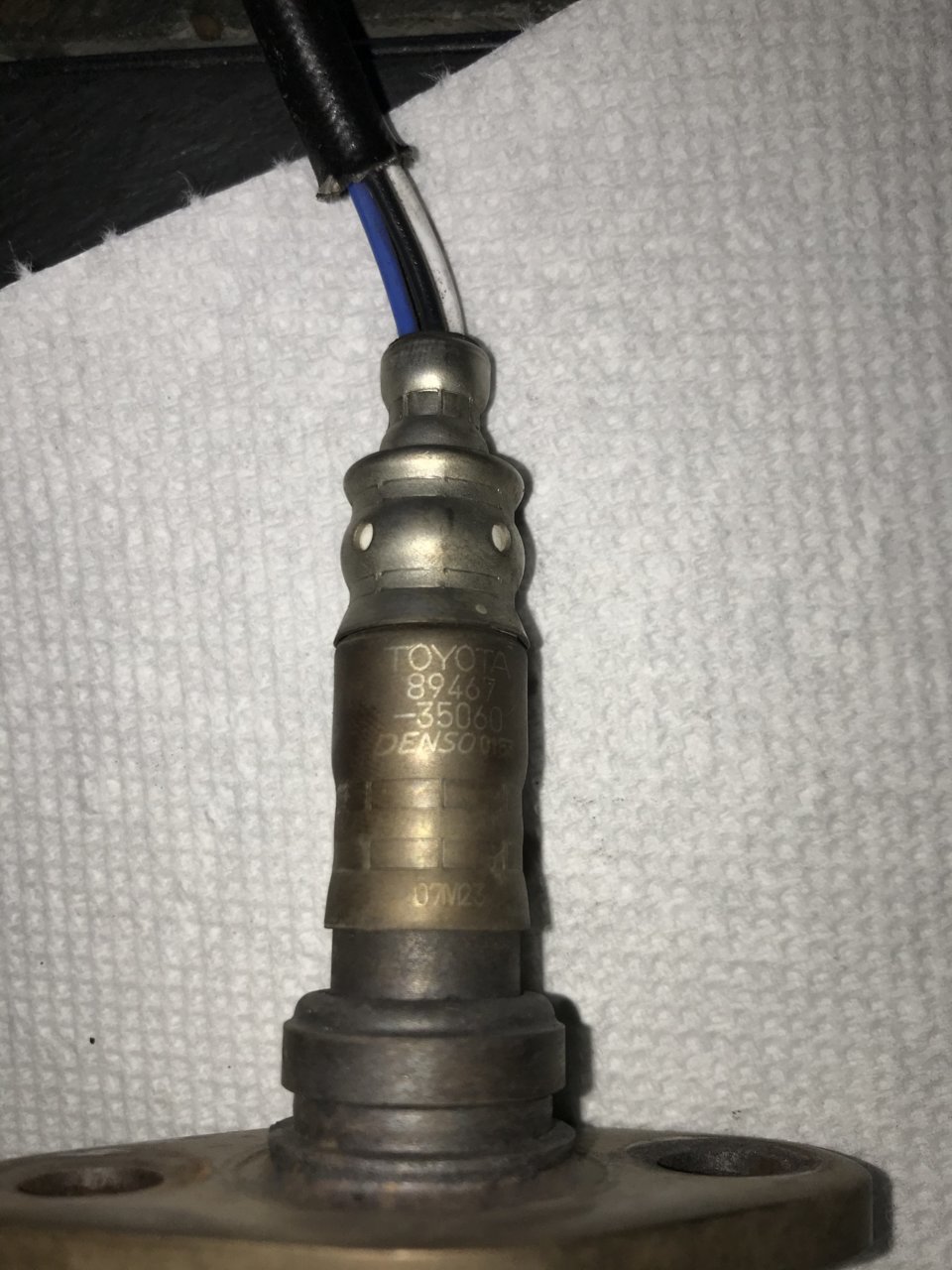

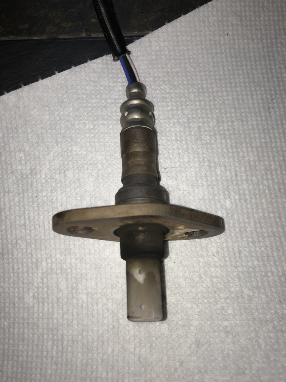

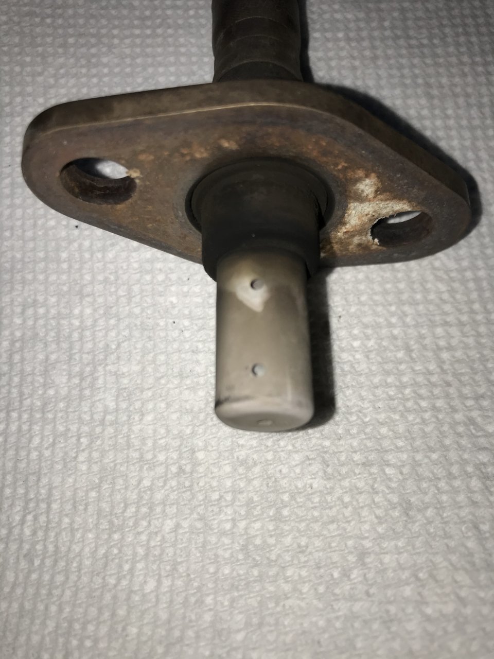

    So today I tested the af sensor again. Here’s some pictures. Looks like it’s orignal. It read at 2 ohms this time @Timmah!

    My maf had a resistance of 1.35k ohms today. I let it cool off for about 2 hours.

    From the ohms resistance you got on the A/F sensor and the MAF sensor, they are both outside the spec. For the A/F sensor, you should have seen a value between .8 to 1.4 ohms and you got a value of 2 which is outside the spec. For the MAF sensor, the range is 2.2k to 2.7k and you got a value of 1.35k which is also outside the spec. You probably should replace both of them.
