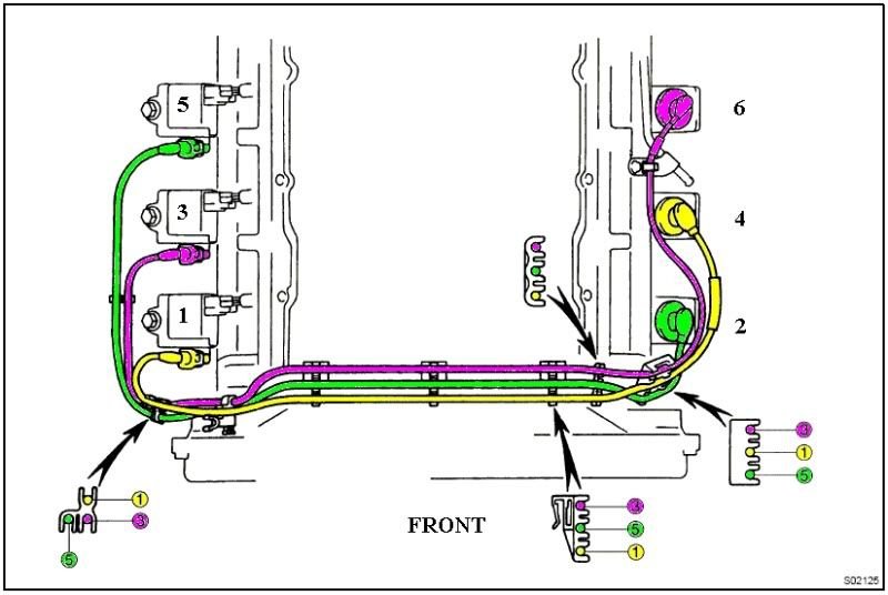

    Check what bishop84 says to check. Could be that the coil pack for the #3 cylinder is going out. That would explain the P0303 and P0306 codes.I would swap the #3 coil pack with the #5 coil pack. Reset the computer and see if the problem moves. Prolly have to drive an hour or so for the computer to catch up. If the problem moves from cylinders 3 and 6 to 5 and 2, then replace the coil pack. See the image below:
    If swapping the coil packs doesn't change the symptoms then I would prolly replace the injectors. All of them. Timmy the Toolman uploaded a video he made to his Youtube site that explains in detail how he replaced his injectors (and in excellent detail, I might add). Check it out.
