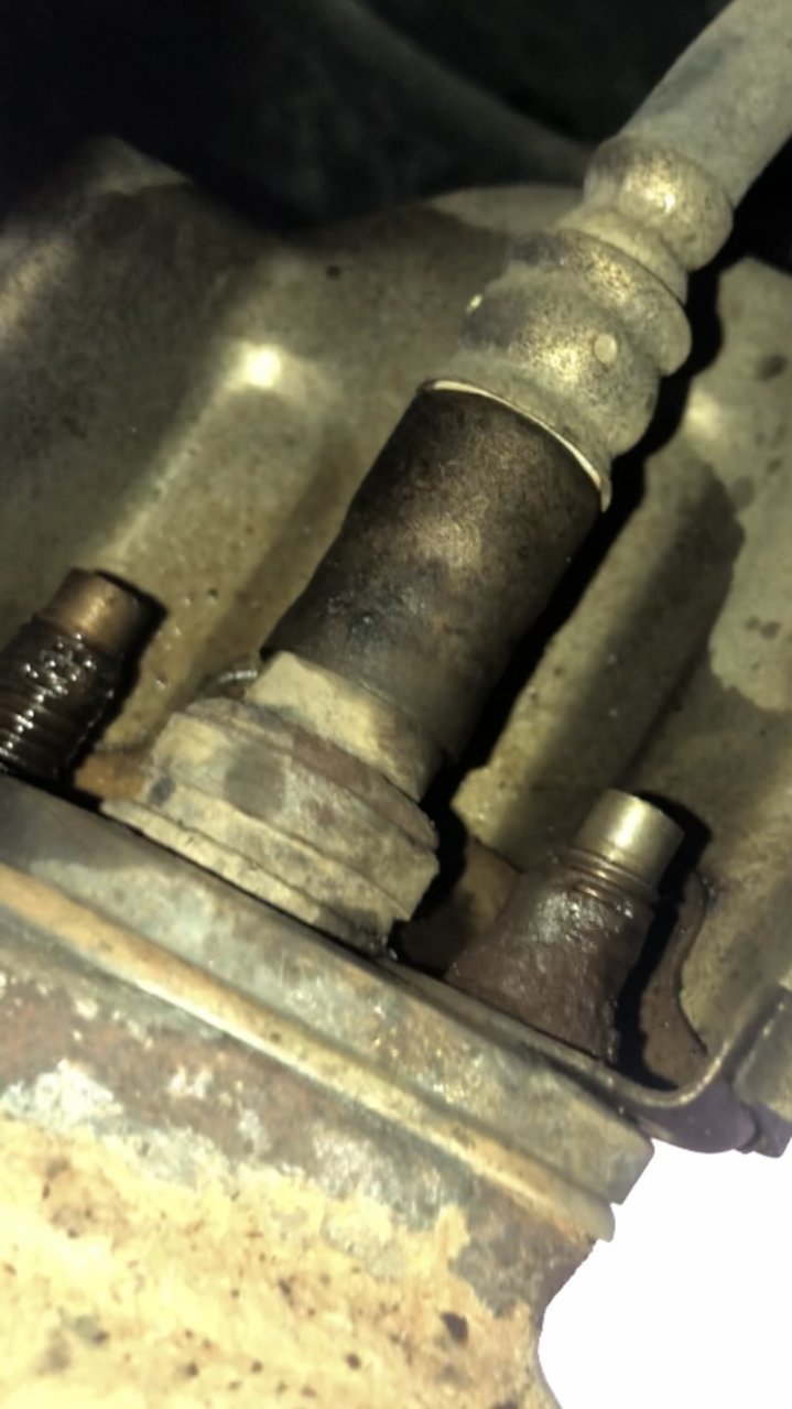

    Following O2's, I checked for exhaust leaks. Found a major leak at the downstream sensor flange, as well as a small pinhole at the first cat, just before the flange. Picked up a new gasket for the O2 and discovered one of the studs didn't even have a nut on it and the other was either rusted to oblivion or welded to the sensor. See photo.
    I ordered a new flange kit from YotaShop to cut the studs and weld in a new flange. I'll fix the pin hole for the first cat as well.

    Does anyone have experience attempting to remove studs with vice grips? I'm thinking I might give it a shot after work - let me know if you have any tips other than penetrating oil and maybe grinding in a couple of flat sides.
  14. Feb 20, 2023 at 11:08 AM
    Area51Runner
    Area51Runner Well-Known Member
    Jun 26, 2014
    #132748
    11,976
    Northern California, Bay Area
    02 3.4 DC TRD PreRunner 4WD SWAP
    I had an issue with a broken stud on the upstream sensor. @Blackdawg suggested a stud extractor. Ordered this one https://smile.amazon.com/dp/B01GKEBG9I which is currently out of stock but others are out there. Had no issues at all getting that broken stud out.
    Should do the same for your situation. Order up an extractor and hopefully you'll be laughing at how easy it was.

    Right on. There's a tool for everything. I was planning on trying the double nut method but I'm always down to spend $20 on the proper tool. Thanks, Mike!

    Picked up a stud remover. Due to the shield that was protecting the downstream O2 sensor, it wouldn't fit unless the shield was removed. I was able to bend the shield up and over the stud that was missing a fastener and discovered that the weld was actually a nut that was rusted to hell and back. Shifting the heat shield back a forth, I was able to break the fastener loose and thread off what was left with a pair of vice grips.
    The O2 sensor looked like it was in great shape w/ in-spec ohm reading, so I chased the studs with a die and the new gasket was installed - No more leak. Truck seems to have a bit better pick up and the CEL hasn't illuminated yet.
    Does anyone know what value the MAF rate should be at idle for a 3.4L? I haven't plugged in my scan tool since the O2 gasket was replaced, but I was getting 0.6 lb/min at idle. Seems very low based off the little information I was able to find. Air filter is brand new.
    Edit: Also replaced PCV hose. It was on it's way out. Planning on doing the valve and grommet once they're delivered.
    Here's a photo of the nut for entertainment.
