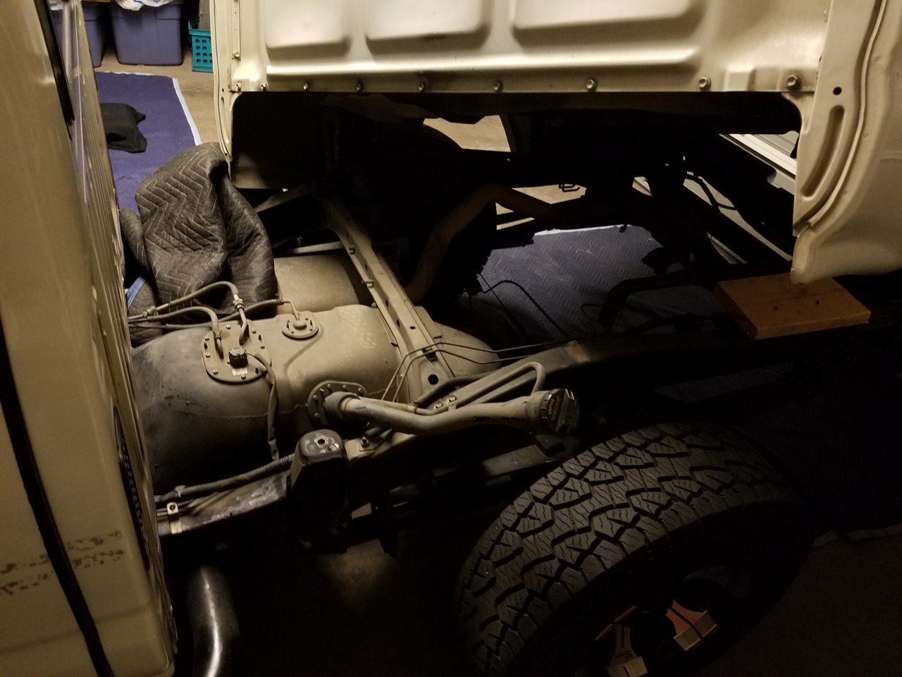

    V6 5sp,RegCab,TVS1320 Supercharger, 56mm pulley, methanol injected Haltech ECU, AC Tvs1320 supercharger,(MUST DO) every 125,000- 150,000 needs rebuild Projector headlights HID 5 speed manual Amsoil for all drive train Smaller 56mm custom pulley, (MUST DO) 2004 DESNO fuel injectors, zero ping ping, 2004 side door mirrors Dick Cepek Rims, Michelin tires LTX, ATM Pathfinders Dynopro ATM ( that last 100,000 miles) Now running Dynopro ATM mud and snow tires KN cold air intake Cat back dual exhaust with ss exhaust tip, Raised exhaust tail pipe to 2" below body line Optima*dry cell battery,red top Alpine sirius radio, 200 watt amp, focal is165 split door pod speakers Focal door speakers Subwoffer behind seat Viper alarm, Electric Locks Dark tinted windows, bucket seats corbeau lg1 Tacoma Rubber floor mats TRD fender extenders, Bilstien shocks, King shocks JBA UCA trailer iv hitch, electric brake control, Drilled slotted brakes, High carbon steel (MUST DO) EBS green stuff 7000 series pads(MUST DO) TRD engine oil cap TRD stick shift, Marlin crawl shift kit. Rear sliding window 2002 4Runner functional hood scoop cut into Tacoma hood, 4Runner dual overhead map light Gentex Auto dim + Compass + Temp, garage,rearview mirror Snow Methonal kit stage 2 Custom 3 core aluminum radiator Linex bed liner Haltech stand alone ECU, Intake supercharger gauge. Stainless steel brake lines, Custom leather wrapped steering wheel, Haltech stand-alone ECU,
    So about 2 weeks ago or so my long fuel trims went through the roof and when cruising they are
    at 25-30. Typically they are at +-5,
    I took it in to the dealership and they did a smoke test, came back with no leaks,
    Then did a fuel pressure test and was at 46, normal is 44-48,
    Put in a new OEM DEALERSHIP MAF and still didn’t fix the issue.
    Now the AFR is climbing to 13.5 -14 under full boost when its normally at 11.5 under fulll boost.
    I can now hear the truck ping under load too.
    Today the code p0171 popped up.
    Can this be from a weak fuel pump?
    Don’t know what direction to go?
    I have an EGR system but the trim codes came out of nowhere to positive 20-25
    and there has been NO engine work done on the truck since the timing belt 6 months ago.
    Where do I go from here

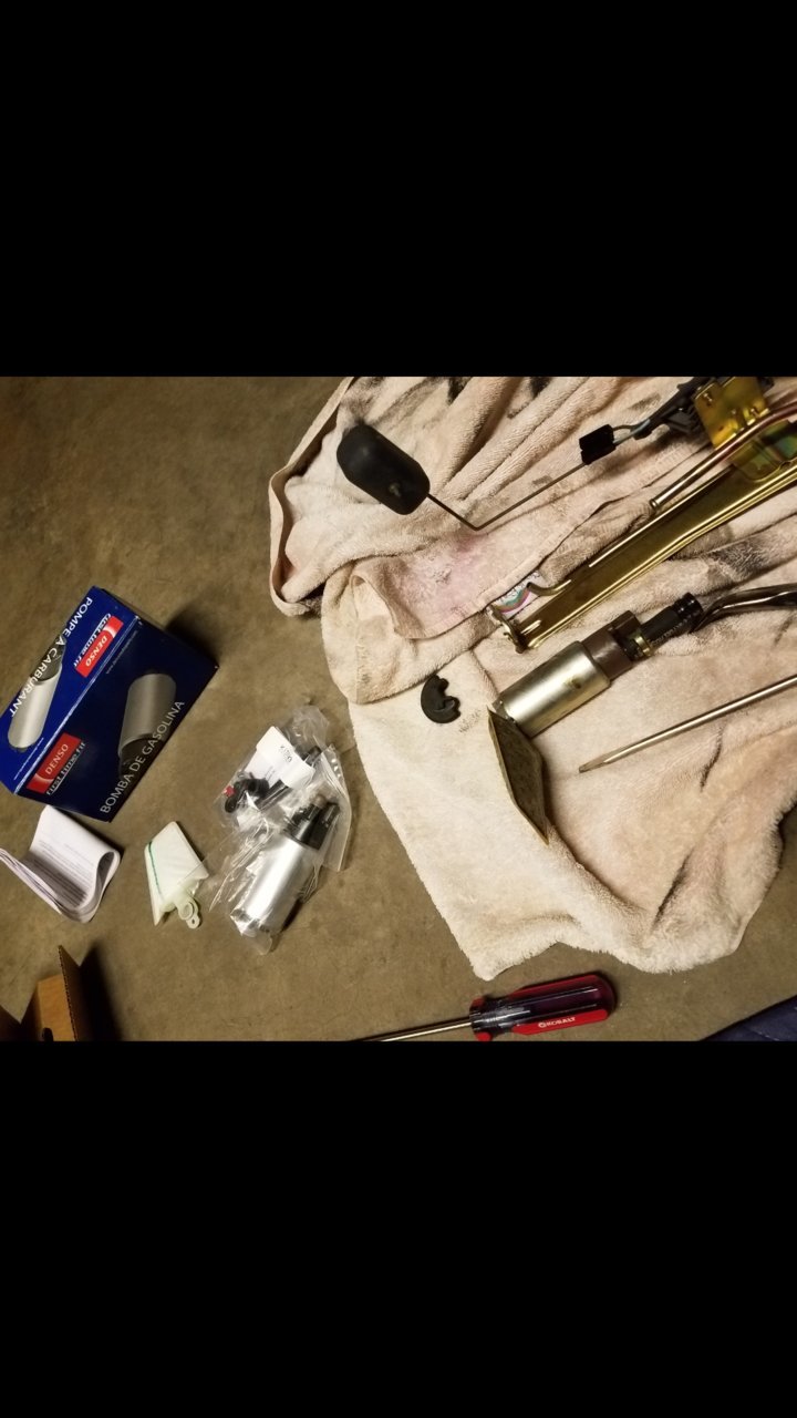

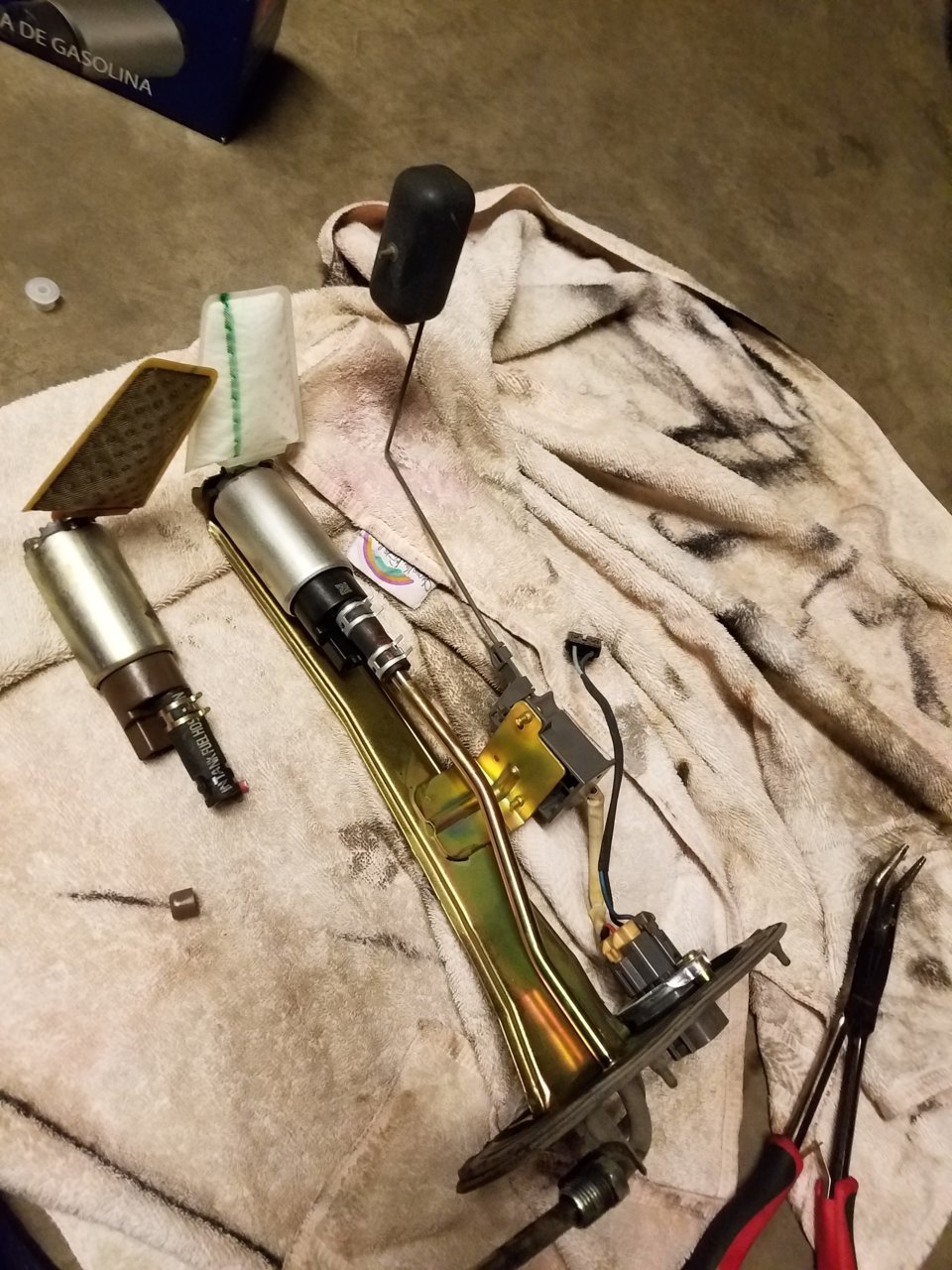

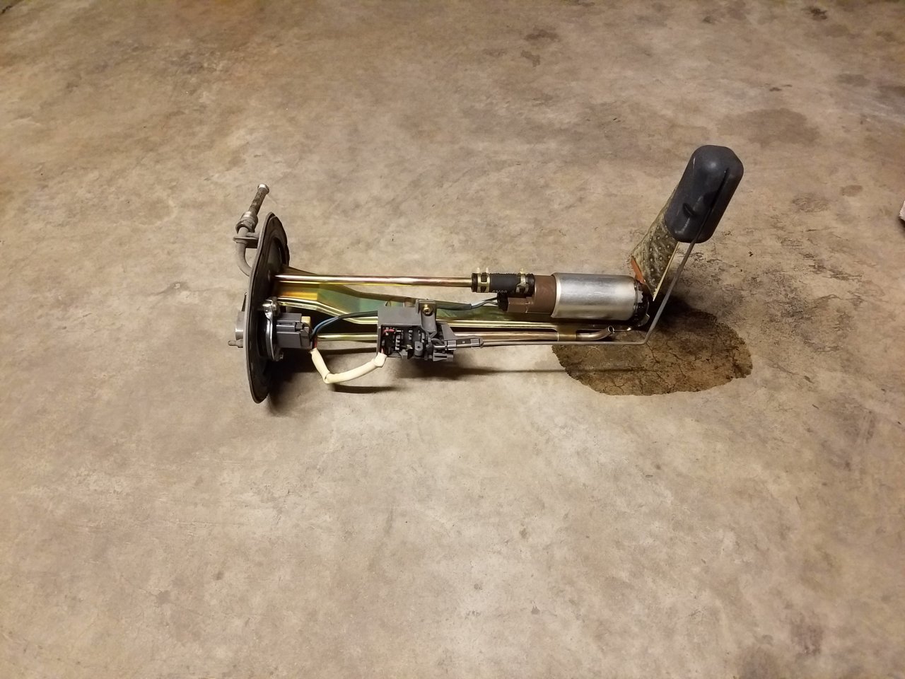

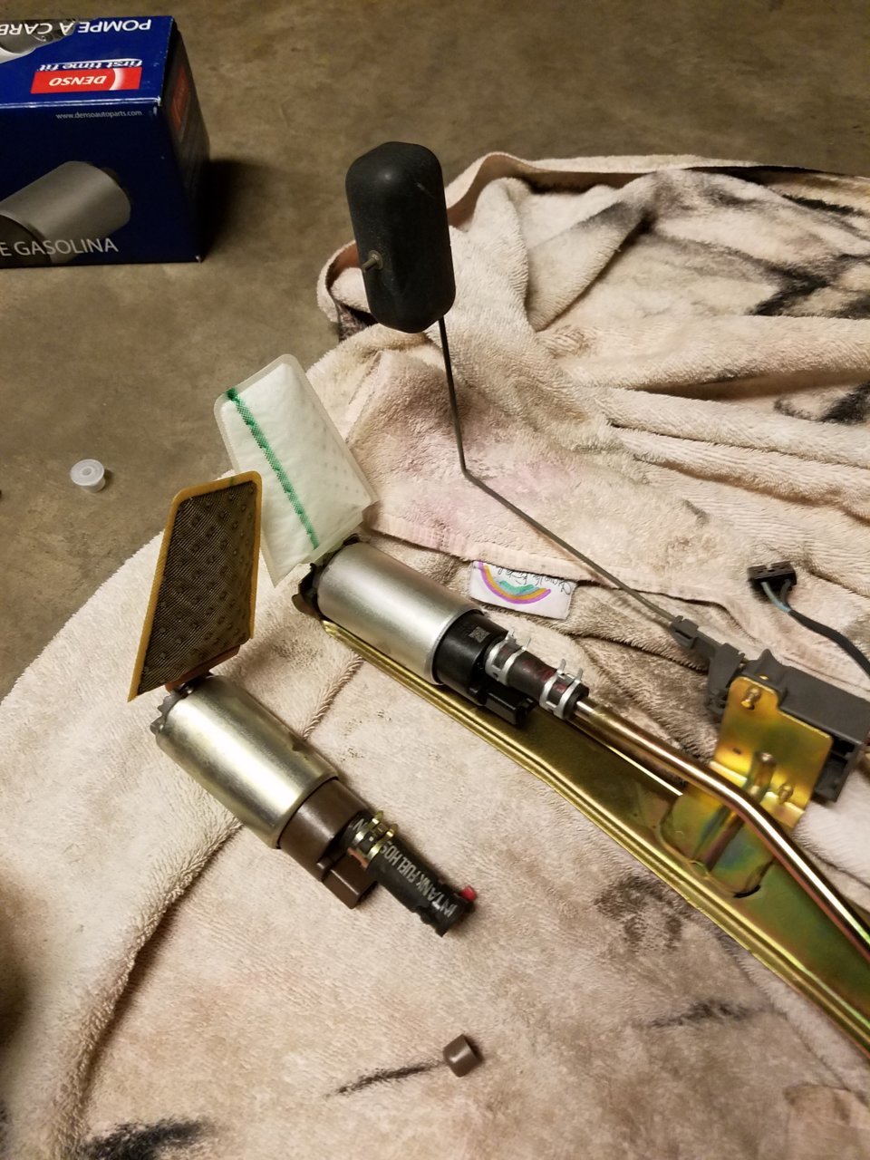

    I’ve had plenty good luck with the stock fuel pump, tried and tested lasting 300k miles.
    I had the smoke test done at the dealer and replace all my vacuum lines under the hood, so no leaks found.
    Pulled the trigger 4 hours ago and installed a new DENSO pump and filter.
    Reset the ECU and took a quick drive and the long term fuels trim are no lomger +25.
    They are at -4 now.
    Looks like the DENSO fuel pump runs about 300k,
    1st one failed at 300k and now my 2nd one failing at 605k
    with P0171 code (lean code, MAF code)
    Will see how it goes after the ECU is relearn.
    I unbolted the bed and tilted it a bit.
    Just be careful with the bed rear lower quarter panels as they have
    NO structural support and can buckle under the weight of the bed.
    You need to support the bed from the center section to carry the bed weight.
    The front quarter sections have body supports.
    eon_blue[QUOTED] and cruiserguy like this.
