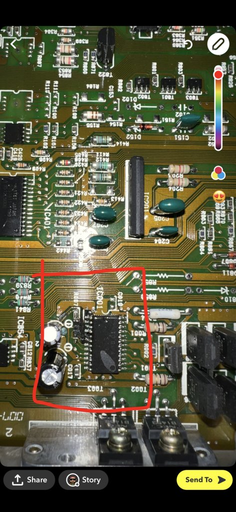

    IMG_5669.jpg IMG_5677.png IMG_5669.jpg So I had this issue a year or so ago, and that PO171 code plagued me for like a year and a half. I checked everything just like you, seemed like the possible issues were as long as a CVS receipt. But one of the issues that aren’t brought up about that code is the possibility that the ECU is going out. Long story short, after all my research and 3 shops later, an older mom and pop shop mechanic told me he had one tacoma ever come in with this issue and it happened to be the ECU. So back to researching, I couldn’t ever find anything extensive on the subject unfortunately. Found a guy on YouTube that worked on them and shot him an email and he asked if I would send in a picture of the internals of it, so I did and he told me the issue was a capacitor was leaking on to the chip board and it just so happened to be the portion of the chip that was the fuel control module.
    Remedy: bought a 97 ECU with the same numbers as my OG Ecu and fixed everything. I could not believe it!!!
    This is my first post ever. I just joined, but have scoured this website for over 4 years now for all my research needs. I wanted to share my personal experience with this gremlin of a code because I was seriously considering selling the truck if I couldn’t figure it out and I’m very glad I didn’t.
    Jimmyrace, Ngneer, THatt and 4 others like this.

    Thanks @South_Ga Taco, I'll have to take a look at the ECU caps soon if I can't figure this out.

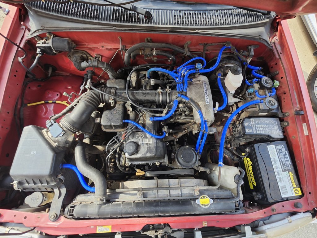

    OK I finally had some time to work on this and I have some new clues that’ll hopefully make sense to somebody more experienced than me.
    First, Dm93… to answer your question I didn’t replace the injectors, I was just saying I cleaned the system with Seafoam (2-3 times recently).
    I replaced basically all of the vacuum hoses as well as the idle air control valve. I figured I’d try the IAC because according to my live data the STFT is 0% when I’m driving… it only jumps up to 19.5% at idle. Plus the truck’s idle RPMs are all over the place depending on whether it’s warmed up, if the AC is on, etc.
    Anyway, I disconnected the battery and pulled the EFI relay when I replaced the IAC, so now I’m seeing 0% LTFT and 19.5% STFT. I’m guessing LTFT will jump once I drive it a little more and hopefully STFT will then go to around 0%. The truck currently gets around ok, but there’s definitely been a loss of power since changing the IAC and resetting the computer.
    There is also a subtle behavior that might be a clue. I'm not sure if this means anything but STFT now stays at 19.5% basically any time I keep the RPMs below 2000, whether driving or idling. It only drops to 0% if I get the engine above 2000 RPMs and only after I let off the gas pedal. Does that tell anyone anything? Any other ideas?
    · Vacuum - checked at shop (no leaks), home w/ carb cleaner (no idle revving), & home with a vacuum gauge (normal)
    · Vacuum Hoses – replaced most
    · Idle Control Valve - replaced
    · PCV Valve - replaced
    · EGR Valve - replaced
    · Valve Cover Gasket – replaced
    · Throttle Body – cleaned thoroughly; replaced gasket between it and the intake manifold
    · MAF Sensor - replaced
    · Upstream O2 sensor - replaced
    · Downstream O2 sensor - replaced
    · Air Intake Filter - replaced
    · Fuel Filter - replaced
    · Vacuum Switching Solenoid - replaced
    · Spark Plugs - replaced
    · Master Cylinder - replaced
    · Fuel injectors – DID NOT REPLACE but cleaned w/ seafoam
