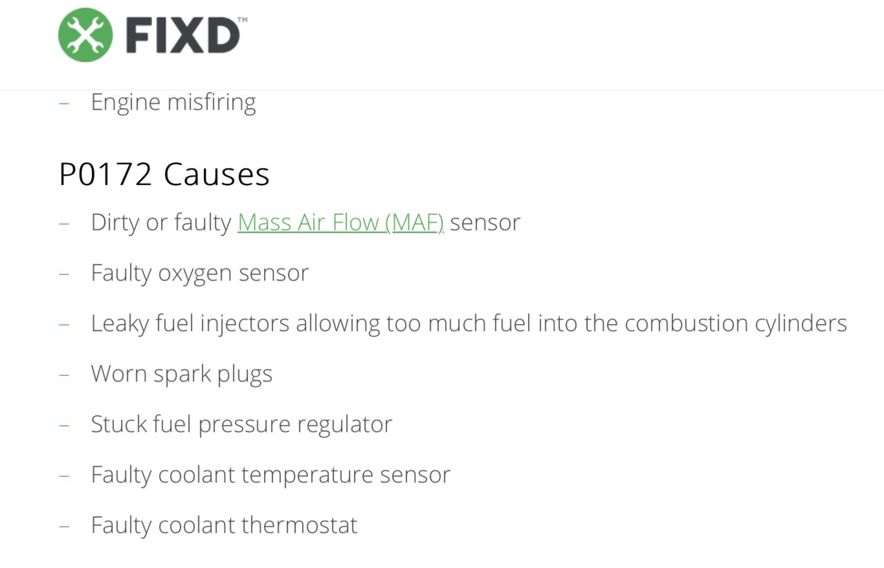

    I'm sure you've looked this up too but my expert google mechanic skills have brought me to this...
    I guess in order of the list, the O2 sensor wouldn't be too hard to pull out and take a look at
    I would think if the temp sensor or thermostat were malfunctioning you'd probably be seeing overheating on the gauge but maybe not?

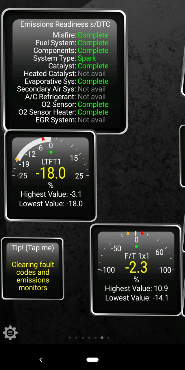

    Stuck injector (s)? SS taken at idle after going for some romps

    Are those numbers good? Or that's what we need to know?
  19. Oct 17, 2019 at 6:44 PM
    #19
    Wulf
    Wulf [OP] auto dismantling & hoarding disorder
    Jan 30, 2015
    #147523
    62,503
    rock raisin
    That is what the fuel trims are, good or bad I do not know
  20. Oct 17, 2019 at 6:47 PM
    #20
    Reh5108
    Reh5108 Well-Known Member
    Feb 18, 2013
    #97832
    5,806
    Idaho
    2004 SR5 4X4 2.7L Extra Cab
    OME lift, 4x sliders, Demello rear bumper, custom front bumper, Engo 9000lb winch
    Fuel trims should generally be below 10. -18 means it's running rich. Could be do to a bad O2. You should be able to test it to confirm its bad before blindly throwing parts at it
