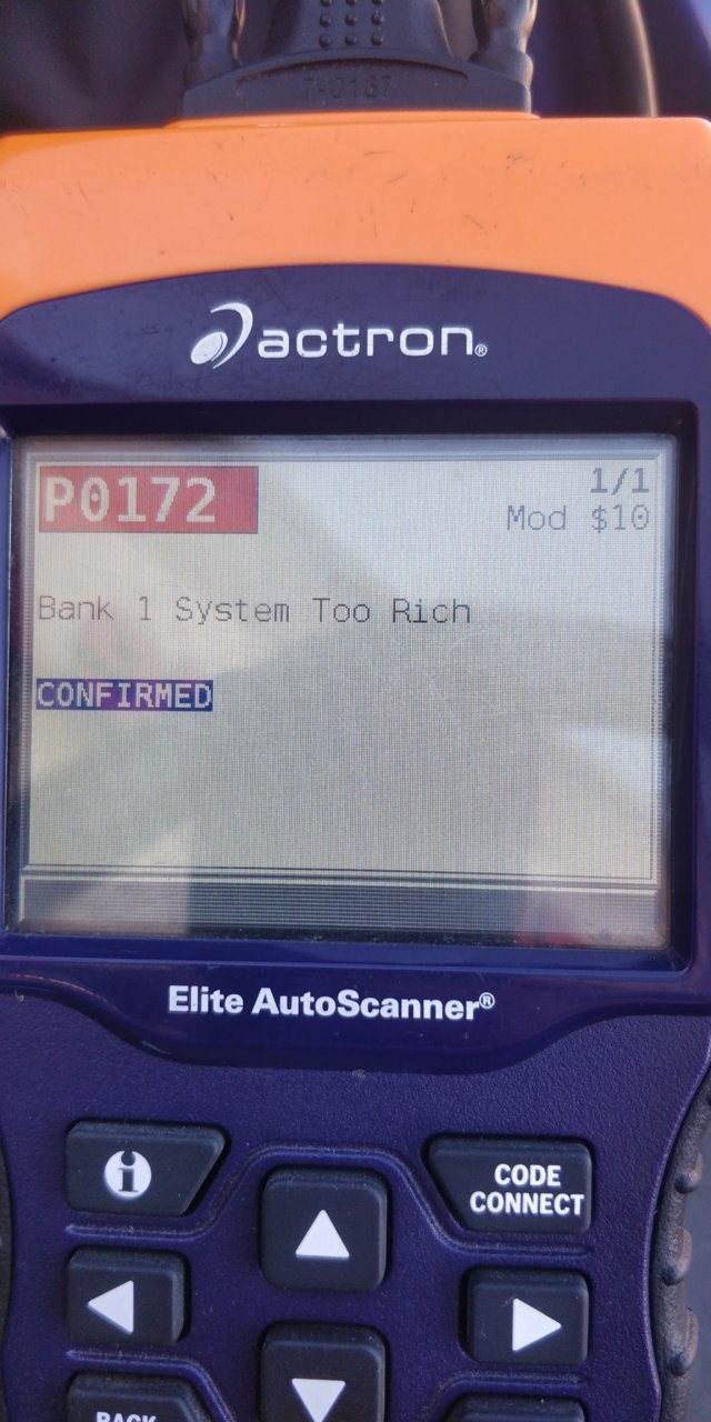

    While wheeling yesterday I popped a CEL which is code P0172 for running rich and the suggested fix is replacing the MAF. I was also at about 11000 feet when the CEL came on.
    Is it likely that the MAF is actually going bad?

    Don't forget that oxygen sensors when failing can influence fuel air mixtures as well. If they have never been replaced or have around 60k then that should be next on your list
    Edit: you can try to save the MAF by buying some MAF cleaner at your local vatozone/walmart as well. 6 bucks and 10 minutes of your time (8 minutes of drying to make sure it's really dry)

    Ah, I've done that as well without issue. I figured lugging along in 1st fear and 4low might have played into it but it sounds like I should just replace the MAF. I need to get my emissions done this week and get to the DMV before the end of the month

    I cleaned the MAF and reset the ECU this morning. Truck seems to drive fine, maybe a little more sluggish than usual but it's also pretty cool outside right now. I know you're supposed to put 200~ mi on the ECU to relearn it but I don't think I'll be able to swing that before having my emissions done.

    And just FYI, the Mass Air Flow [MAF] sensor is nothing more than a wire or a grid that has current flowing through it. The air flowing across it, cools it and that cooling changes the electrical resistance of the wire or grid. That change in electrical resistance is measured and corresponds to the amount of air flowing across the sensor. That calculation is corrected for the ambient temperature of that air.
    Higher altitudes result in lower air density and generally lower air temperatures BUT because the air is less dense the actual amount of air (the mass of the air) flowing over the sensor is less - so that part is actually self-correcting! It still reads the Mass Air Flow accurately. (it's pretty simple engineering and a pretty cool solution). It's the temperature change that messes with the computer's calculations a bit.
    The computer has algorithms to automatically adjust for altitude changes and the effects of lower atmospheric pressure. The computer reads other values like O2 sensors, throttle position sensors, engine temp, engine speed and it adjusts timing and fuel delivery to meet those conditions. However, every now and then when temperature and atmospheric pressures change rapidly, the computer can get a little outside of its "comfort zone" and throw a code. That code might show a bad sensor but the sensor isn't really bad, the computer just momentarily thinks it is.
    If it throws the code repeatedly then, yes, you may have a bad sensor. If it only does it under rapidly changing conditions occasionally, it's probably just the computer getting confused.

    This happened to me a while back when I was in Colorado on vacation. Back before I had my own code reader. Now, I don't know exactly what code it was, but this sounds like it could be the same. I took it to a shop and they cleared it and said to keep driving. If it comes back on, it could be something else, but since I live a sea level, that was likely the issue.

    The truck still seems to be moving along alright, but I did notice that the idle is rough at stop lights.
    I've recently done plugs and wires too, so maybe the MAF is on its way out.
