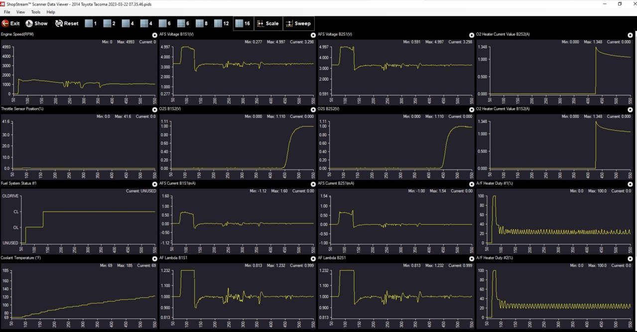

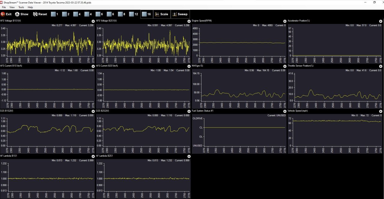

    Here's a couple examples of what your AFR & O2 Sensor signals should look like.
    Cold Start
    Driving

    Thanks for that info. I record and save the freeze frame data on the reader last night, after warming the truck up but I didn't see any way to view graphs. I'll have to go look and see if charts like this are availble on my scan tool.

    So I am not finding a way on my tool to display charts. I recorded the freeze frame data but there doesn't seem to be a way to visually assess it. Is there readings I can share from it that will help us narrow things down?

    On the graph data you want to see the upstream sensors switching high low and the post cat o2 should look fairly flat.

    I cannot get it to display a chart. It says its recording the data but I cannot find a way to look at it on a chart.

    What scan tool do you have?
    Most support live data and alot of them support graphing.
