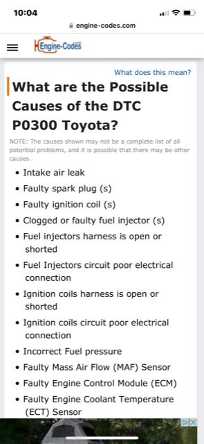

    Assuming that no issues 20k ago after plugs/coils/FF/injectors installed……
    U can rule out bullet points 2-8
    Rule out ECM too
    as u state, once lil warm runs OK
    Intake leak?
    Metal/rubber expands once heated up then no leaks….appears to run fine
    Test: spray carb cleaner on air intake and intake manifold while engine running
    If Engine changes RPM’s….there is your leak
    -clean MAF sensor with SPECIFIC cleaner
    -bench test or just replace coolant sensor
    -test F pressure…..if not 39-45lbs….replace fuel pressure regulator (cheap) if no change, replace FP in tank
    HG issue could cause misfire, but if no overheating/no low coolant unlikely
    Test: pull your newish plugs, if rusty from water/coolant, very possible HG
    GL
