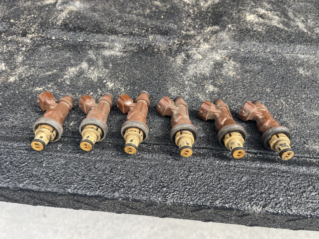

    -Past few weeks: cleaned MAF, all 6 Injectors (from motor west), fuel pressure regulator, upstream air/fuel sensor (denso).
    All parts were replaced with either OEM, Denso, or Standard.

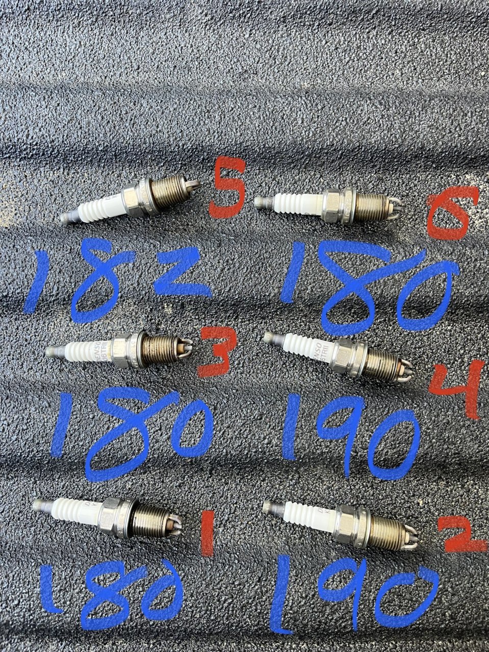

    Before I put my spark plugs back in the last time after a successful compression test (8/10/22) I put on some dielectric grease on the metal ends of the plugs and a little inside each coil pack. My startup misfire has been gone ever since! No p0300. No shaky starts. I wasn’t expecting this. Usually when I cleared my CEL it would come back later that day or the next morning. Sometimes it would intermittently clear itself and then come back later or the next day. Almost 4 days now and only the p0420 has come back (which I don’t care about right now cus that’s been on and off for a few years). Unless they’re related? What do you think?
    1. Did the dielectric grease really fix my misfire? My plugs, coil packs, and wires are all still relatively new I would say. They all looked good to me, no cracks or shorts that I could see. Should the spring in the coil packs be pushing the pack off the valve cover a little (contact with the spark plug) or should the coil pack be sitting flat on the valve cover?

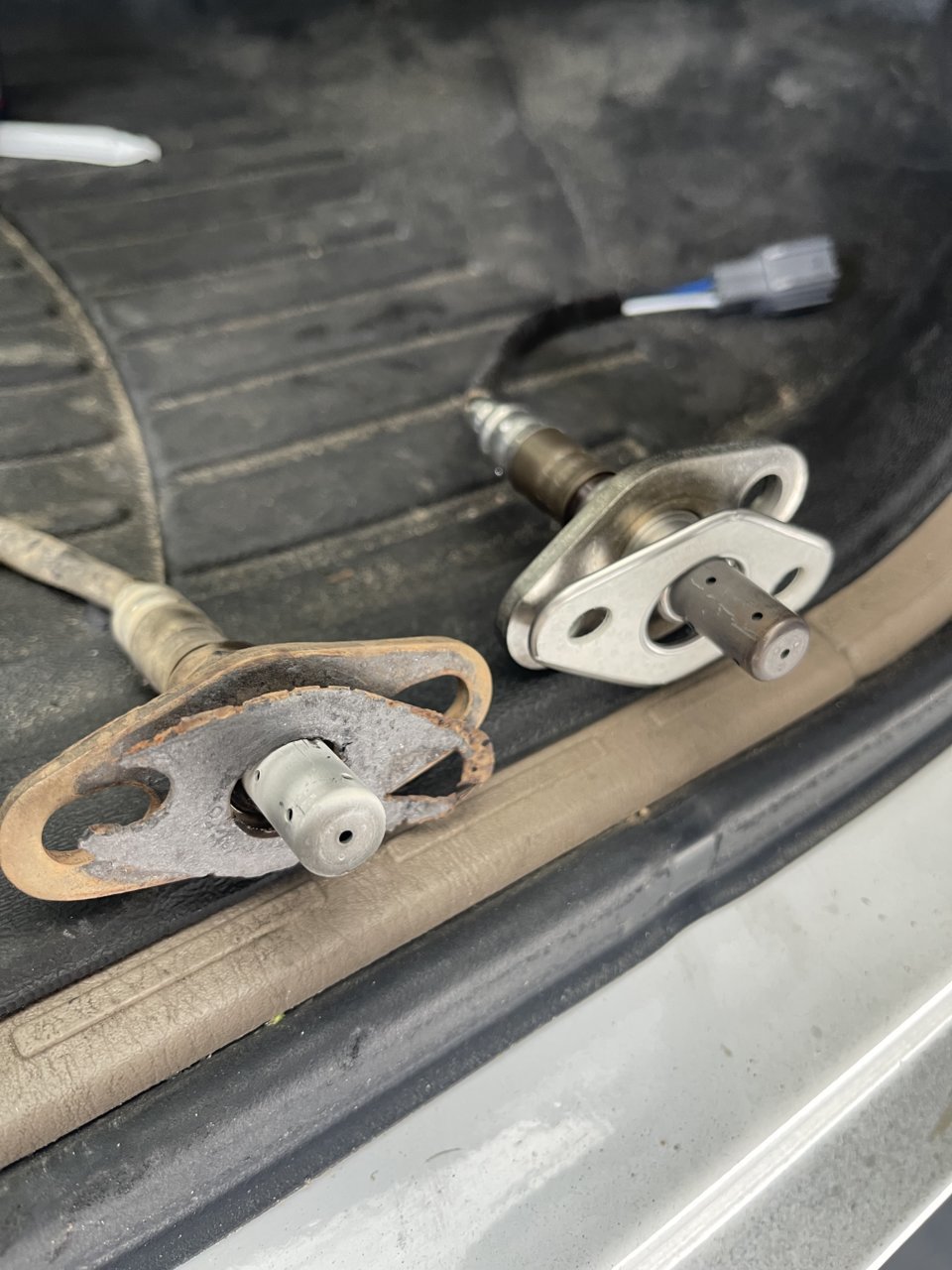

    2. Did my new upstream O2 sensor just need some time to adjust? The gasket on that was absolutely toast. I’ve read that these need some time to adjust to the computer before you start seeing mpg difference. What about misfire difference?

    1. After I did the injectors and FPR 10 days ago, it didn’t misfire for the rest of the day when I was running around town. Started up easily. I was convinced I fixed it until the next day when the p0300 came back.

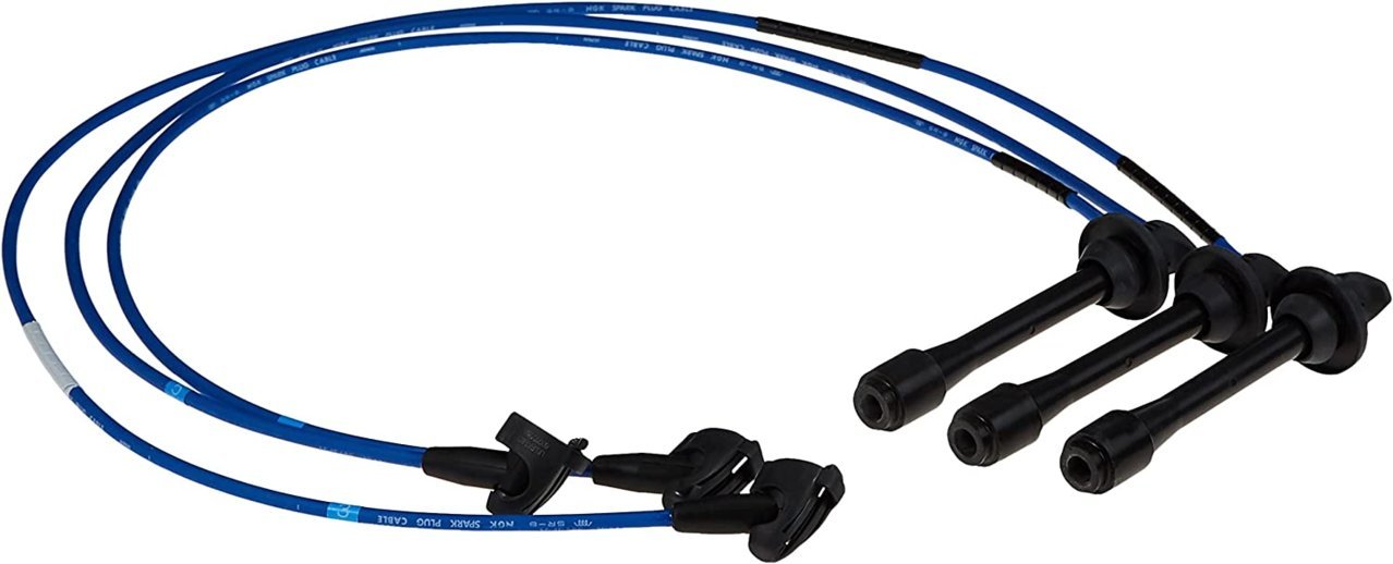

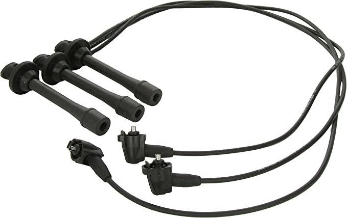

    Do you recall which wire kit you went with? OEM? Or those blue denso ones everyone on TW seems to like and use? Or perhaps another brand?

    2nd the oem because it seems this engine is more sensitive than most to wire issues. Look at FSM how they specify routing at every support and even that 45 degree twist on the last cylinder.
    I don't know if they are really this sensitive but for a few bucks I don't want to find out. Also you get all new clips and often the old ones break.

    Denso cables are black......
  12. Aug 15, 2022 at 12:43 PM
    O'Silver_Taco
    O'Silver_Taco Well-Known Member
    Aug 26, 2021
    #375390
    4,251
    MD
    98 Dlx Sr5 ext AT Rwd
    3rz to 2Rz bebuilt block and new heads
    NGK's are blue.....

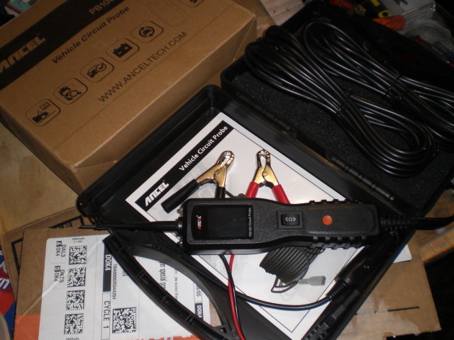

    They sell probes that start around $60......
    ......but that may not tell u whole story without everything firing on all cylinders at speed under a highway load......

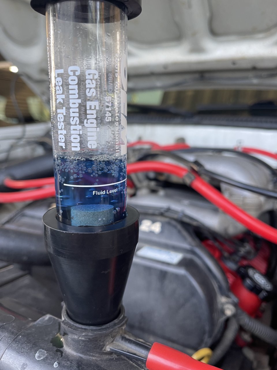

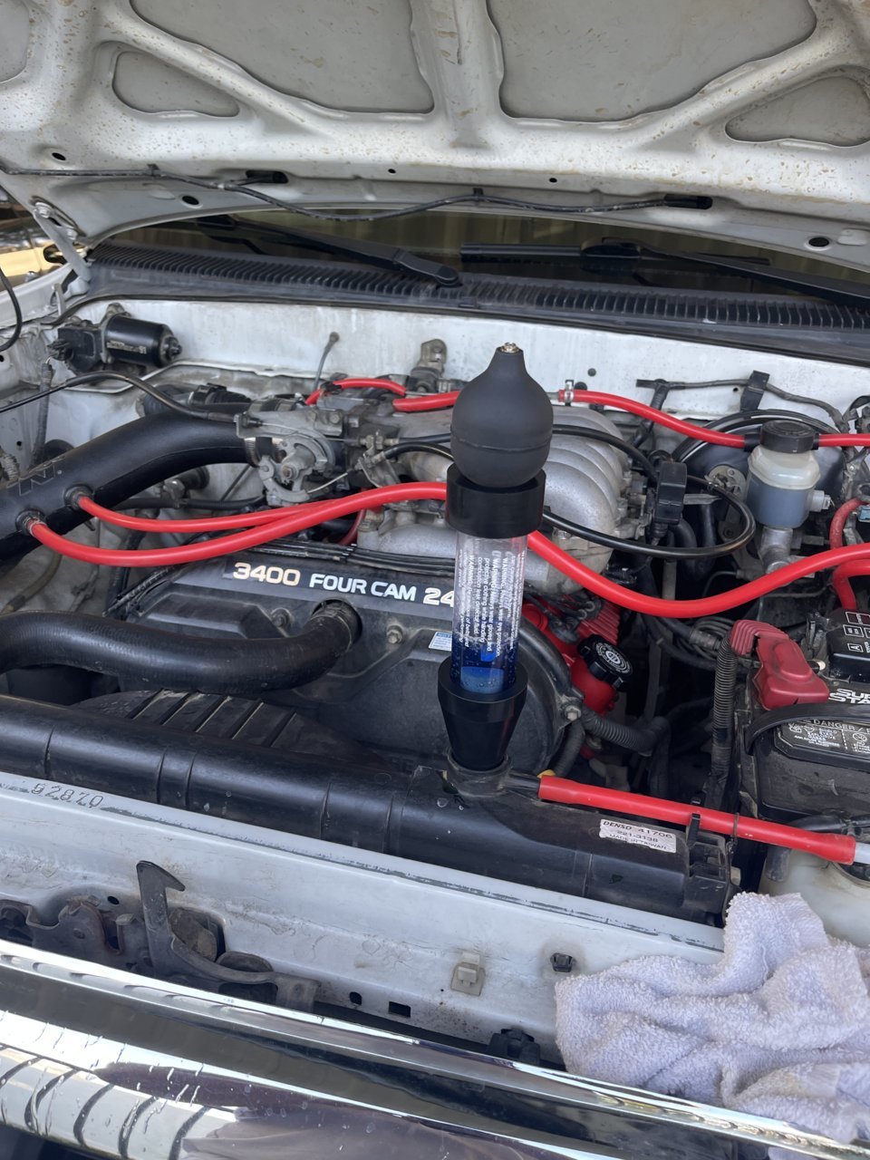

    Noticed my coolant resivor might have dropped a little since I filled it last week. Radiator still full. Also noticed white smoke coming out the tail pipe during my cold start today while it was in the 70s so not like it was cold outside. This kinda re-ignited my HG suspicion.
    Then I learned about the block tester kit which is suppose to confirm a HG leak or head crack. Blue=good Yellow=bad (leaky HG or cracked head). Instructions say to test for about 2 minutes, I probably tested for almost 10. Stayed blue the whole time! I also capped the hose to the overflow. Also no bubbles in the coolant itself and looks clean.
    SO. After doing this test and my compression test both being successful, is it safe to say that I don’t have a head gasket leak or cracked head yet? Or is still possible? Where else could I be losing coolant? I seem to get consistent exhaust condensation. Could some of that be coolant? I read somewhere that coolant can evaporate from the radiator cap?

    1998 TRD
    I had a Supra with bad HG, it was obvious exhaust went into the coolant because temp gauge all over the place and coolant bubbling.
    But on my 3.4 it seemed like coolant only went from coolant passage into cylinder so maybe exhaust test wont work. I think the acid test is coolant in the cylinder. This was obvious for me and many others - early symptom is a miss for a few seconds on startup which progresses to white smoke on startup.
    It might be worthwhile to do a coolant system pressure check and possibly pull spark plug cold and check for coolant in cyl, hi tech way is with a camera probe (never did this) but you can probably come up with a low tech way using something absorbent.
    Finally check your oil filler cap because a milky haze will show up there well before oil milkshake.

    Ya my next test is probably going to be the camera probe just to triple check for coolant. And I think my oil looked good.

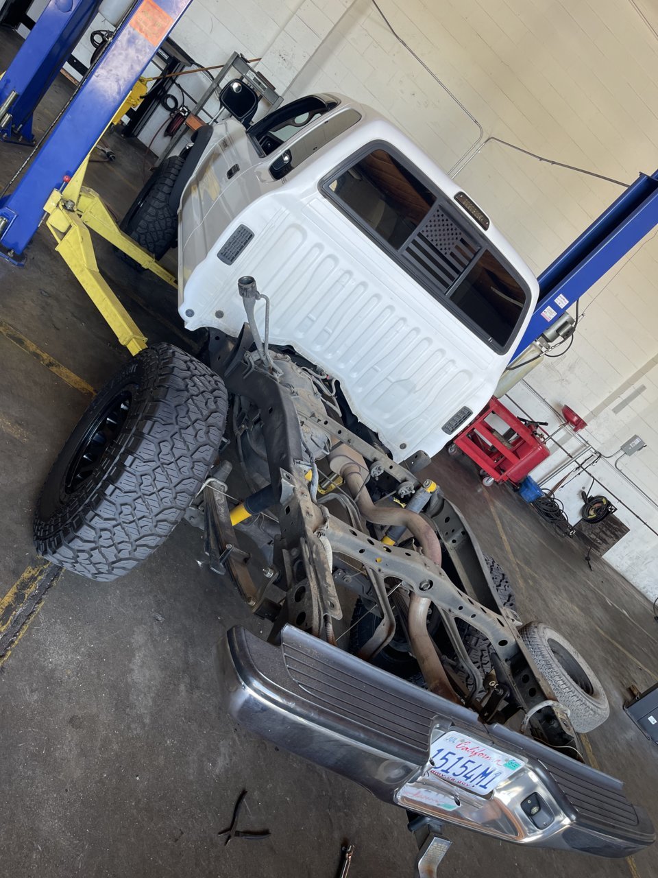

    So I just made the drive from San Diego to Sacramento a few days ago. But before I left I put in Blue Devil head gasket sealer. Seemed to start better for a little but next day the misfire came back. Anyways, the truck drove just fine all the way. I was constantly monitoring coolant temps with my FIXD scanner, staying around 184. Got as high as 195 going though the grapevine and as low as 175.
    I popped the hood at one of the gas stations and noticed coolant leaking somewhere behind one of the pulleys. My resivor was still relatively full. I made sure to bring plenty of coolant just in case.
    Anyways, once I got home I took it to my buddy’s shop to have them scan it over and give me their opinion. I personally know these guys very well as I grew up with a few of them (they’re 3 brothers), and their dad owns the whole shop. As well as their mechanics have years of experience and they’ve worked on my truck in the past many times. So, they believe I have two problems and not just one like I’ve been wanting to believe. Basically my coolant is leaking from the water pump so it just needs to be replaced. I figured as much, but that still leaves the misfire. They believe my cat is clogged up and is causing that. Since I’ve had the p0420 for years and never dealt with it they think that it’s just been getting worse and clogged until now it’s causing to misfire. Thoughts?
    I just bought an Aisin water pump, thermostat, and Toyota red coolant. Timing belt should still have some decent life left on it but I may or may not replace it anyways. I also don’t have the crank shaft pulley bolt which I read is a one time use. My old man has offered to go to the dealership for me and getting the crank shaft pulley bolt while I’m tearing the water pump out. I might just have him grab a timing belt as well.
