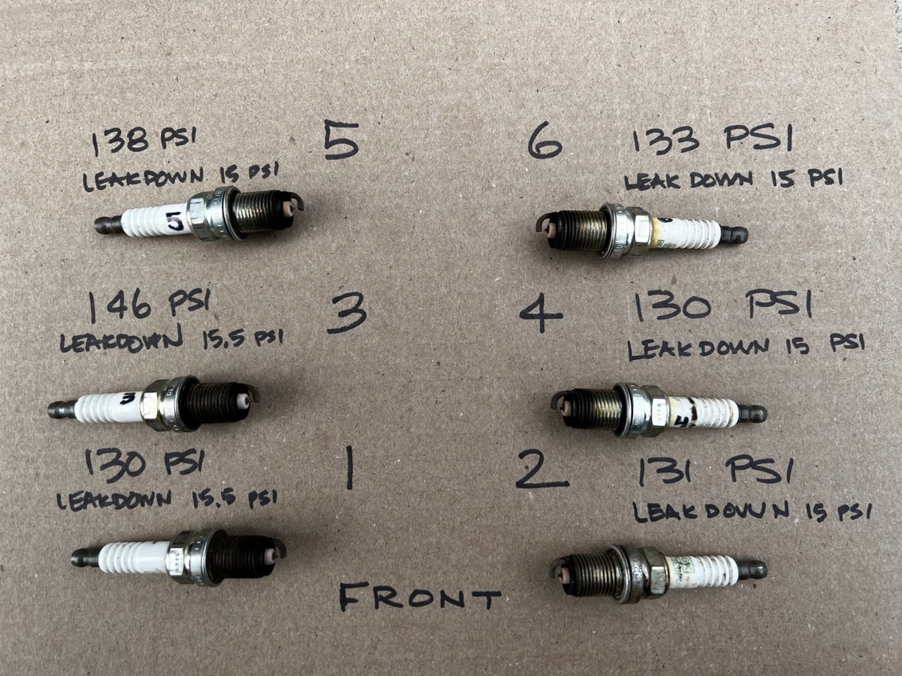

      • DRY COMPRESSION TEST RESULTS
        Cylinder 5 - 138 PSI
        Cylinder 3 - 146 PSI
        Cylinder 1 - 130 PSI
        Cylinder 6 - 133 PSI
        Cylinder 4 - 130 PSI
        Cylinder 2 - 131 PSI
        I think you would agree these are good results for a dry compression test (I say dry because I did not squirt any oil into the cylinder before taking the readings).
      • LEAK DOWN TEST RESULTS
        Cylinder 5 - 15 PSI
        Cylinder 3 - 15.5 PSI
        Cylinder 1 - 15.5 PSI
        Cylinder 6 - 15 PSI
        Cylinder 4 - 15 PSI
        Cylinder 2 - 15 PSI
        For the test, the rad cap, oil dipstick were removed and the and air filter disconnected from the throttle body.
        For ALL cylinders, no bubbles/air seen escaping from coolant, nor oil dipstick. I did hear a very faint sound from the tailpipe on all cylinder tests, and I think that's normal. Not hearing or seeing any air escaping from the coolant via the radiator cap opening really confused me. I thought for sure I have a blown head gasket, but if I did, surely I would see bubbles coming from the radiator cap opening on at least 1-2 cylinders.
    Since the compression test looks good and the leak down test didn't indicate a blown head gasket, I can only assume that the coolant disappearing from the system has to be from something else. Strangely, there are no leaks on the driveway. None at all.
    I would assume you can have a leak down test not show air from the coolant (radiator cap opening) and still have coolant leak into your cylinders from somewhere else... the air was escaping at 15PSI from all cylinders evenly, which I would expect on a perfectly healthy engine, so that is strange to me. I expected to see at least one cylinder with a higher reading than the others. I keep coming back to thinking there is coolant leaking slowly into the cylinders and that's why it runs rough on startup.

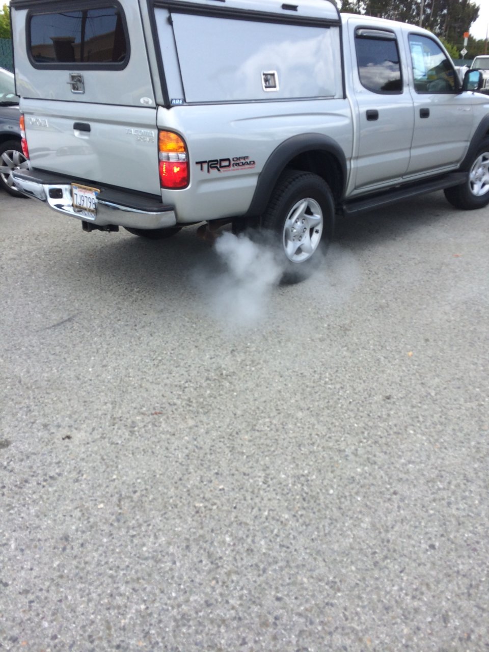

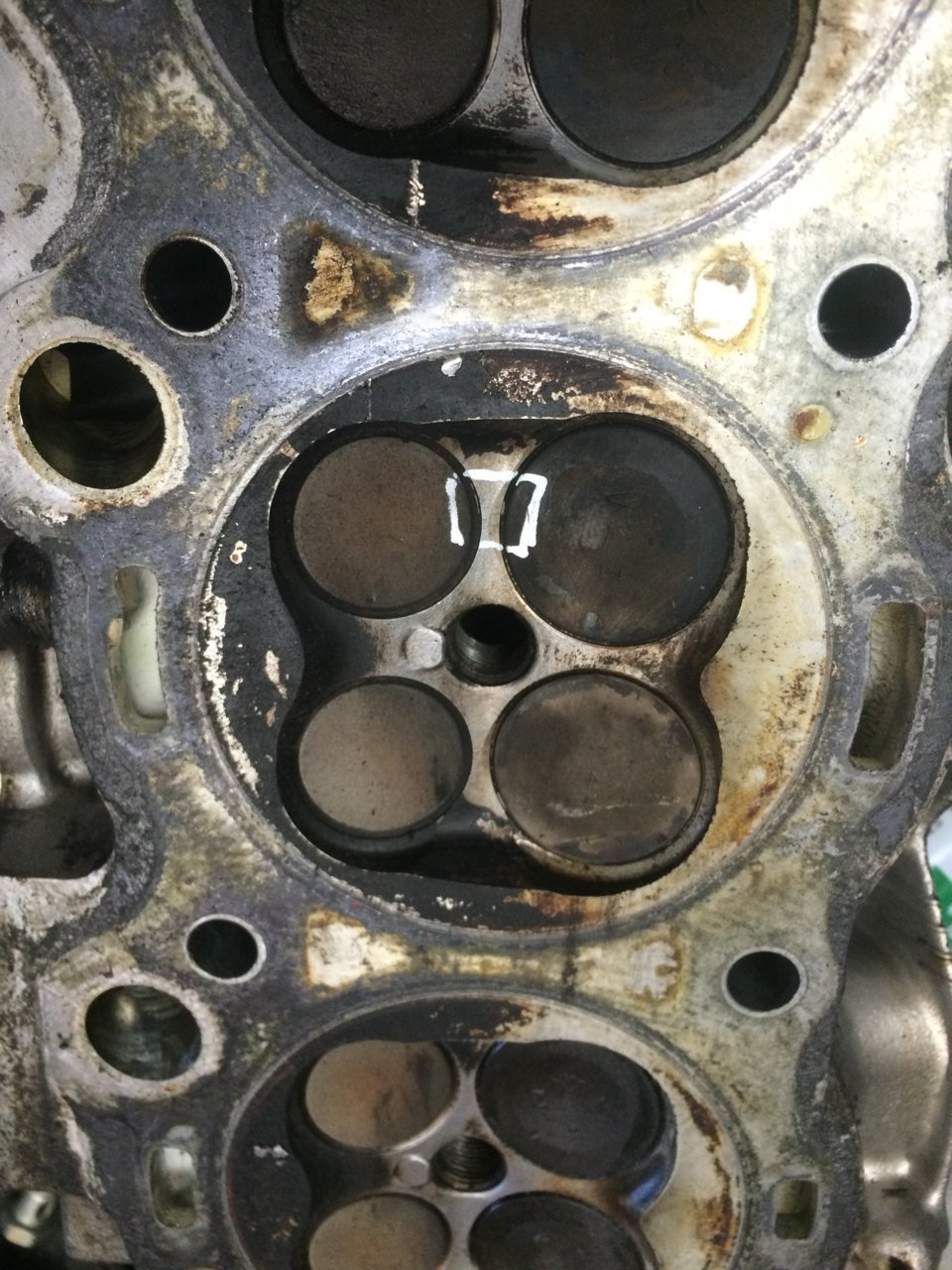

    I stopped reading about a third of the way through when you started saying there is loss of coolant but the leakdown and compression test showed fine.
    This sounds very similar to what I had with my 1st gen when I bought it. Heads are cracked and are letting coolant into the exhaust and into the cylinders. That's why when you start it up it's super rough until the spark plugs heat up and the coolant burns off through the exhaust system in that sweet smelling white cloud.
    Good luck.

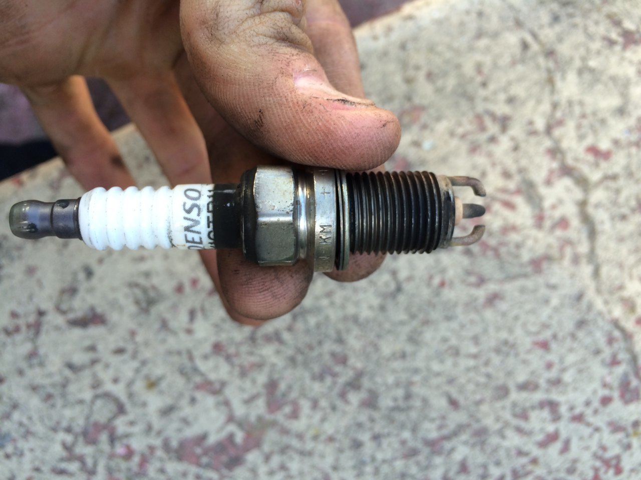

    Out of curiosity- are you running single electrode spark plugs for a specific reason?

    Only because I was too stupid to notice the blue sticker right on the engine shroud telling me to use duals! LOL
