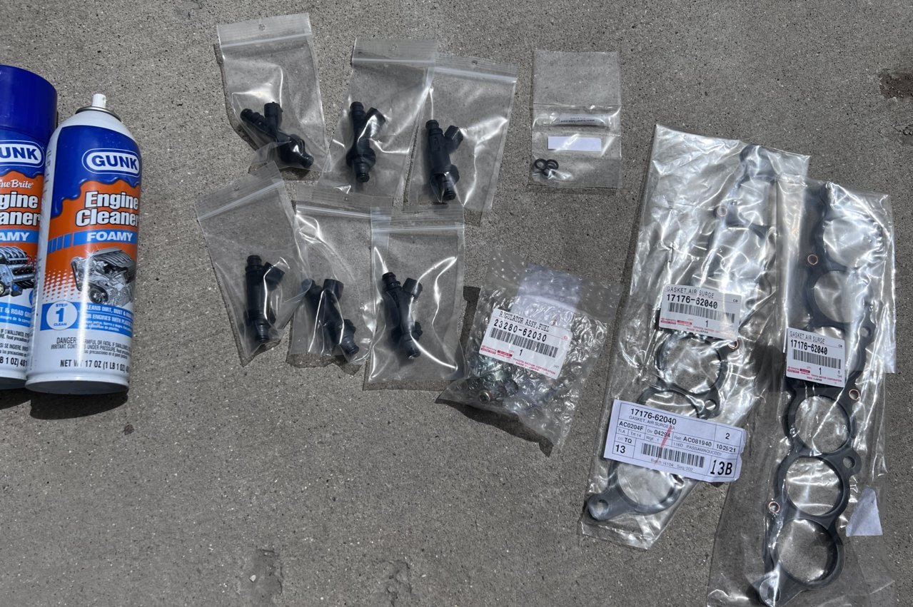

    I decided to buy these upgraded set of fuel injectors from Motor West Performance instead of rebuilding mine.
    Will snag a pressure regulator too.

    My new injectors arrived yesterday. Still waiting on the FPR.

    All the parts arrived… upgraded injectors and FPR. As soon as the engine cools down I’m diving in.

    Welp. After work today I dove right in and replaced the injectors and the fuel pressure regulator. Cleared the P0171 engine code, and left for a test drive.
    Truck definitely accelerates much, much better. Glad I did the injectors. But, after 5 minutes, the CEL came back on. P0171 code is back "System too lean".
    So back to square one on this damn code.
    In addition to the fuel injectors and the fuel pressure regulator, I have also done the fuel filter, and I have done the mass air flow sensor twice. The last time I did the MAF sensor was 12 months ago, and so it could be dirty. I'm going to pull it and clean it off right now, and leave the K&N filter off for another test drive.
    I've searched for vacuum leaks and found none.
    Other possible culprits - upstream O2 sensor... maybe the fuel pump?
    Any other ideas? I'm really struggling with this one.
