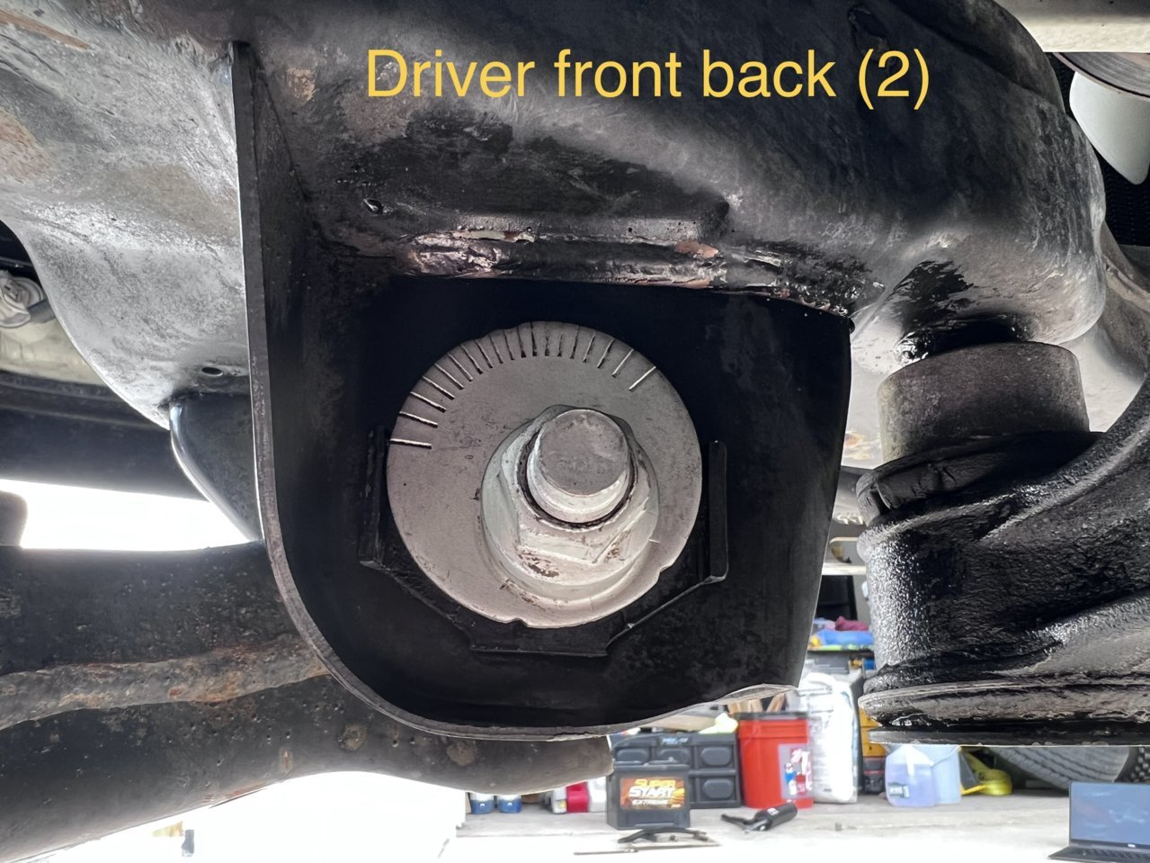

    You really screwed the alignment tech over by not marking your current position and thinking that aligning to neutral is a thing.
    At a minimum, you need to get the camber(90) and toe close before you can drive it.

    i have labeled photos of the cams up close with at each of the eight positions, like this, below. I can set them to the same locations before I button it up and take it in. Hopefully that will be good enough.

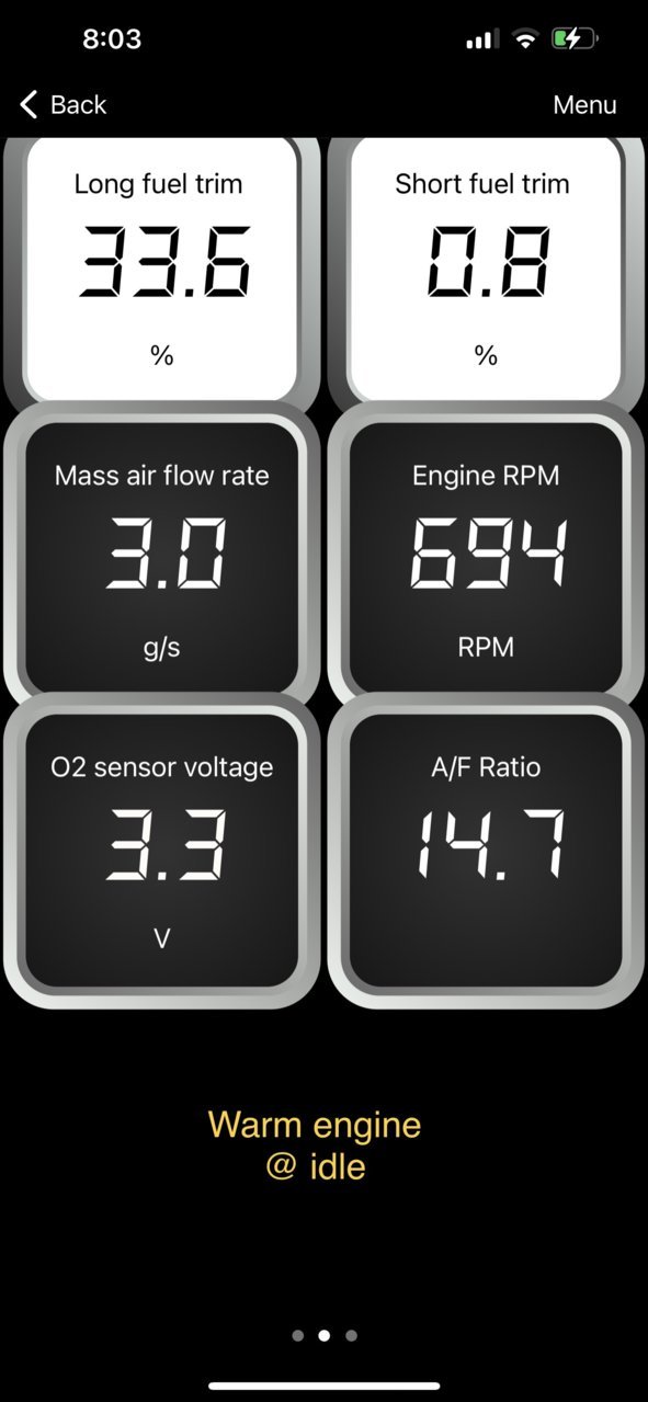

    Warmed up at idle:
    As you can see, at idle my ST + LT fuel trims are around 34%.
    sensor voltage at 3.3 is stoic, also verified by the 14.7 A/F ratio.
    And MAF at 3.0 is right where it should be.
    So the trims together should add up to about 10%, so they’re way too high.

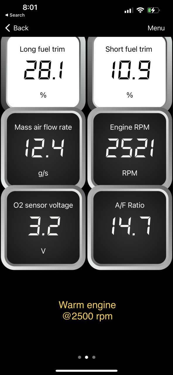

    now some readings at ~2500 RPM:
    So the readings for everything stay pretty consistent except the trims get WORSE at 39%.
    in that video, the guy says if you increase RPM and trims get BETTER, it’s likely vacuum. If trims get worse at higher RPM, it’s either fuel delivery problem or mass air flow problem.

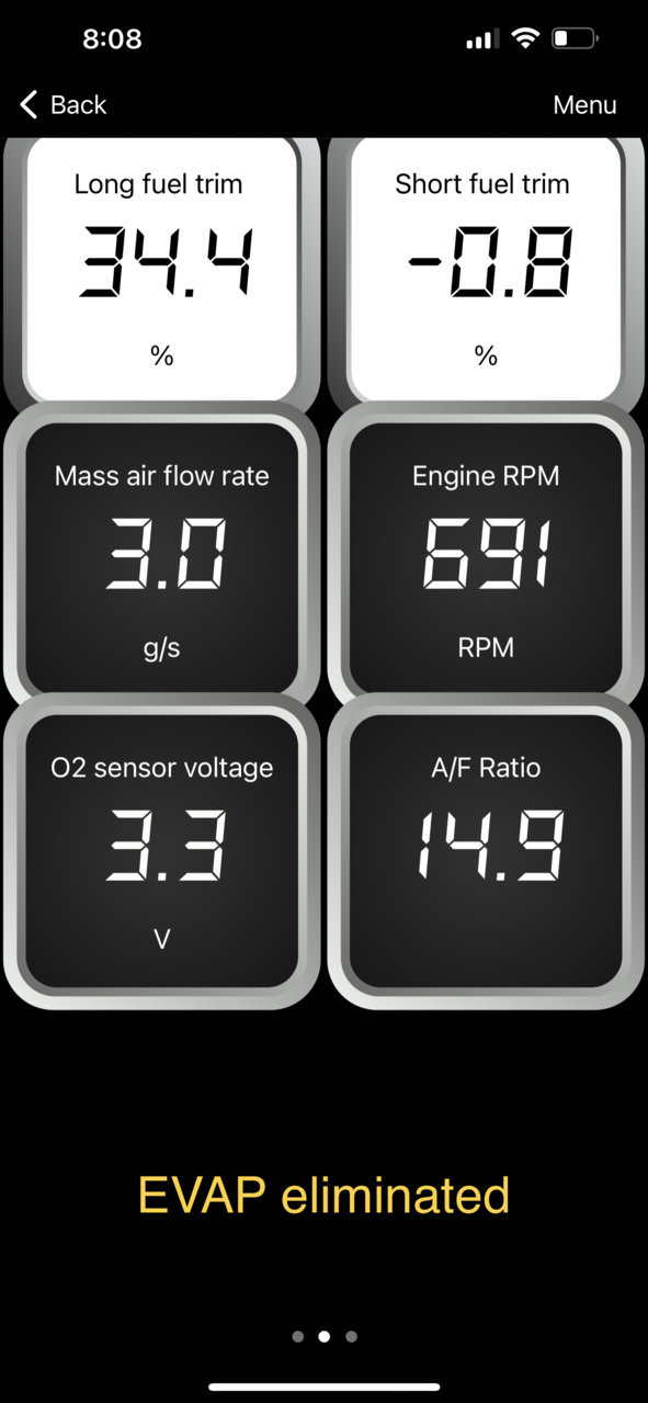

    I also wanted to check just to be thorough if there was an issue with EVAP or brake booster. So I copied his steps and disconnected the EVAP going to engine and plugged it to maintain vacuum. No change in trims.
    Idle trims still at about 34%. So EVAP system isn’t a problem.

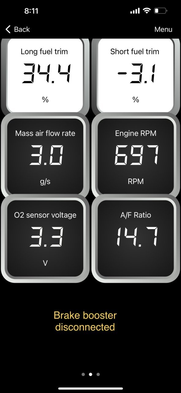

    next to disconnect brake booster and plug vacuum and check trims:
    so technically the trims are at about 31% with brake booster disconnected, which is a 3% improvement but that was just a glitch with the timing of this screenshot because the short term fluctuates so fast. Over time it was still ~34%. So brake booster isn’t my problem.
