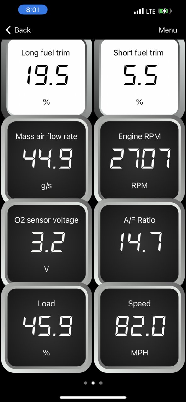

    New Toyota MAF sensor installed.
    Warm idle in driveway in 78° ambient temps it’s running combined fuel trims at about 26.5%.
    At ~2500 RPM the fuel trims increase to a combined 33%.
    So that’s a slight improvement but still way too high. I believe combined fuel trims should be around 10% for a healthy running engine, yes?
    I also tested vacuum again. Vacuum at idle is about 15-16 in hg. With evap or brake booster disconnected the vacuum is the same.
    I think I need to test fuel pressure again but do it under load. When I tested it before I had 44 psi. But I didn’t check the pressure under load. Can I test load just by revving to 2500 RPM? Or do I need to be driving around with a gauge hooked up?
    Could a dirty throttle body or IAC contribute to high fuel trims / lean condition?
    Dunno. Not sure where to look next. It could maybe be the fuel pump. That’s about the only component I haven’t replaced. I don't think the brake booster is culprit - it didn't change vacuum when I disconnected it, neither did the EVAP.
    Unless the supercharger is somehow causing a problem ??? Maybe it's not producing boost and so therefore is actually creating drag? Just a theory.
    I am searching eBay for a complete 5VZ intake plenum, air intake box and elbow.
    I'm also going to try another smoke test. Maybe I missed something. :annoyed:

    Been out driving it. The code cleared itself.
    fuel trims at highway speeds around 26%

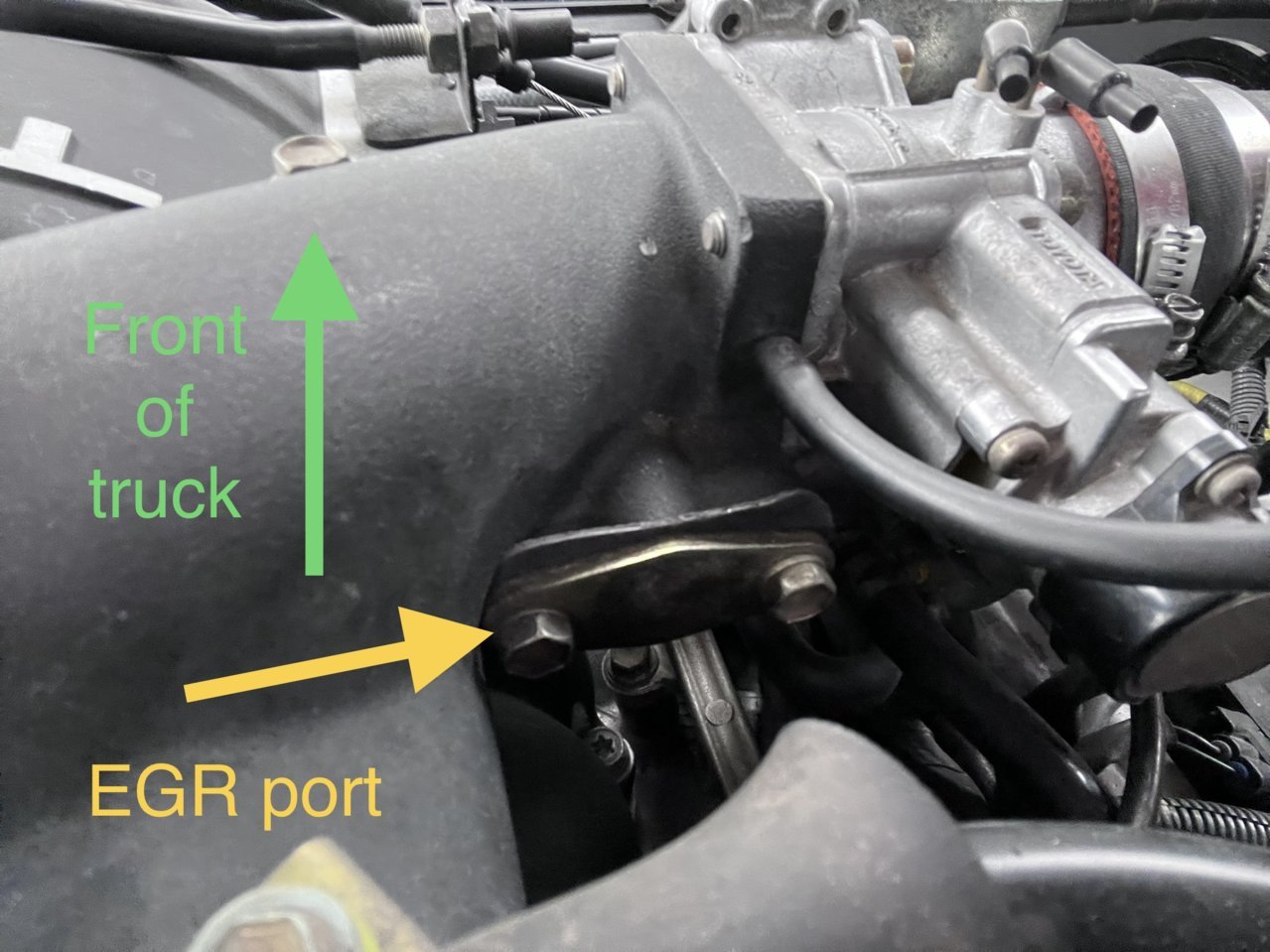

    Is the egr port on the back of the supercharger capped? If not it will cause it to run lean and throw the p0171 code

    the EGR port is blocked off with the factory plate. It has never been removed.
    eon_blue[QUOTED] likes this.
