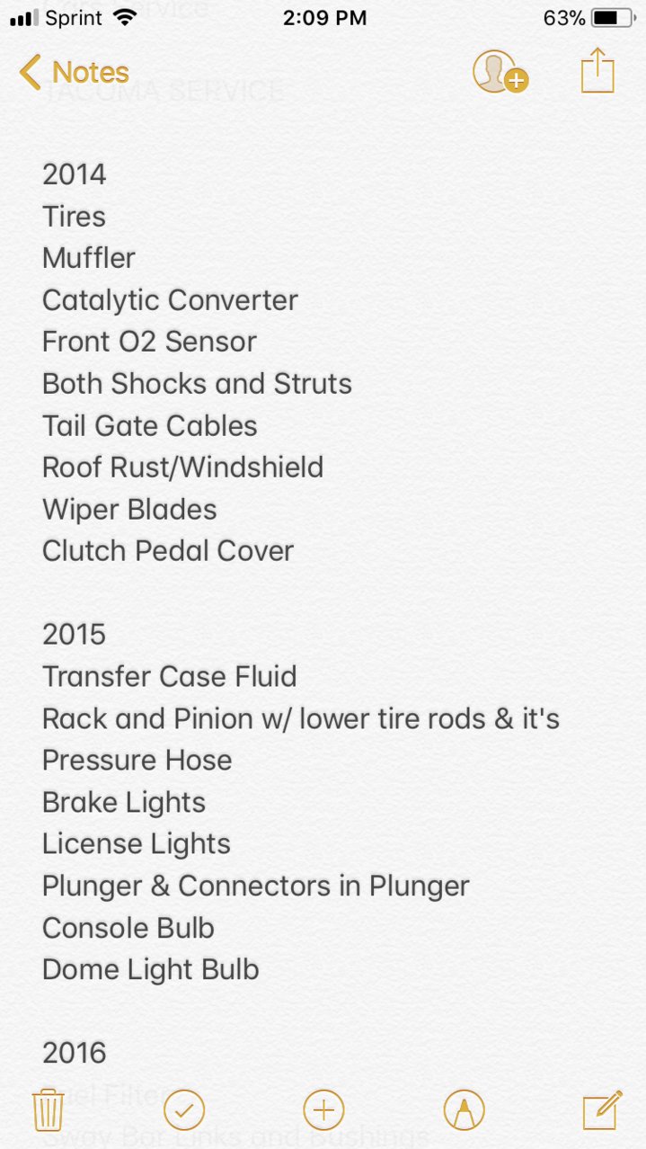

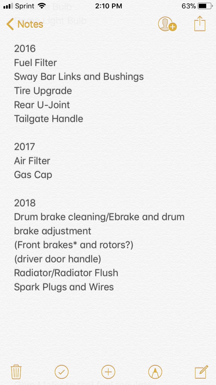

    Man oh man...people say my truck looks great. The only issue I know besides what’s going on right now is a rear main seal leak that is very manageable. I’ve attached images on what I’ve done with the truck since purchasing it in 2014. So it could be more than a head? They are going to call me back for quotes. I need to make sure they ran everything I guess but if it’s the same code and that’s the compression test results than it must be the valve.

    Looks like you've addressed a lot of wear and age parts. I didn't see ball joints or wheel bearings, but I can't think of a ton of other things. Looks like you have a manual transmission, so doing the rear main seal when doing a new clutch makes sense unless it gets really bad, so you can wait on that until you need a clutch.
    I would wait to see what the shop says, but with its age, needing a valve job is not a big surprise. That may be all it needs. They could quote just a head gasket, get the head off and see that it needs the valve job, so you need to be prepared for the full valve job. Hopefully they can get it done locally for cheaper than getting a remanufactured/rebuilt head, but it will probably take a few days. Injectors may eventually fail, but #2 injector just doesn't sound right for what you are seeing.
