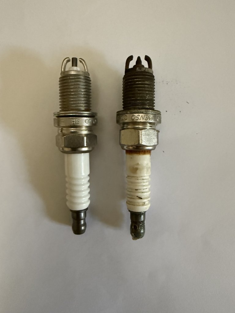

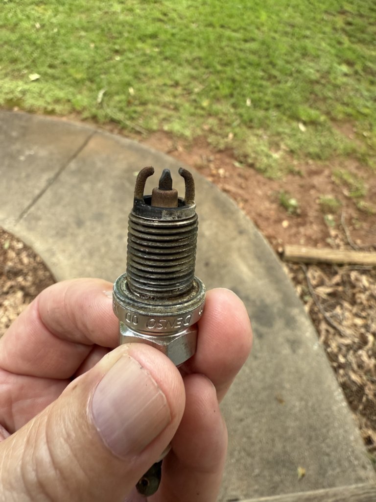

    I got a little time pulled no. 2 spark plug no signs of antifreeze so I’m leaning towards the fuel injector.
    After I put the one plug in I drove it for about three miles ran perfect. I parked it went in the house for ten minutes came back out missing again.

    Leave the plug out, pressurize the cooling system and check for coolant mist or dribbles going into the cylinder

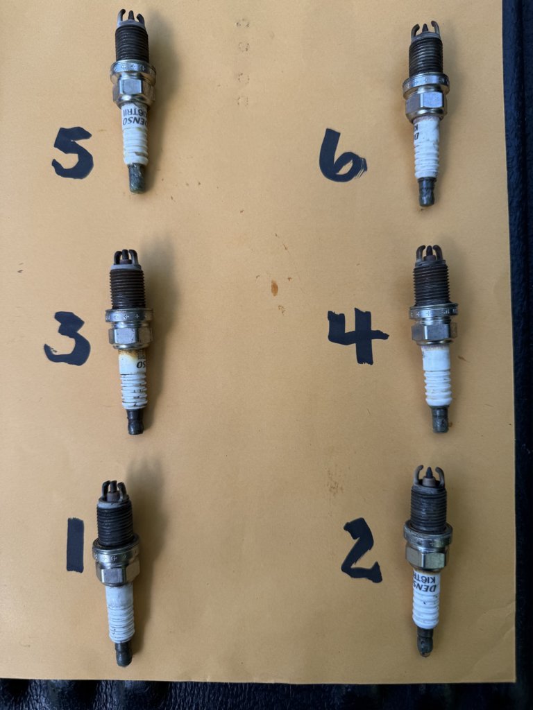

    Update: replaced all the spark plugs this morning and they all appear to be burning exactly the same so I’m thinking more towards the injector on cylinder #2 intermittent misfire instead of blown head gasket.

    I like how all the threads are gummy / dark, theres no way you have an issue in every hole, so thats a good sign.
    can you lift the injector out & leave it attaches to the rail, just turn key on to pressurize system & see if over time the injector is dripping fuel?

    I remember using anti-seize on the plugs so that’s probably what is causing the dark threads.
    I have to pull upper and lower intake to get down to the injectors so not sure which way I’m going next. I may go ahead and do a leak down and compression check on #2 before I proceed.
