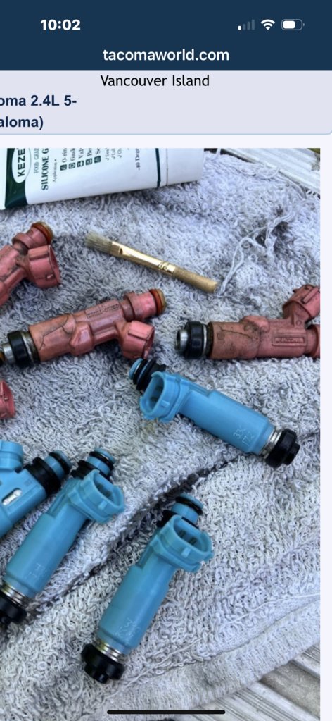

    I really like what Slater suggested
    Pull an injector and see if drips after shut down
    Or could be a visual inspection
    Very recent thread…
    Look at the red (old) compared to the blue(new)
