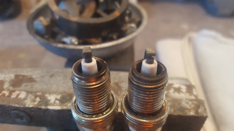

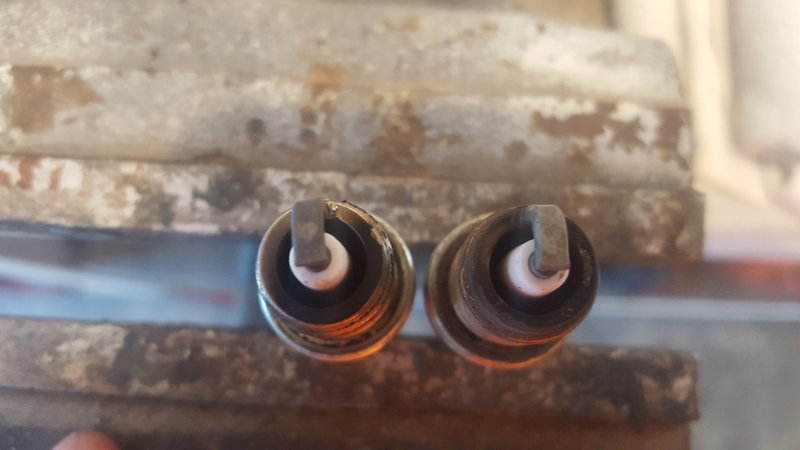

    Been working out of town for the last few weeks but got a chance to come home early this week and decided to pull the plugs to see how they looked.
    Cylinder 3 is the right plug
    It doesn't look "washed" to me. Also did not smell any different than Cylinder 2 on the left. These have about 500 miles on them.

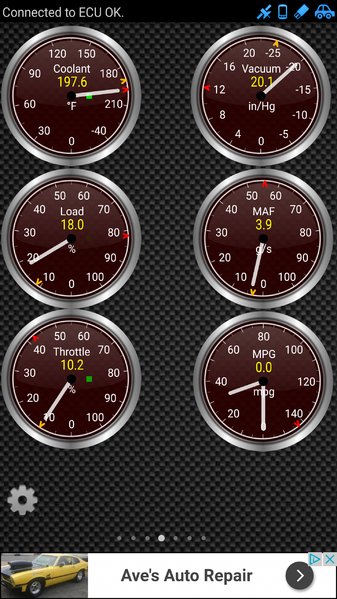

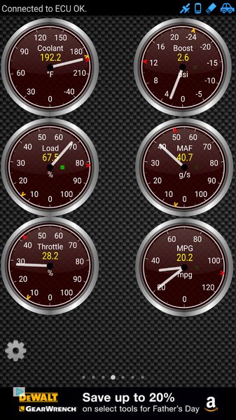

    Just for kicks and giggles, here is what my OBD2 reader is showing at idle and cruising at 70
    I still have a hard time believing that its a leaky head gasket, but the scenario of sitting, coolant sits in cylinder, misfires til coolant evaporates, runs fine is still a very good possibility. Just not seeing any smoke out of the exhaust.
    I guess im just going to have to bite the bullet and treat it like a head gasket and tear it apart. Just can't imagine the feeling id have if i did that and it was fine.
