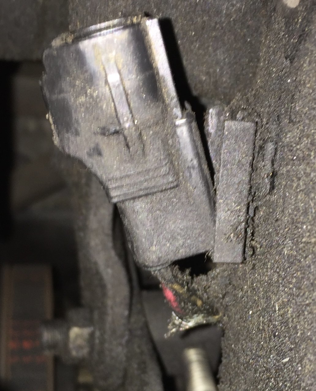

    Okay so found this when searching for the camshaft position sensor and appears this might be the problem. Surprised a code didn’t pop up. I put an ohm meter on the connection and reading bounced all over the place!
    Any advice on how to replace? I’ve managed to loosen the timing belt cover but had to stop given no method to catch radiator fluid when removing hose. How much fluid will come out from the block when removing the hose? Thinking a funnel and 5 gallon bucket might do the trick to stock fluid from going’s everywhere in the garage.

    Are you saying your cam position sensor wasn't even connected? in your original post, you admitted to running the engine with the air intake off. Did you remember to plug your MAF sensor electrical connector back in?
    If your coolant is newer, drain some of the radiator coolant into a clean container so you can reuse it. Compress the upper radiator hose constant tension clamp on the engine side of the hose and move it back around 6 inches. Take out all the bolts that hold the timing cover on (the bottom left is the hardest to get to), and then you should be able to move the cover back far enough along the upper radiator hose for you to access the cam position sensor to replace it. I've never tried replacing a cam position sensor like this but I imagine it will work. If this doesn't give you enough room, you could remove the upper radiator hose and get the cover completely out of the way.

    I unplugged it before taking photo. Hard to see but one sensor wire is spliced and connector to timing belt cover is broken. Most likely fired up as the wire was still hanging by a couple threads.
    MAF sensor connected each time. Hoping to check spark based other responses but couldn’t crank engine and see it at same time. Given camshaft sensor controls ignition firing timing hope this is fix.
    Correct in that not much room to work. Trying to avoid a mess with radiator fluid in the garage.
