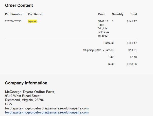

    I've been chasing similar problems on my '95 3.4.
    Did the the plugs and coils. Still getting misfire. Traced to injector #1. Replaced it with OEM ($$ ouch). Then got lean code. Cleaned the MAF.
    Also reassembled the shitty K&N CAI. It wasn't fitting together too well.
    Reset the ECU with a battery disconnect.
    No more lean condition.
    Now I've got a misfire on #5.
    Somebody suggested a bad fuel pump. I did run a can of 44K through her back when all this mess started.
    My vac hoses are pretty crusty. Time to tackle them before I go back in after yet another injector.
    Good luck to the OP. These problems are such a PITA.

    And here's the real kick in the nuts...
    Best price I could find. And again, that's for a '95 3.4.
    cruiserguy[QUOTED] likes this.
  18. Jan 1, 2020 at 10:43 AM
    #38
    cruiserguy
    cruiserguy Well-Known Member
    Jul 31, 2016
    #193416
    19,000
    Elijah
    SEKS
    2000 ext cab, 2.7L, auto, 4x4
    Sheesh.
    I wouldn't hesitate to run a true oem rebuilt injector that's been rebuilt and flow tested. Some places online even have a little bit of stock where they'll send you the warranted guaranteed rebuilds and you just send yours back as cores after you get the new ones installed.
    At those prices for a new injector, it looks like the rebuilds will be the route I go when time comes. My Taco is just a work truck fortunately.
