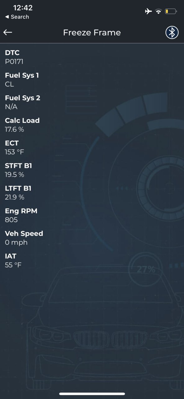

    Thanks! My wiring harness is totally cracked and almost 100% of the OEM harness is gone.
    Since my last post I gave my MAF a really good cleaning once again; No change to the CEL code.
    By the way, I learned how to use the cheap scan tool I picked up and got this data about fuel trim, etc.
    To be honest I'm not really sure what this means, does this indicate anything to you?

    Your short and long fuel trims are very high, they should be around 0 at idle or plus and minus 10 when driving.
    Yours are at 19 -20, that’s when you get a code.
    This can be from a hand full of things.
    Fuel pump,
    Fuel filter
    02 sensor
    Fuel injectors
    MAF sensor
    Exhaust leak before the 02 sensor.
    ANY VACUUM LEAK

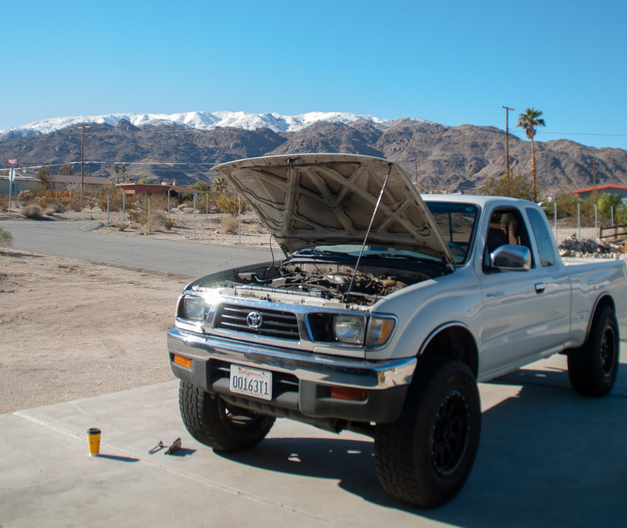

    Been a little busy lately, but I finally stopped putting this off and found the time to address the issue. Last weekend I got the truck smoke tested and confirmed my fears following the original fuel injector replacement. The injectors were not properly seated, which was causing the vacuum leak. Yesterday I started working to address the issue. It didn't start well, since I snapped the fuel rail (tab that is bolted down to the engine) while I was removing it. But I was lucky enough to find one in good shape at my local junkyard out of a 5VZ 4Runner. So I completed the work today, this time sure to fully seat the fuel injectors. I didn't realize how hard I needed to press to get them in place! It took some serious elbow grease. After buttoning it back up, it started easily. It seems a bit quicker to turn over than before. Took it for a drive about 50 miles. It's the first time my scanner is showing green "0 DTC" after clearing the codes, whereas previously it would show a yellow LED and then soon after the CEL would come back on. It seems to be doing okay. My only concern is that I can still hear some knocking when I'm sitting inside the cab. I'm not sure if I'm hearing things or if there's definitely a problem still! Hope it stays running well and doesn't throw a code for this again!

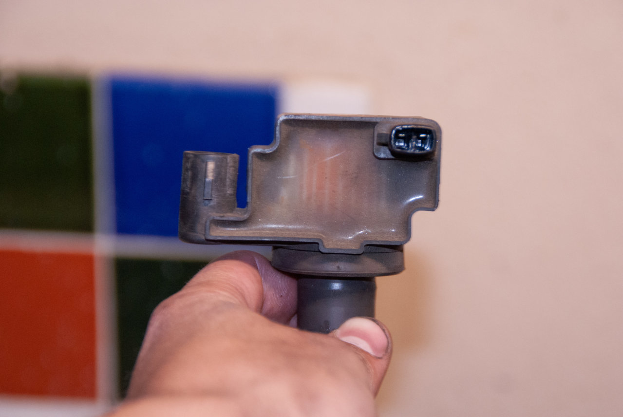

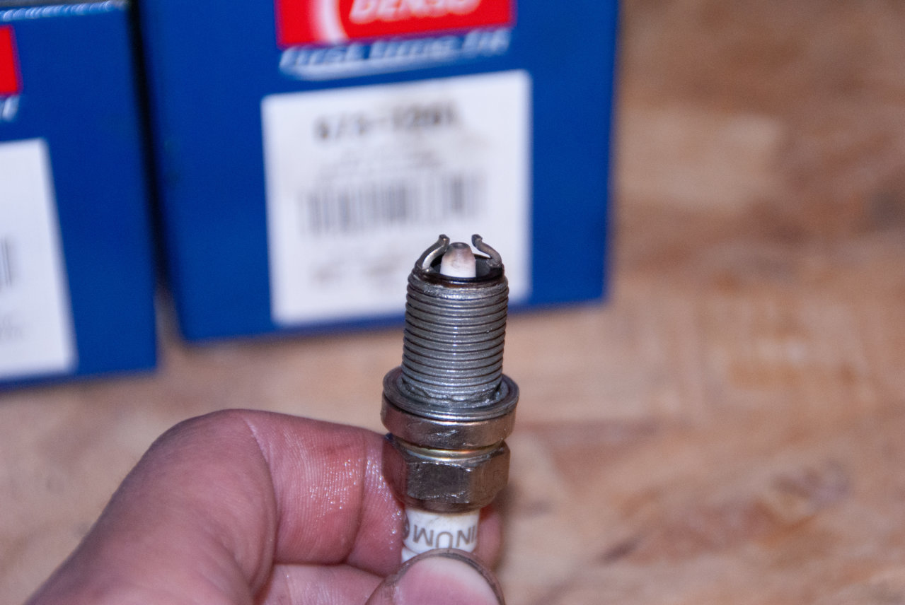

    Revisiting an old thread here-- my CEL came on last week ( P3030 cyl# 3 misfire) I replaced all 6 sparkplugs and new #3 ignition coil, cleared the code but am still getting misfire. Strange thing is that misfire doesn't happen right away, truck starts all fine in the morning, I would go to a location (work, grocery shopping, friends house etc..) parked, then when I go to start it up, truck shakes in idle and while driving, which feels like a misfire issue. I don't think it's Fuel injector because that would happen consistently not intermittently, maybe Im wrong?
    Results (psi) from Compression Test today:
    1: 220, 3: 215, 5: 220
    2: 205, 4: 185, 6: 195
    Are those reasonable range of differences? Truck is a '99 with 165k miles I use regular 87 octane. I would like to not replace more parts that I dont need to, can anyone give me advice on what else should I be looking at next? Thanks a lot in advance.
