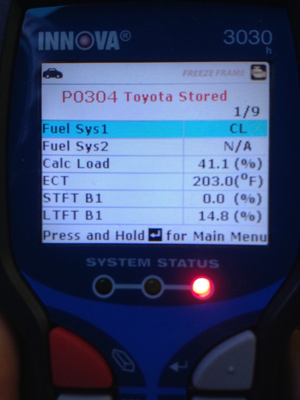

  8. Feb 17, 2019 at 4:18 PM

  9. Feb 17, 2019 at 4:47 PM

    New plugs and wires? Did that fix it? If not, try swapping the coils to a different cylinder first. While you have them out test them with an ohm meter too, it’s super easy and pretty quick and definitive. (Mark their original position.). I’d eliminate spark before I go fuel. Then reset your ECU, and see what happens.
    I can email you the PDF from the factory service manual if you need diagrams...
    I’m not to familiar with those readings on the scan tool. Sorry.

    It's running super lean, check the intake tube and the plenum for vacuum leaks.
    May need to figure out how to hook a fuel pressure gauge up.

    Why do yo say that? I had the intake tube off to change plugs and it appeared fine.havnt checked the plenum.I find it weird I can drive it for hours with no issues then after shut off for 10min or so,the problem arises.And why it went away on the drive home is strange.Anyways,I’m going to give to a mechanic.
    I should mention that I had a 0171 code come up a while ago.I cleaned maf sensor,throttle body and new fuel filter and it seemed to solve the issue.

    Bishop is referring to the fuel trim info on your scan tool. (I just googled STFT and LTFT... because I didn't know what that was.) Here is some info that came up. This is all news to me and pretty cool information. What scan tool to you have? I'd love to have that same information...

    Thanks,I’m learning this stuff also....or trying to,lol..
    Scan tool is a Innova 3030

    LT 14% means its adding 14% more fuel then normally set, this means lean.
    Ideally you want +/-10%, anything more can trigger codes and implies a fault.
    With lean, it can be a MAF, vacuum leak, fuel injectors, fuel pump, or valves. Also failing o2 sensors but less likely.
