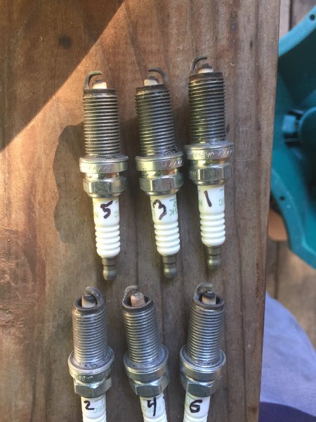

    Ok, I'm going after it today. I pulled the spark plugs with some interesting results, see picture attached. #4 plug looks cleaner and brownish when compared to the other five which all have black burn marks and are more grayish in color. As far as gapes go, #1,#3, and #5 were all 0.059. Driver's side however... #2 is at 0.055, #4 at 0.061, and #6 at 0.060.
    To me, this all but confirms my initial dread that it's my HG. I'm about to compression test to confirm before I start taking things apart. Any tips or strategies for head removal that come to mind would be appreciated!

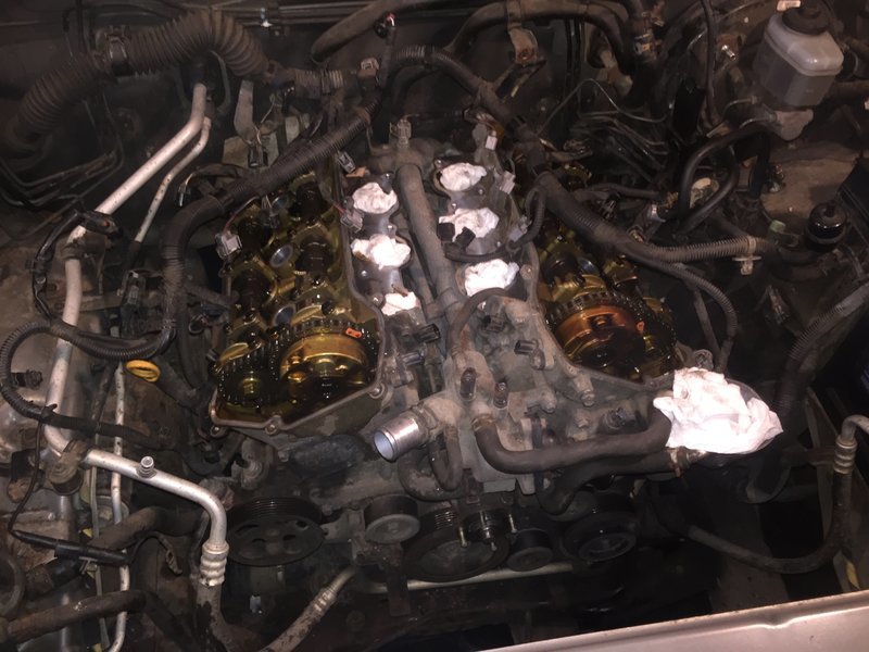

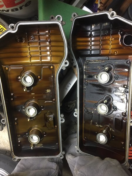

    Oh yeah, pictures! Doing my best to label and stay organized as I go, but promptly starting taking pics when I saw your post, thanks for reminding me. I'm hoping the master gasket set has the rings but I'll double check. Adding thermostat to the list.
    Pics is where I got after day 1 before I met my quota of f****** plastic clips. Radiator was the worst part so far, the mounts were frozen and I had to break 3 of the 4 bolts to get the thing out. Still have the crank pulley to do, and the exhaust manifolds look like they are really gonna be a pain.
    Interesting to note in the picture that the drivers side seems to be noticeably darker. Has me a bit concerned the right side got oil starved.
