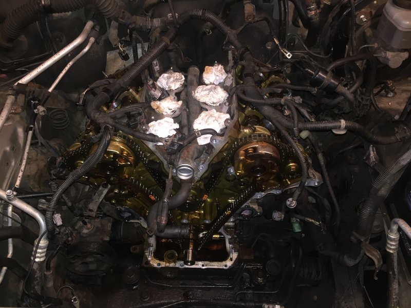

    At this point, if you haven't already, I'd turn the crank to get the timing all lined up. It will really help future you. As well as remove those two studs directly over the oil pan machined face.

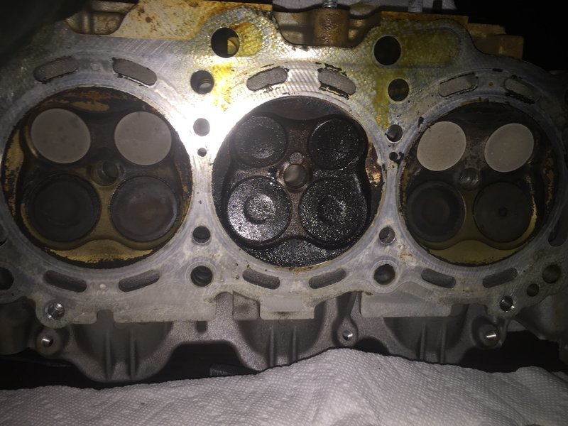

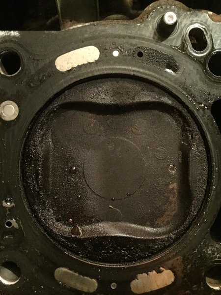

    Timing lined up, more pictures taken, now off with them heads! I've read about removing those studs, doesn't really look possible to get a good seal without removing them! And thank you again for the pointers, all help is appreciated. What do you think I should do about carbon deposits on the pistons? I'm a little scared to start scraping as I don't want to scratch the bores or the machined top of block. Should I leave them alone? Soak in some sort of chemical? Turn the crank to bring each piston to the top, then very carefully scrape off the bulk of the deposits? IMG_6743.jpgIMG_6721.jpg

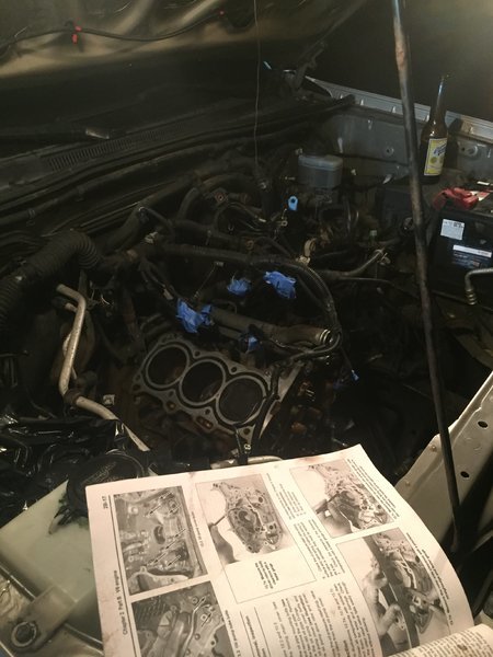

    Basically just going at it. No youtube- just my manual, this forum, and several 12 packs of beer. Although it helps that I rebuilt my Corolla engine couple years ago, but I used the same approach that time as well. I've got lots of pictures, anything you want to see in particular? All the pictures start looking the same to me... Will post parts list with breakdown tonight, but I'm about $2500 in so far, all OEM parts from the stealership.

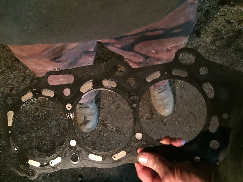

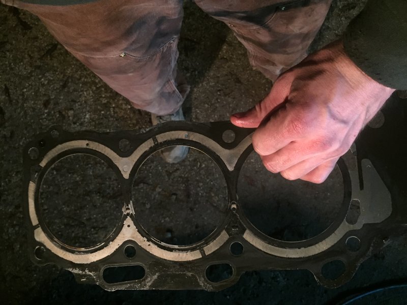

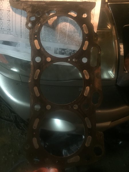

    IMG_6763.jpg Good gasket....IMG_6728.jpgBad gasket!
    TRDoggydog likes this.

    Is it an optical illusion or do those valves look different?

    are you talking about that center, round, indentation?

    Yes, like the good cylinders don't show the indentation. Is it due to light/camera angle or are they in fact different?

    I think its the camera/angle/lighting/your eyes/your monitor/

    The OEM intake valves all have those indentations. Just the flash.
    Those head gaskets let off a LOT of material. Wow. Even between cylinders, in your second to last picture.
    Just wipe the pistons clean as best as you can, to remove and loose carbon build up. If you can clean the valves of any large build ups, that'd be the best.
