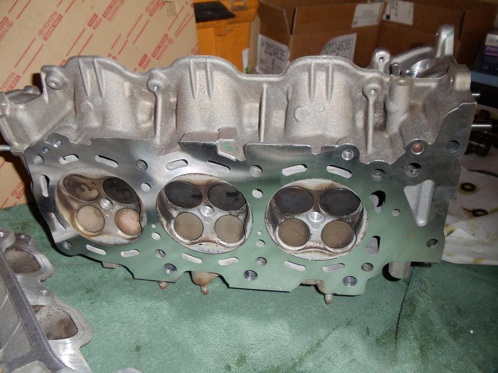

    From this:
    To this:

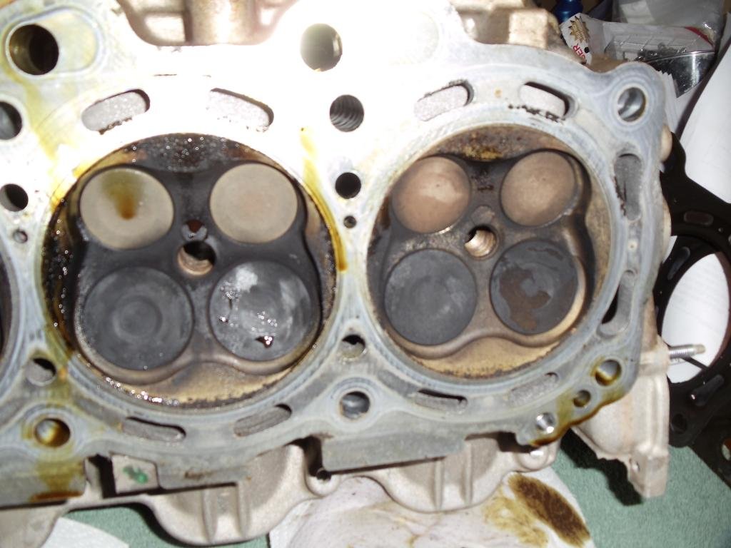

    DSC01759_zps47d7fc2a_399e1ddb46a9e3211cb66d311ef2158bfc118d53.jpg[/QUOTE]
    The machine shop's make things look pretty! I dropped my heads off this afternoon, hoping to pick them up tomorrow. I asked for the IIRC (do I have that correct?) to be checked, clean them up, and pressure test. The machinist will call me tomorrow and will decide whether to take the sealing surface down and replace seals (I will likely have this done, I gave them the seals from the master kit while dropping off). I also gave them the timing cover, it needed a bath.

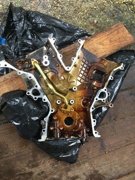

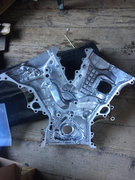

    Here is a clearer picture for reference. There are three, or four, machined spots where the timing cover bolts to the center of the block.
    Three are under the chains idler pulley, and I believe the other is near the driver head oil port.
    Don't forget to hit those with silicone as well.

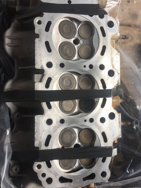

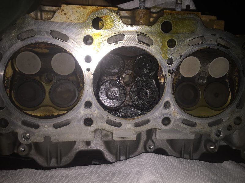

    Picture time:
    Before:
    After:
    Fresh out the machine shop. I got lucky, I think they forgot to charge me for the parts cleaning... $125.00 out the door from the machine shop. Heads were pressure tested, no cracks luckily. Had them R&R the valve stem seals, but no valve job. Hehe, valve job. Made me laugh when they asked me if I wanted a valve job. Interestingly, the machinist told me these heads cannot get lathed on the HG sealing surface otherwise the valves will contact the pistons. I told him others have had it done without any problems, but he said that he knows from first hand experiance that it shouldn't be done on these heads. I do trust him somewhat as this machine shop is the one the Toyota dealership send their heads to get worked on. He said Toyota specs allow up to 0.004 out of flatness, and mine were not out of spec. When I did my car, I had bolted on a "fully remanufactured head" from a reputable shop, and ended up ripping them off again because the pistons contacted the heads, so I didn't argue with the guy.
    Okay... time to get to work, here we go!

    Parts turned out great.

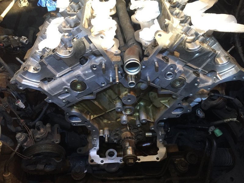

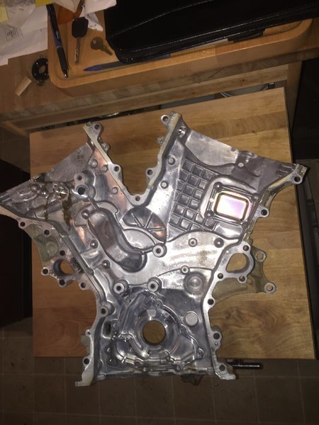

    Just spent the entire day scrubbing sealing surfaces and cleaning parts. If anything leaks, I'll probably blow a gasket.IMG_7073.jpg FullSizeRender.jpg
