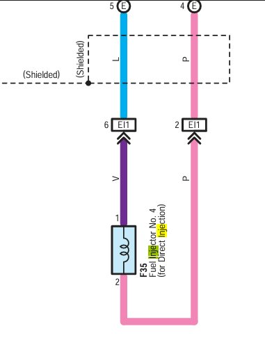

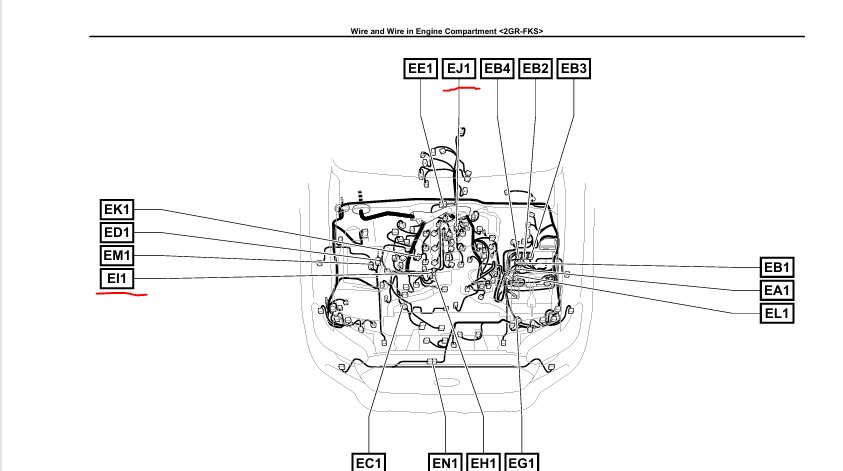

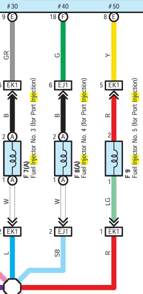

    Injector circuits connect to main engine harness via junction connectors. May need to lift the intake to see check wiring all the way to the main harness. If good, check at what engine load it starts grossly misfiring.
    #4 port connects via EJ1
    #4 direct - via EI1

    Very helpful diagram, thanks. Ive never driven this truck but I do know they told me the last time it was particularly bad was when they were going up a large hill. They described it as “the truck trying to shut off”. As in a huge shudder from the motor and they thought it was going to die. Past that it’s just been described as a constant degraded performance and reduced fuel economy.

    Based in the driving condition it is likely a direct injector. It is a pricy one and need some effort to replace it
    Check if other cylinders on that bank are not misfiring. Check fuel trims.
