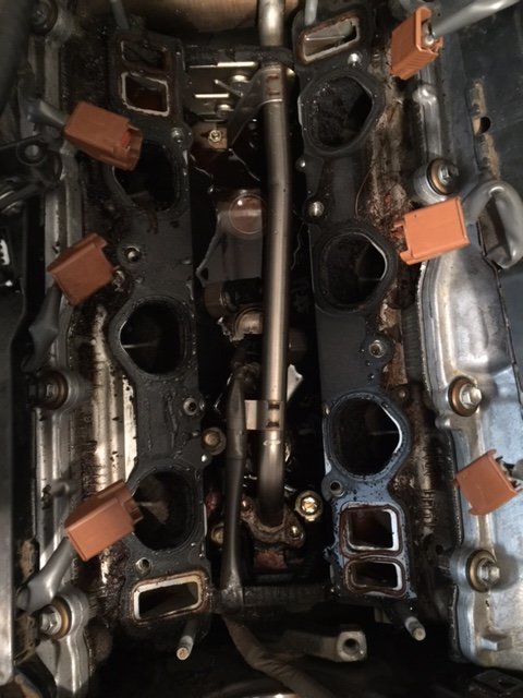

    I have a 99 Tacoma 5vz-fe with about 245k. The truck has had the P0325 Knock Sensor 1 Circuit (Bank 1) code since I bought from PO about 2.5 years ago. I’ve read all the posts and I’m going to get in there and check things out. I’ve got the Toyota harness already and I’ll check the sensors when I get in there to see if they are bad too. I also plan on checking the wiring from the harness back to the ECU. My question is while I’m in there is there anything I should look for, clean, or replace? Anything I should look out for when I can see in there? I have all the associated gaskets, plugs and wires are new, throttle body is clean. I appreciate the help

    If your pulling it all apart just buy new knock sensors.
    Replace the water line that’s under there too that’s runs in the valley

    Re-seal this water pipe with FIPG or equivalent, if you're having the intake off.

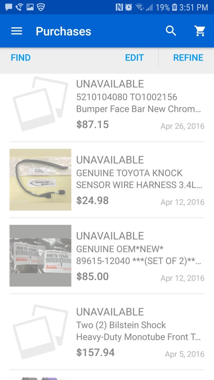

    I bought my OEM Desno off ebay for around 85.00 for the pair, they were sealed in the bag, stamped Desno and have a date code on them that was less than 7 months old which makes them OEM

    Here

    There plenty of fake ones.
    OEM sensors will have a date code stamped on them.
    Make sure they have the code and are sealed in the toyota bag and marked DESNO.
    The part number that I used now 60,000 miles ago is
    denso 89615 12040

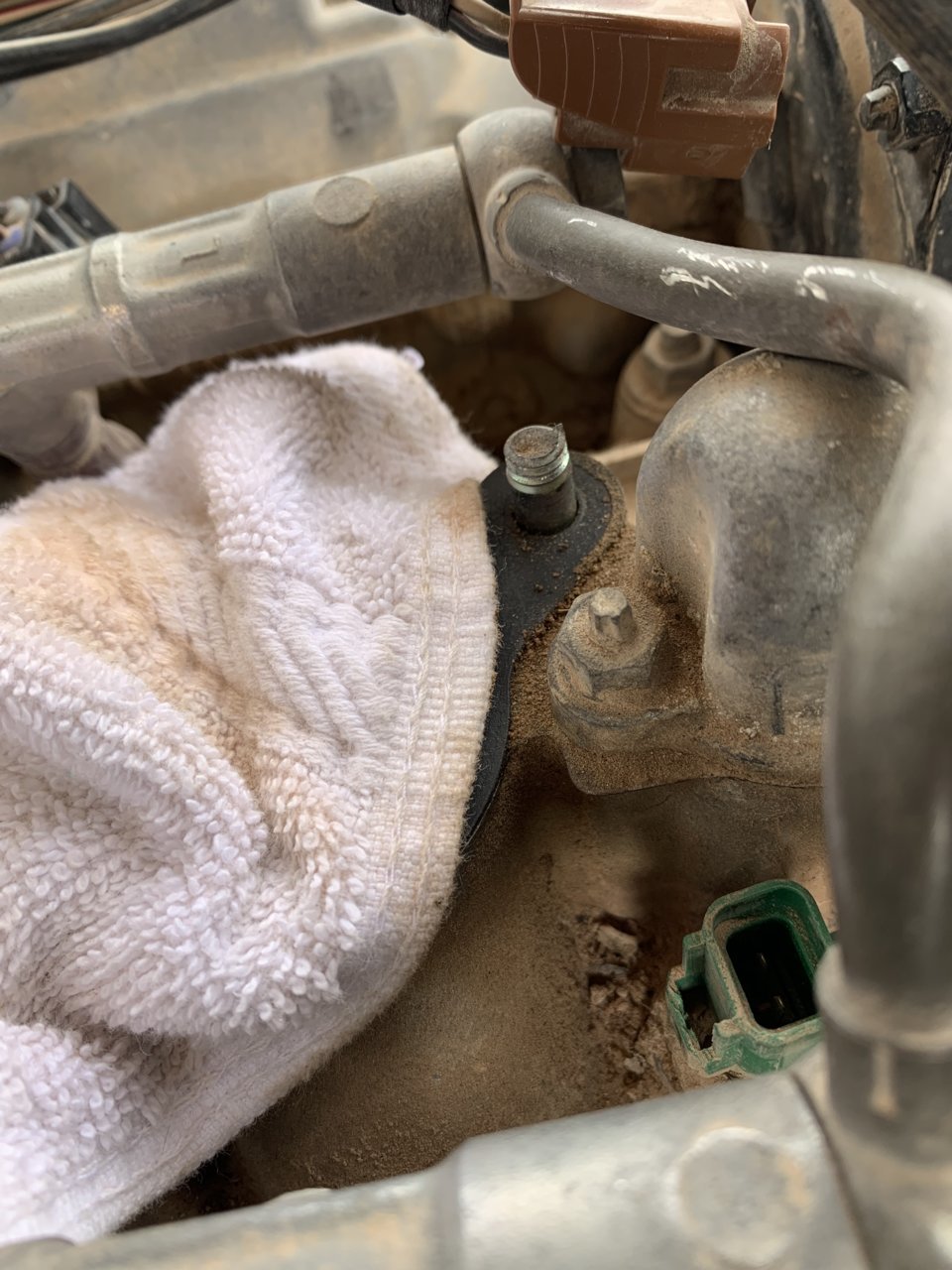

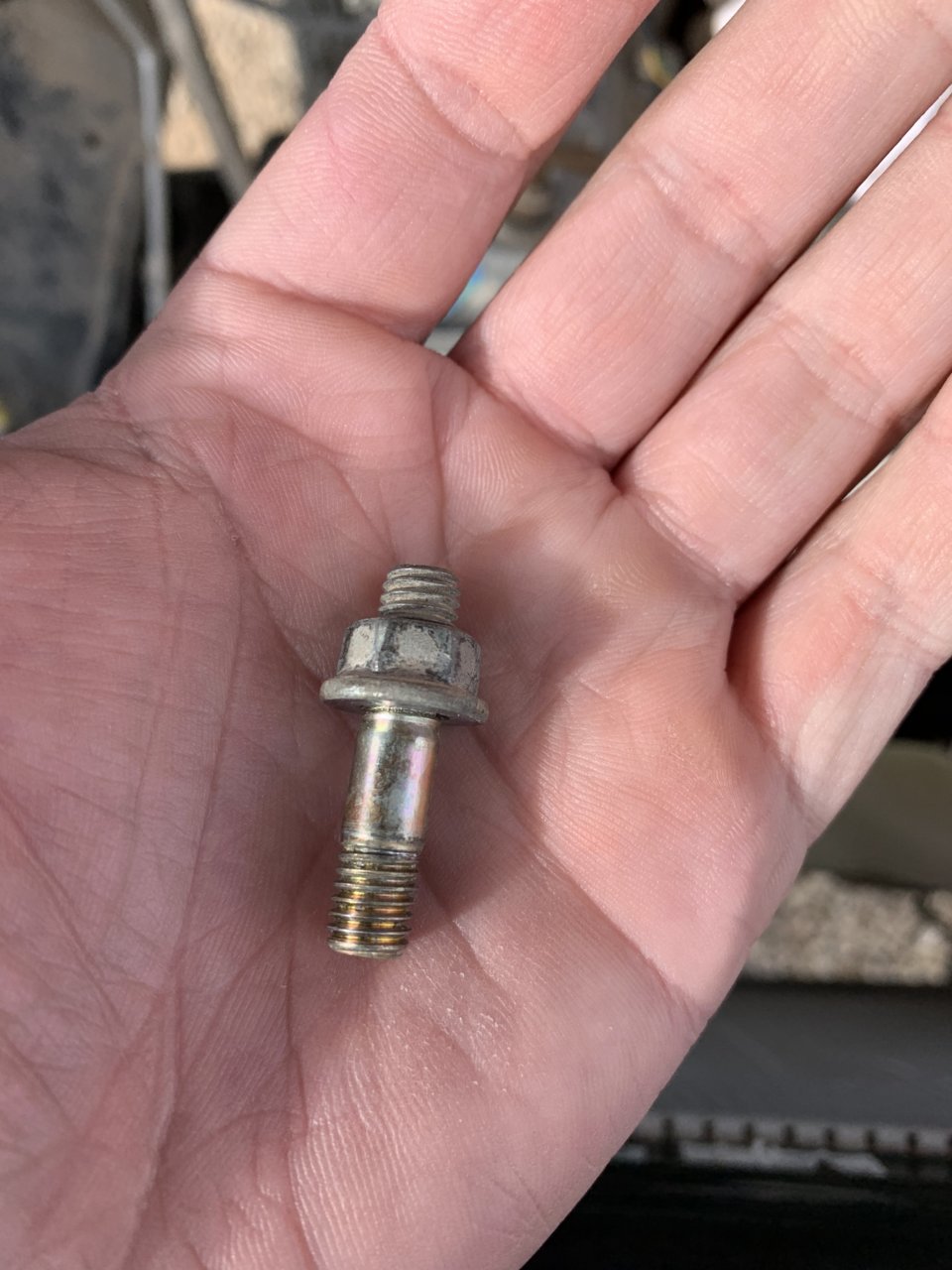

    Anyone have a part number or know where I can find the stud in the pics below? There are two studs that set in the intake manifold and the lower plenum is secured to it by a nut. The front one is snapped and I’d like to fix it

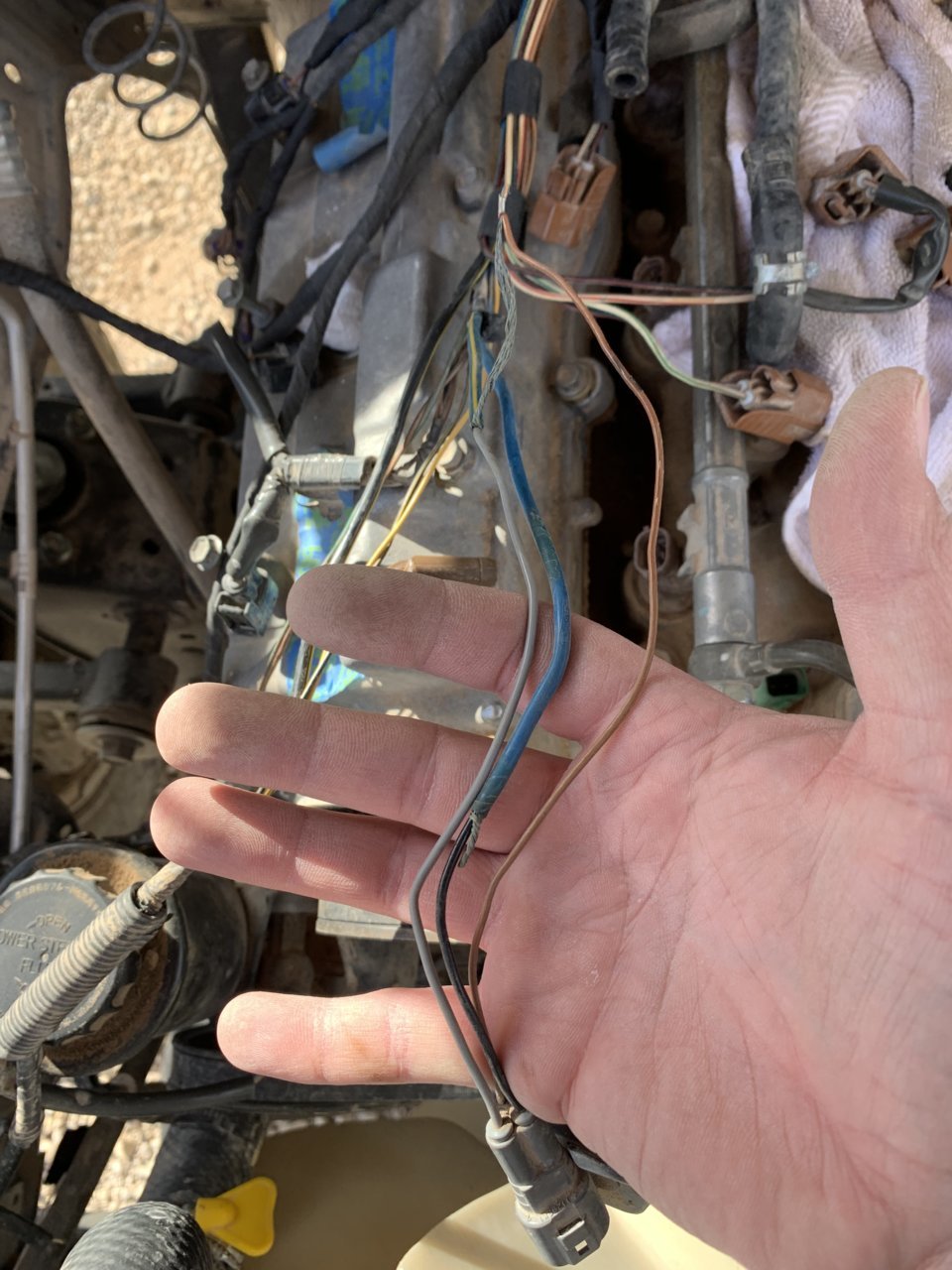

    So while I was fixing the plastic wiring protector that I broke earlier I noticed a splice in the wires. After following them out I found they go to the knock sensor harness. In the pic below you can see the gray wire with the blue-yellow sheath has the brown wire from the harness connector spliced into the bare wire. The black wire with the all blue sheath has no brown wire connection to its bare wire. From my reading the gray wire is sensor 2 and the black wire is sensor 1. I have the P0325 code which is Sensor 1. So I’m going to splice both the bare wires to the brown wire from the connector and I believe that should ground both sensors through the single ground from the connector or would that not make a difference since they both go back to the same place in the ECU.47DF0CC0-DC68-4B2D-A899-7EF1B78DDEE6.jpg

    Make sure you soder those splice wires together so you don't have any issues later.
    Also get some TELSA heat resistant tape if you can for the
    wiring harness if yours is all broken

    I would try your local Toyota dealership first.
    If that doesn't work out, try here: https://www.clipsandfasteners.com/Cylinder-Head-And-Manifold-Studs-s/182.htm
