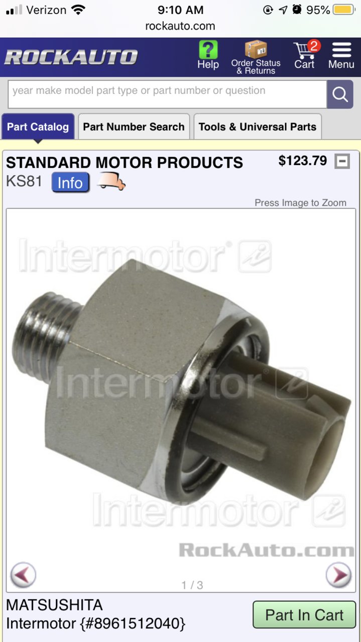

    I was looking at this one on rockauto. I’ve heard Matsushita is the OEM supplier for knock sensors? Thoughts?8D9FB15E-5C1D-4CEF-9015-A2FAC3883DF5.jpg

    If you're going to go for the knock sensor replacement, I would without a doubt use OEM sensors. That's a lot of work to risk on aftermarket sensors.
    This video will get you most of the way there. You would just have to take it one step further and get the intake manifold off to expose the sensors. There's also other things you can do while you have the engine torn apart like getting some refurbished injectors installed, or sending yours out to be refurbished. You could also do the valve cover gaskets if they've never been replaced. This would be the opportune time to also clean up your throttle body and IAC if you have one of the older throttle body models with a detachable IAC.

    @Tuke I did, replaced the both knock sensors and the wire harness. Ordered them on toyotapartsdeal.com The OEM ones sure do cost a lot but it’s definitely better to have a more reliable part in there especially if an aftermarket turned out to be a dud. That’d be a lot of labor to take all the intake off again. Make sure to replace the harness too. In all honesty I think my problem was just the wire harness that I got for like $30. The knock sensors cost me like $350 or something but I was having the valve cover gaskets, timing belt, Front cam and crank seals, water pump, plugs and wires, done and I really didn’t want that code to come back. The engine is all baselined now and runs perfect. Let me know if you need the part numbers. Good luck.

    Awesome dude.:cool: And good for you for going OEM on the sensors, if you let shop supply the sensors they likely would've gone with cheap crap aftermarket and
    It really is beneficial to stay with OEM or the OEM maker when it comes to most sensors on Toyotas.

    Yeah man, I couldn’t find if manufacturer of the knock sensors sold them without the toyota packaging so I just bit the bullet on them. Also went all oem with the timing belt kit from Aircabinman on ebay. Also went oem with the valve covers. Thing used to drip oil pretty good and not anymore from what I can tell.

    The aircabinman is known legit and I'll bet that those sensors made by Matsushita are OEM and if not that's okay, they make plenty of OEM sensors for other vehicles. Nice find. Also we know that Intermotor boxes up OEM parts and sells them under their own Intermotor name. So that's a good sign, plenty of signs that they can be OEM:cool::D

    Wish I’d know that about Intermotor parts before I bought those knock Sensors. I didn’t realize that company was legit.

    It looks like you got Matsushita sensors in boxes from Intermotor. If I'm reading that window you screenshotted correctly. I think you got the right ones.

    I considered getting those but some people had kind of steered me away from the Intermotor. I didn’t know if they were actually Matsushita. I guess it doesn’t matter now.

    Oh you got the OEM? that's even safer too. You're good to go.
