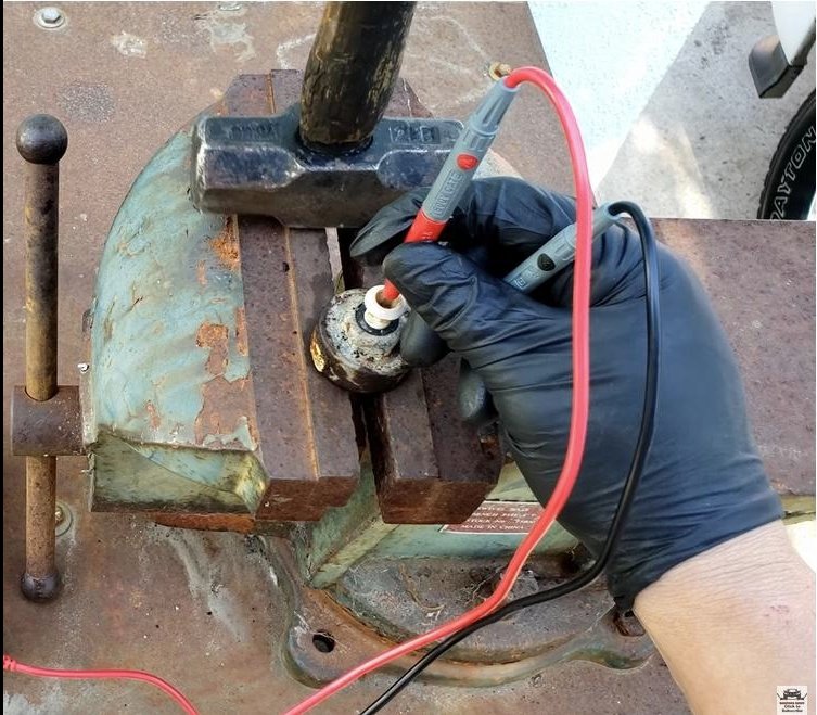

    Tested the new SMP Sensors by putting the sensors in a vice and dropping a hammer an inch or so onto the vice similar to the way this guy did it in this video: [https://youtu.be/cKTcXESPOJM?t=197]
    I got Mv signal back from each sensor, and they were both similar signals. I can't recall what they were but I want to say they were in the .1v range. Each sensor returned approximately the same result, my old knock sensors were NOT identical, so this indicated to me that my old KS's either were bad or at the very least not returning the correct signal. This is an assumption on my part.
    (Image above is approximately the setup I used when testing the KS's)
    I WONDER IF THIS DAMAGED THE SENSOR DOES ANYONE HAVE EXPERIENCE WITH THIS?

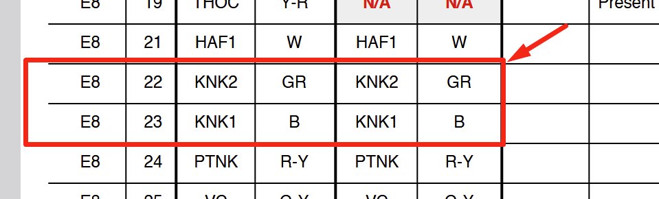

    This time I also followed the wire back to the ECU using the pin-out info from this website:https://people.well.com/user/mosk/images/Early_Tacoma_ECUs_v2.pdf
    Keeping in mind that the terminals are mirrored in the connector as the diagram is of the ECU pins, I did continuity from pins 22-23 to the 2 pins on the KS Pigtail connector ED1
    (Image taken from http://www.markofshame.com/fsm/03_Tacoma/Repair_Manual/03tacoma/di/eg5vzfe/cip03250.pdf)
    I got strong continuity between pin 23 and ED1 pin 1,
    I got strong continuity between pin 22 and ED1 pin 2.

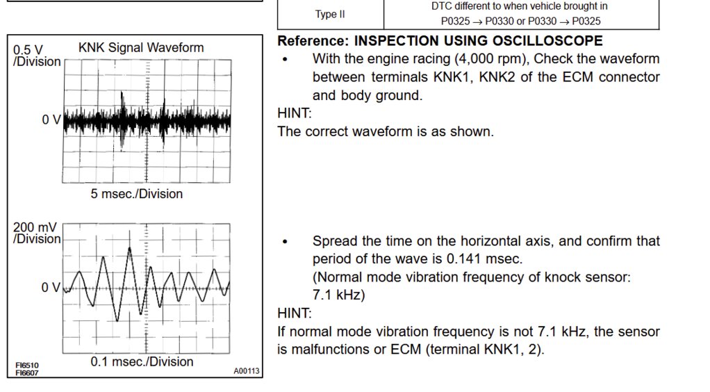

    Before I dump $300 into new OEM sensors, I'm going to use my friends Oscilloscope and follow the troubleshooting steps in the FSM HERE, and see if it gets me any good news.I can at least verify if the waveform coming back to the ECU is correct or not.

    Scoped the knock sensors.
    At 4k rpm, bank1 was putting out 8.3kHz (not 7.1 Spec)
    KS on bank 2 was putting out... actually nothing at all, just random noise.
    Going to order new OEM Denso ones and try again.
