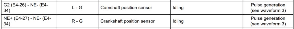

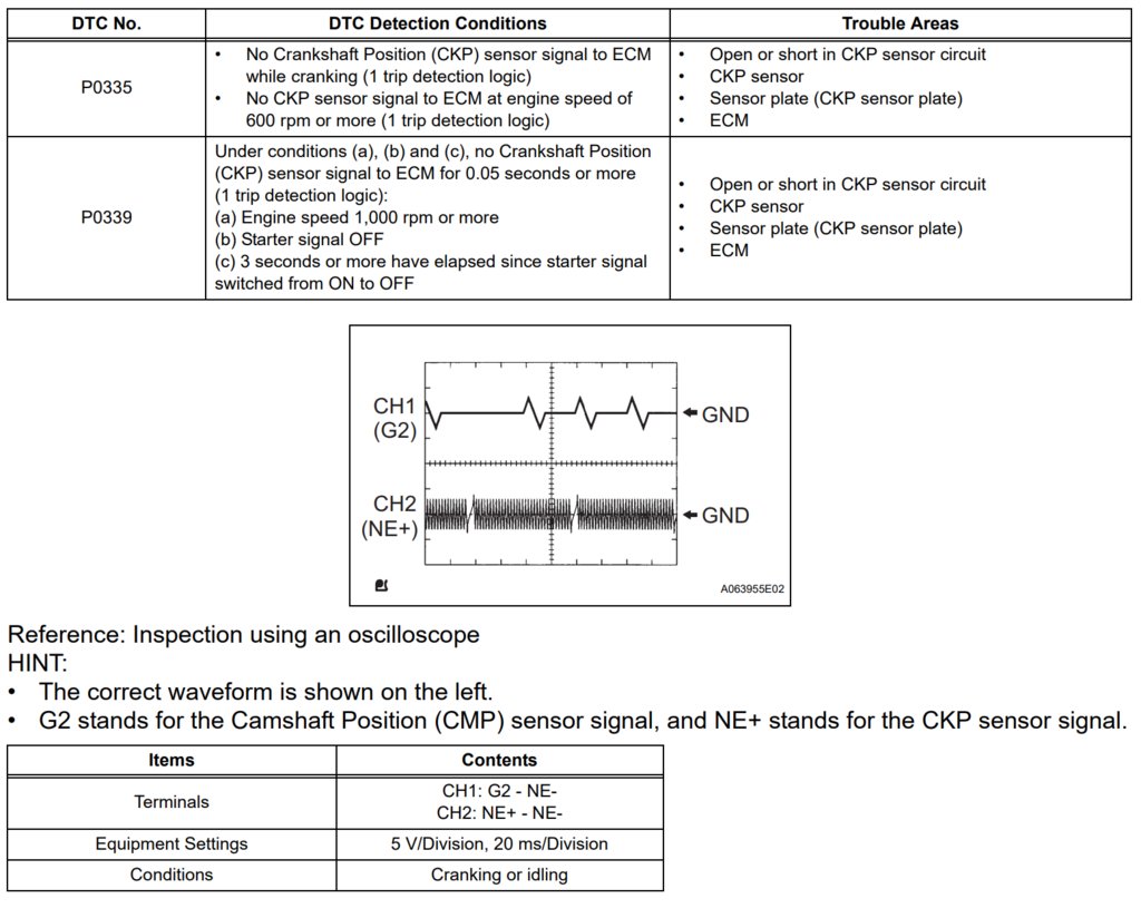

    Since you replace both the sensors, you are really going to need a scope to help figure this out.
    I suppose you could ohm check the wires to/from the ECM.
    Scope at the ECM terminals is the best method to diag this.

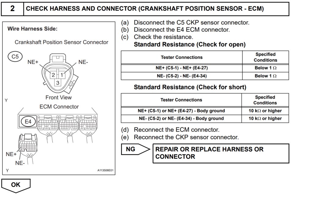

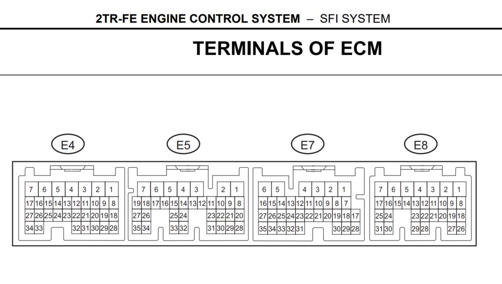

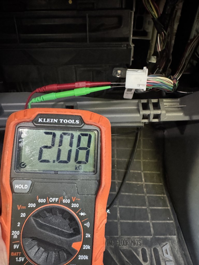

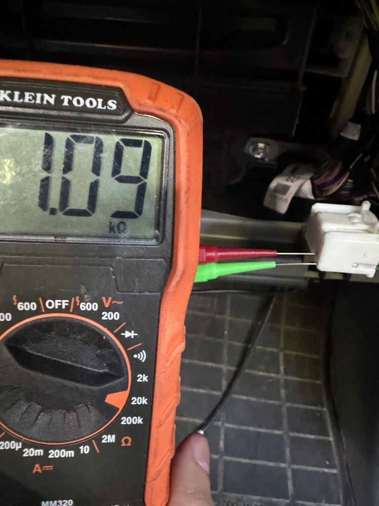

    @TnShooter Thank you very much for your very quick responce. I just got around to doing some diag and these are my findings so far.
    I probed right at the ECM connector. the first 2.08k reading is the resistance check to the crankshaft position sensor and it falls in the middle of the acceptable resistance readings.
    I also checked the camshaft position sensor aswell and got 1.09k. In addition I probed each wire to ground and got OL which is good. aswell as probed across both of the + wires since they share a common - between the 2 sensors and got the combined resistances which is to be expected.
    so far I can't find a problem with the sensors or the wiring.
