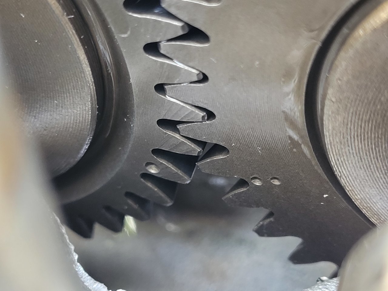

  3. Sep 13, 2022 at 8:09 AM
    Chucky5150
    Chucky5150 [OP] Member
    Aug 20, 2022
    #403977
    11
    This is how off the marks are.
    Going to take the cams off and reset them.
  4. Sep 13, 2022 at 10:09 AM
    Chucky5150
    Aug 20, 2022
    #403977
    11
    So after my panic attack this morning, it seems to be running fine.
    Started right up. No codes. It was a lot easier to fix than I had pictured in my head for some reason. I did end up losing a valve cover bolt in the process. No idea where it went and the fact that I'm doing this over grass doesn't help.
    It's currently cooling back down. At that time I'll flush the coolant system again and do the 2nd oil change.
    Hopefully after that it'll be good to go.
