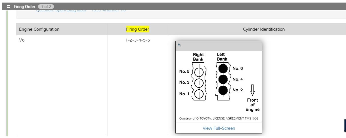

    Predator tube steps, Ranch Hand grill guard, Magnaflow CatBack exhaust, Toyota tool box & bed mat, 2LO Module by @Up2NoGood, Rearview Compass/Temp Mirror, Tune by @JustDSM.
    P0356 means the PCM is not receiving an ignition confirmation (IGF) signal from the #6 coil, this could be due to a faulty coil, broken/shorted wire, or bad driver in the PCM.
    The quickest and easiest test is to swap coils with an adjacent cylinder and see if the code moves to the cylinder you swapped with, if it does you have a bad coil, if it doesn't you will need to verify power and ground at the coil and wiring integrity to the PCM.
