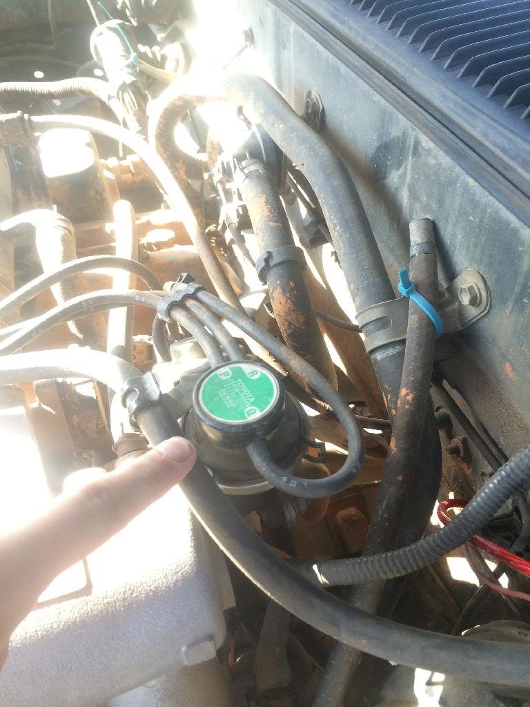

    Where can I get the filters for the EGR valve?

    That part is the MODULATOR. Try cleaning the filter first, if it looks gummed up. You could run without a filter for a bit, to see if makes the CEL go away.

    If the code is for excessive flow, I don't think a dirty filter would trip that code.
    You'd get a 401 (like I did) instead.
