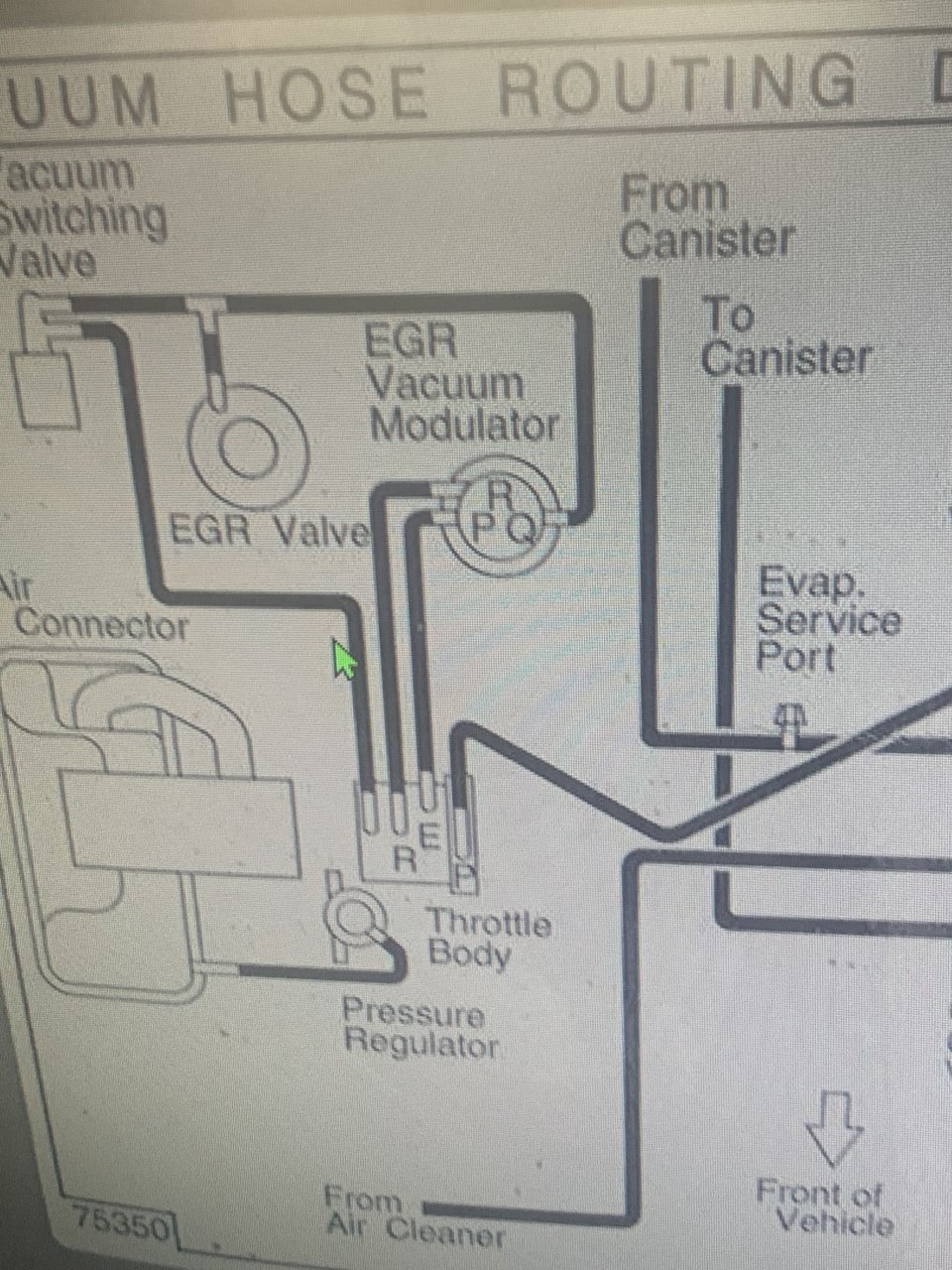

    Ok, yet another post about the CEL code P0402.
    I have a 2.7l 03 Taco. I have changed the egr, temp sensor, and the vsv. I have a small exhaust leak I am getting fixed in the morning, but that to me sounds like it would be a 401 issue.
    When the engine is cold, the motor sputters and cuts out. After it idles a while or it gets up to temp it stops. Any other suggestions?
    I’ve done a vacuum test on most of what I can understand.
    The one area I am unsure about is the one of three vacuum lines coming from the throttle to the vsv has no vacuum (when revved or not)? But the two that run to the modulator (P&R) do when revved.
    I think I typed all of that correctly.

    I would check the orifices in the throttle body, sounds like one or more of them is clogged. Make sure you can blow air through them.

    That’s the thing, I tried to push air into the unknown throttle vacuum line and it didn’t seem to build pressure.

    Is this back into the throttle body? I wouldn’t expect it to build pressure if it was clear

    Yes. R and E on the diagram below have vacuum when revved. The other unmarked port does not move the gauge when revved.

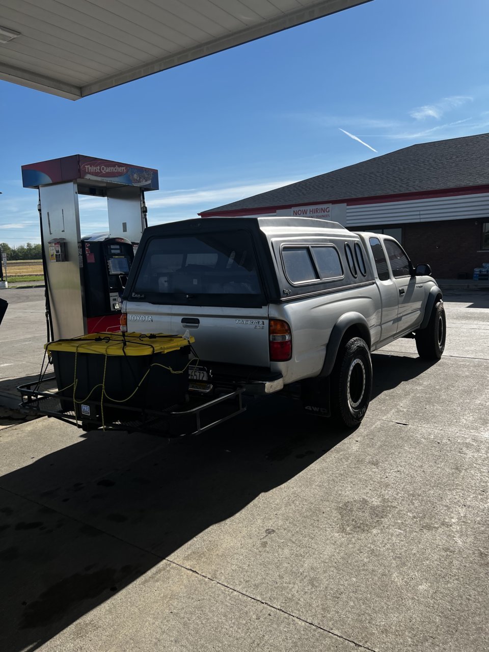

    Update:
    After resolving this issue I have moved across the US. Drove my little 2.7 fully loaded all the way from PA to ND (almost MT) which was about 30hrs after a little detour to MO. From there I have had multiple 2hr+ drives. And even another little trip down to MO. I have had zero issues. C7032E64-8520-42CA-9874-54384EBF2822.jpg
