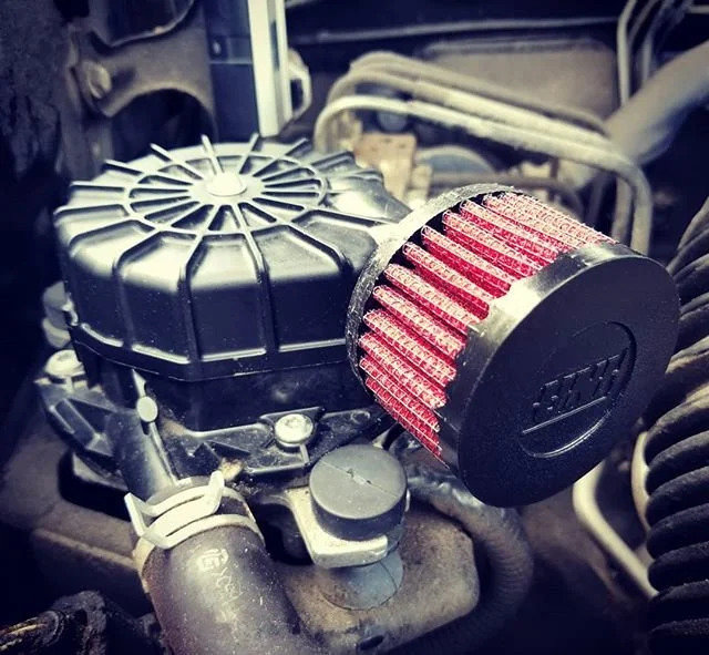

    Did you remove the pump lid to make sure the filter inside is in one piece and not broken and clogging it? Some people remove the internal filter and install this, insteadA7FB1C02-3F50-4D71-8FB8-4690E9F81C8E.jpg

    Yes. Replace filter with unifilter. No damage or deterioration on stock foam filter. Thank you

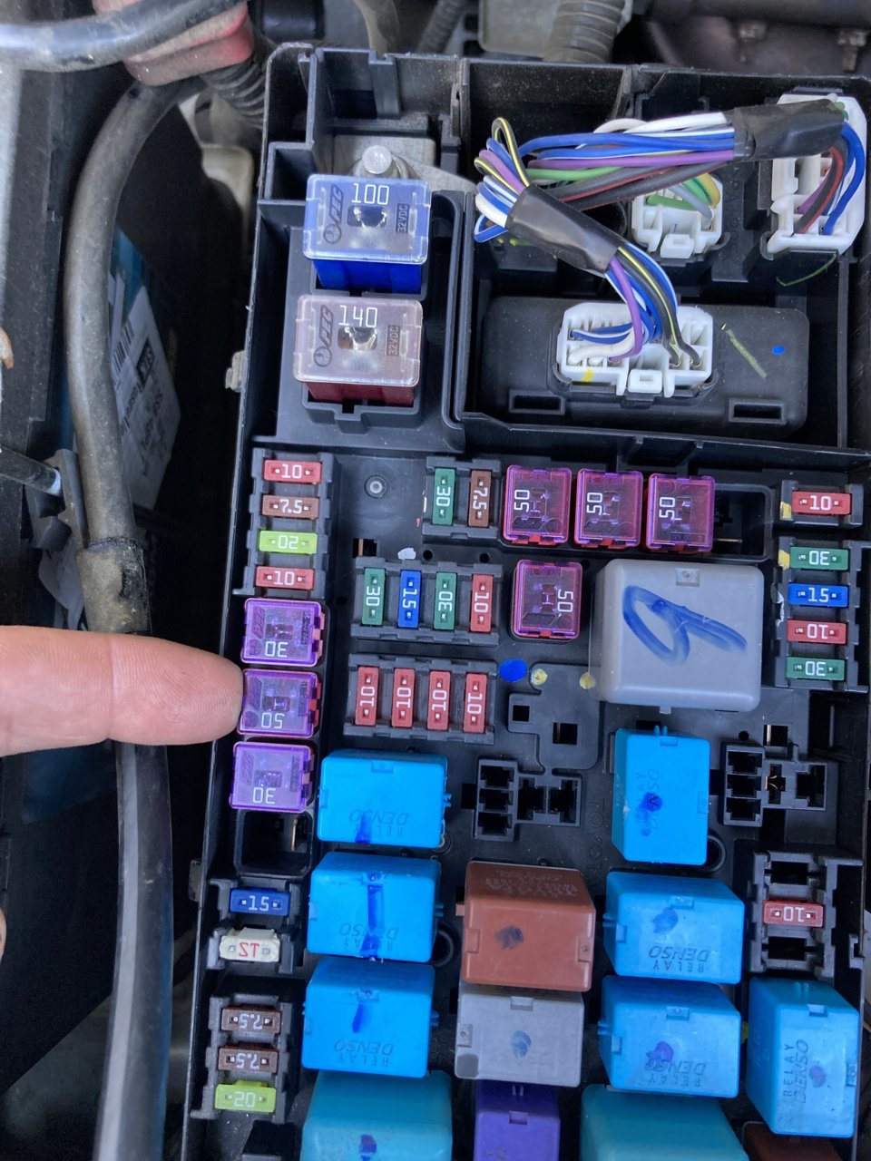

    One more thing I should have included. My 50 amp “Air Pump” fuse was missing which is strange because I have never touched that fuse and no one has worked on this truck but me. And, the code is recent. I replaced the fuse with the 50A spare.

  6. Jun 21, 2022 at 7:12 PM

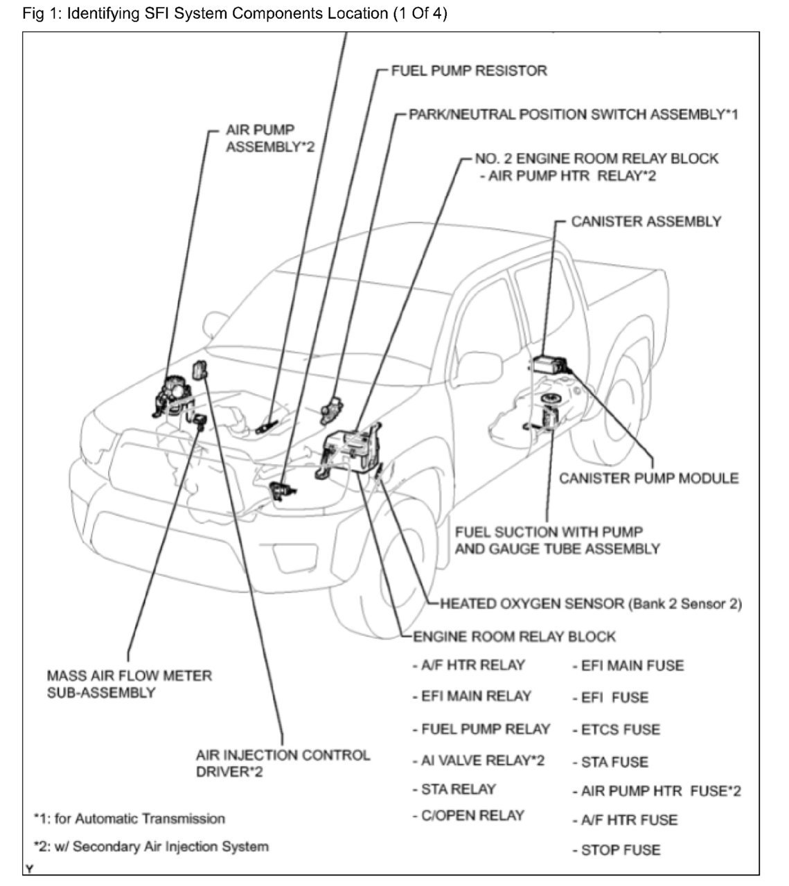

    Have you checked powers and grounds at the Air Injection Control Driver Module and inspected the wiring between the module and the pump?
    Toyota's flow charts suck but I attached the one for that code, best I can tell it can be a wiring issue, a faulty pump, or a faulty driver module.

    Problem solved. The 50A fuse was missing. I don’t know how that happened as I never too it out. Only work done on my truck by mechanics was new tires. It remains a mystery. Thanks for all the great advice. Love the uni-filter.
