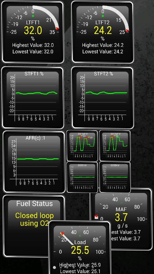

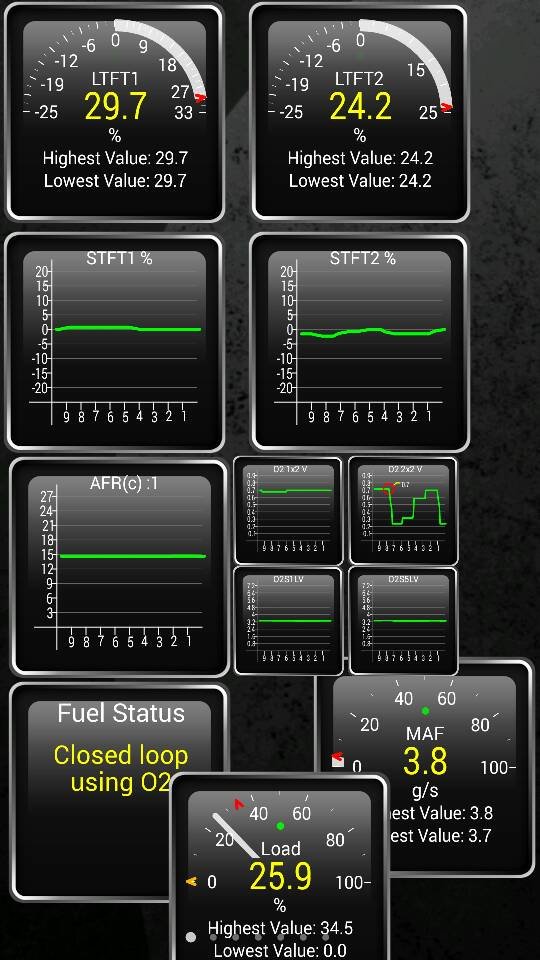

    Check out the Torque app(android) you can check almost everything with it and a simple Bluetooth OBD reader.
    Example from my truck when I was having the problem.

    That's the same I'm running. My short term and upstream sensor ain't reading. On other vehicles it does read.

    That sounds like a problem that could cause your issue..
