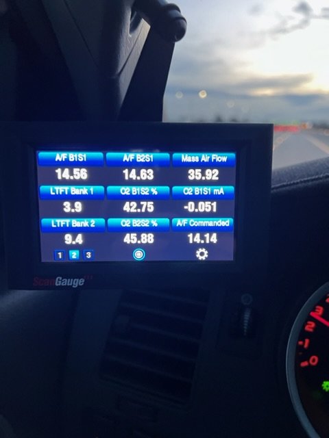

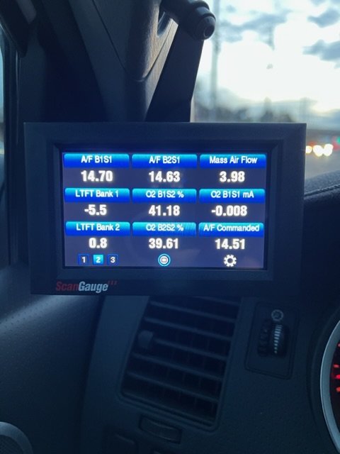

    So here’s some numbers I’m getting from my scan gauge three
    The first photo is going 65 miles an hour at 2500 RPMs locked up in fourth gear
    The second photo is me sitting at a light in drive.

    Never seen o2 reported as a percentage. Guessing 45% is same as .45 volts, but don’t know. A properly running system should have bxs2 as .45 volts at most times other than heavy acceleration. Failing cats will show lower numbers. System checks all the time, so need longer term observation of s2 readings to determine cat health. LT FT is a bit high in cruise. Could be a slight vacuum leak, but would expect to see it also at idle and didn’t.
    possibility that the system gets upset occasionally and goes too rich due to an intermittent sensor issue. Cat can’t handle it due to age and reads low. Ecu catches it and throws 420/430 codes.
