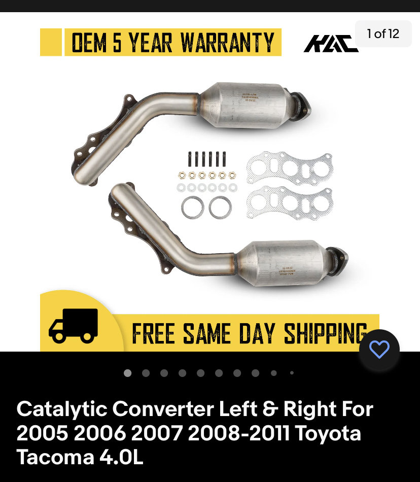

    Use an anti fouler on both sides for the sensor.
    I’m either gonna buy a used set
    use a anti fouler on both sides and gut the cats
    or buy these and hope they don’t check which usually they don’t
