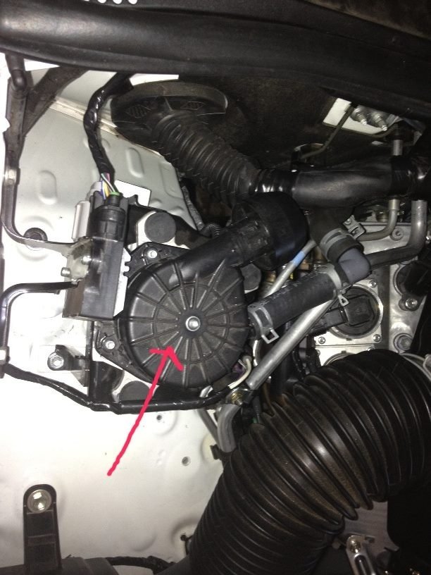

    There are a couple threads on here that talk about it. I'm not a mechanic by any means, so I just followed their advice. To fix my 0456 code, I had to clean out the secondary air pump. The factory filter is a crappy little piece of foam that eventually starts flaking apart and interfering with stuff that's way above my knowledge level. I just cleaned it out a bit, but eventually I'll need to buy one of these: https://www.summitracing.com/parts/...LxgZrc3vkxcKqibjSAZ6tmzwQA_JJ9oBoCr8UQAvD_BwE so it doesn't throw the code again. It may not be the cause of the codes for you, but it worked for me.
  10. Dec 1, 2020 at 9:21 PM
    757.Taco
    757.Taco Well-Known Member
    Apr 30, 2019
    #291809
    80
    Nick
    Weatherford, Texas
    2009 4x4 Manual RC
    Here's a random internet photo to show you what I'm talking about. The filter is in there.

    I'm relatively sure my 09 doesn't have that system? I could be wrong but I think my crankcase breather hose routes air straight into the main engine air filter?

    I have an 09 4cyl. Like I said, I'm not a mechanic. I just followed the instructions from a couple of the threads on here and the code hasn't been back in the past year or so since I did it.

    I am pretty sure you 4.0L guys have the secondary air pump too though
  14. Dec 2, 2020 at 7:30 AM
    BassAckwards
    BassAckwards Well-Known Member
    May 3, 2016
    #186002
    27,954
    2009 Tacoma AWD Turbo 2TR-FE
    Full-time AWD & BorgWarner EFR 6258
    Secondary air pump started on the v6 trucks in 2012. 05-15 4 bangers all had them
    TnShooter and 757.Taco like this.
  15. Dec 2, 2020 at 7:55 AM
    757.Taco
    Apr 30, 2019
    #291809
    80
    Nick
    Weatherford, Texas
    2009 4x4 Manual RC
    Gotcha, thanks for the correction. Disregard my advice OP :thumbsup:
