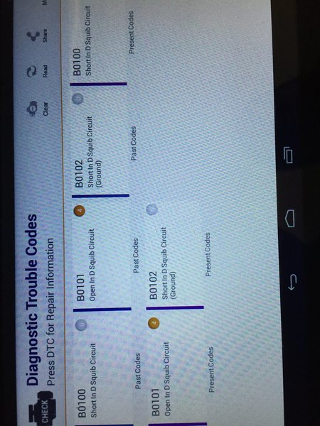

    I have read online that of its my spiral cable my horn and cruise will not work.

    Your scanner has to be misreading. B codes are for Body. Though our trucks do not have central body electronics or a CANBUS architecture that would have a control module to generate these codes. It just is not possible.

    Looking at these, they could be SRS codes. Squib faults usually refer to the charges inside the airbag deployment units. Did anything involving those take palce?
    Its just unusual, i didnt think the SRS codes for Tacomas were standardized to the B group going back to when our cars were produced.

    Nope nothing happened to bags. I may have to pull the drivers bag and inspect further. I have googled the b codes and it's correct for Toyota air bags

    If you want to have some fun, put 12v to the leads for the airbag. :D
    Though seriously, im surprised that our trucks are generating B codes. You might want to go through the FSM wiring diagrams and check continuity on the harnesses that correspond to the driver airbags. From the SRS modules to the bag connectors. Be careful not to contact the airbag plugs to anything.
    If it was cruise control related, it would still be in the P code group. P05xx are speed and idle control faults. P04xx are secondary emissions faults.
    Learned something new today.

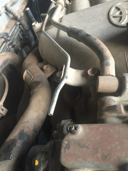

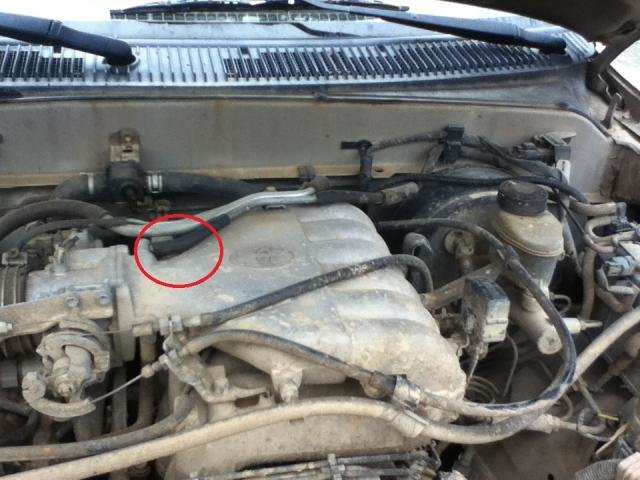

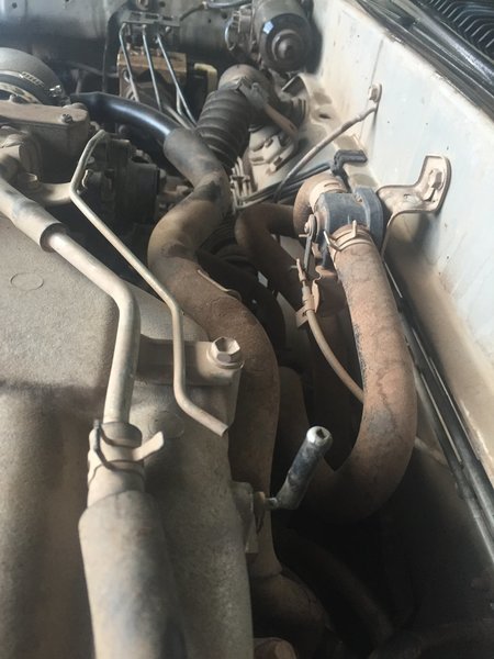

    I noticed I have a vacume line gone. It goes from the driver side of intake to throttle body. I looked at my 98 and noticed it plugs into throttle body. But my 03 doesn't have that. It has a little hose coming off of back of intake with screw in it

    those empty lines i think are supposed to be for your charcoal canister, ported vacuum switches, and such. If not your IAC valve...............
