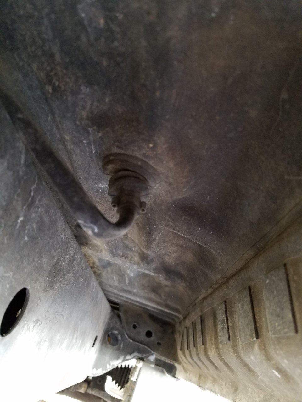

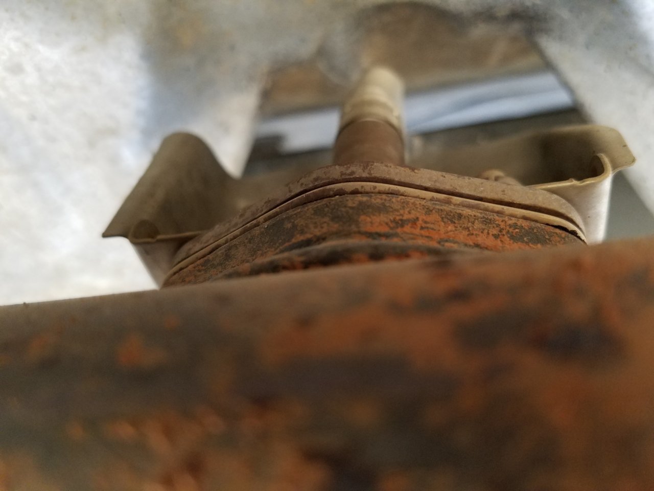

    I have been getting a P0420 CEL code for a long time now, close to a year if not a little longer. I have read a lot of different things that it could be exhaust leak, cat converter, 02 sensors etc... So I am trying to change to downstream 02 sensor first. I believe I have located it but the wiring goes up into the cab it looks like so I am not sure how I unplug it and re-plug in the new one, or am I not finding the right sensor maybe. I don't want to have to tear the floor of the passenger side out just to unplug the 02 sensor, has anyone changed their downstream 02 sensor before? My truck is a 2001 3.4L V6 Manual.
    First pic attached is the upstream sensor, next 3 are what I believe to be the downstream sensor.

    Its been a while since doing this but I believe the connector is either under your passenger seat or on top of the truck frame, between frame and body.

    yeah the rear O2 sensor harness goes up into the cab and under the passenger seat...kind of a pain to get to but not terrible. Think I replaced mine in about 45 min and that was taking my time. The trickiest part was that little metal plate that bolts under the sensor to protect it from rocks/debris...I just cut it off with an angle grinder lol

    Thanks for all your help guys, I just got my denso 02 sensors both upstream and downstream so now I just have to figure out how to get this damn heat shield covering the downstream 02 sensor off. I don't have a Dremel or angle grinder or anything to cut it with, it seems like there has to be a way to remove it without cutting, why would Toyota make it so the only way to replace the sensor is by cutting the heat shield? Seems like they didn't exactly think this one through lol.

    Yeah I had trouble with this as well, the heat shield only comes off if you remove the two bolts above it that hold both it and the sensor in place. Those bolts are hard to get to with normal tools above the heat shield.
    The video I watched on Youtube, the guy used his angle grinder and just cut it off. I used my angle grinder to cut it 3/4 of the way off so I could bend it downward and access the bolts. Then I was able to put it back in place by bending it back upward when I was done. It has a cut through it but it still serves it's purpose and will be easier to remove in the future.
    I would get an angle grinder if you can, or you could probably do it with a Dremel and a cutting wheel. It's pretty thin material.

    I think there are 2 12mm nuts holding the heat shield and oxygen sensor. I just loosen the bolts holding the rear exhaust pipe to the cat and pushed the pipe back a little bit enough to have access to the nuts holding the heat shield and oxygen sensor.
