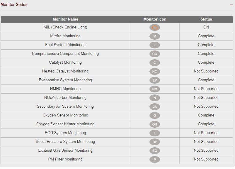

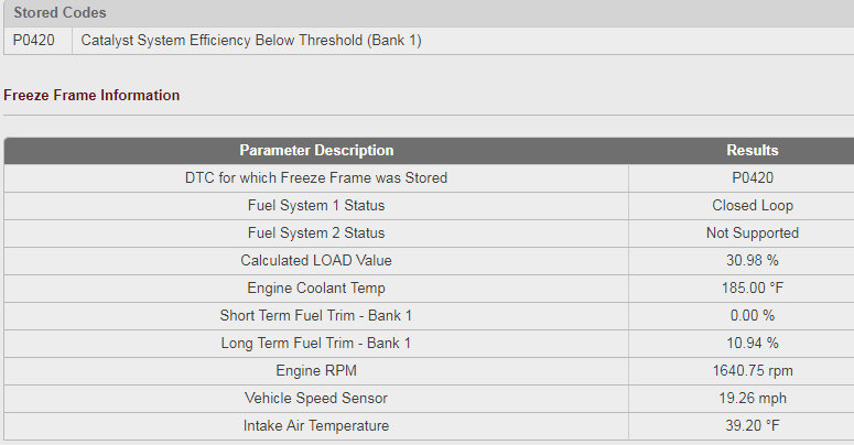

    In addition My OBDII reader which is an INNOVA model# 3100 f device - which uses a site called "repairsolutions.com" has given me these stats:
    If I bring the truck into a mechanic to get diagnosed should I have them focus on something in particular that they might overlook? Just want to rule things out. I really hope its just the upper cat.
