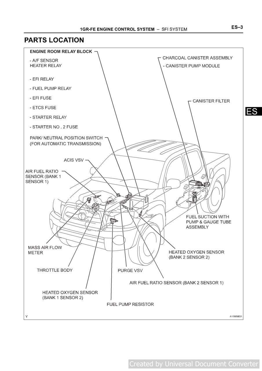

    Well the dented sensor can't have anything to do with the P0420, P0420 is for the bank 1 cat which is the passenger side.

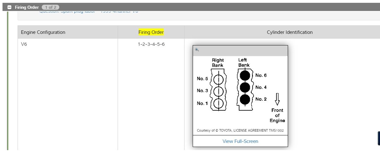

    A V type engine has 2 banks of cylinders, on modern engines they controlled and monitored separately.
    Bank 1 is the bank with the number 1 cyl and bank 2 is the opposite side, on the 4.0L bank 1 is passenger side and bank 2 is driver's side.
    You say you have a code (P0420) for the bank 1 (passenger side) catalytic converter but the sensor you say is damaged is on bank 2 (driver's side), therefore it can't be related to the converter code.
    If it was setting a P0430 or a bank 2 O2 sensor code then that sensor could be a problem.

    But theres only 2 banks right, bank 1 or bank 2 ?
    Bank will be for all drivers side clylinders and bank 2 for all passenger side cylinders??
  13. Mar 18, 2023 at 9:37 AM
    Dm93
    Dm93 Test Don't Guess
    Mar 3, 2015
    #150066
    13,033
    Texas
    2014 DC OR 6spd 4x4
    Predator tube steps, Ranch Hand grill guard, Magnaflow CatBack exhaust, Toyota tool box & bed mat, 2LO Module by @Up2NoGood, Rearview Compass/Temp Mirror, Tune by @JustDSM.
    Correct, each bank has 2 catalytic converters (only the upstream converters are monitored), 1 AFR Sensor (upstream) (Bank 1 Sensor 1 & Bank 2 Sensor 1), and 1 O2 Sensor (downstream) (Bank 1 Sensor 2 & Bank 2 Sensor 2).
    Each component except the downstream converters is monitored and can generate different codes.
    Your code is P0420 which is for the Bank 1 (passenger) upstream converter.
