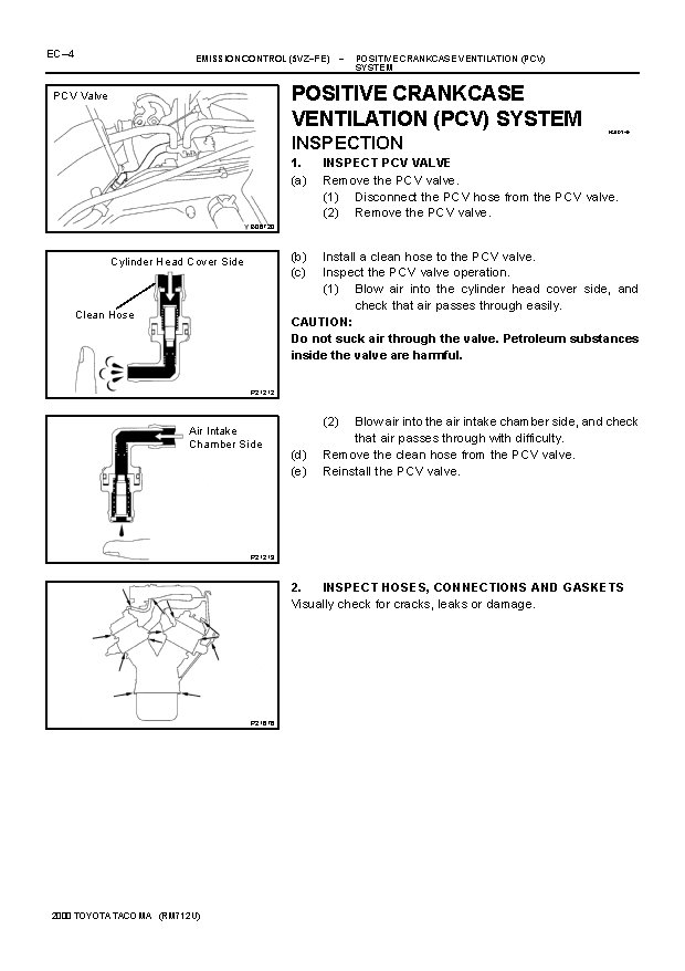

    Might be worth a shot to make sure your PCV valve functions properly (also extremely easy to replace and check).
    This illustration is also for the 5VZ-FE (The 3RZ-FE is even easier to get to the PCV valve on, easy to find info on too)

    Most of the time its what Speedy here said. I had a p1135 which is the direct code for the pre-cat o2 sensor. But, I have spoken with multiple mechanics and people that have fixed this code and most of the time its a bad o2 sensor. But start with the PCV valve first. Cheap and simple to replace.
